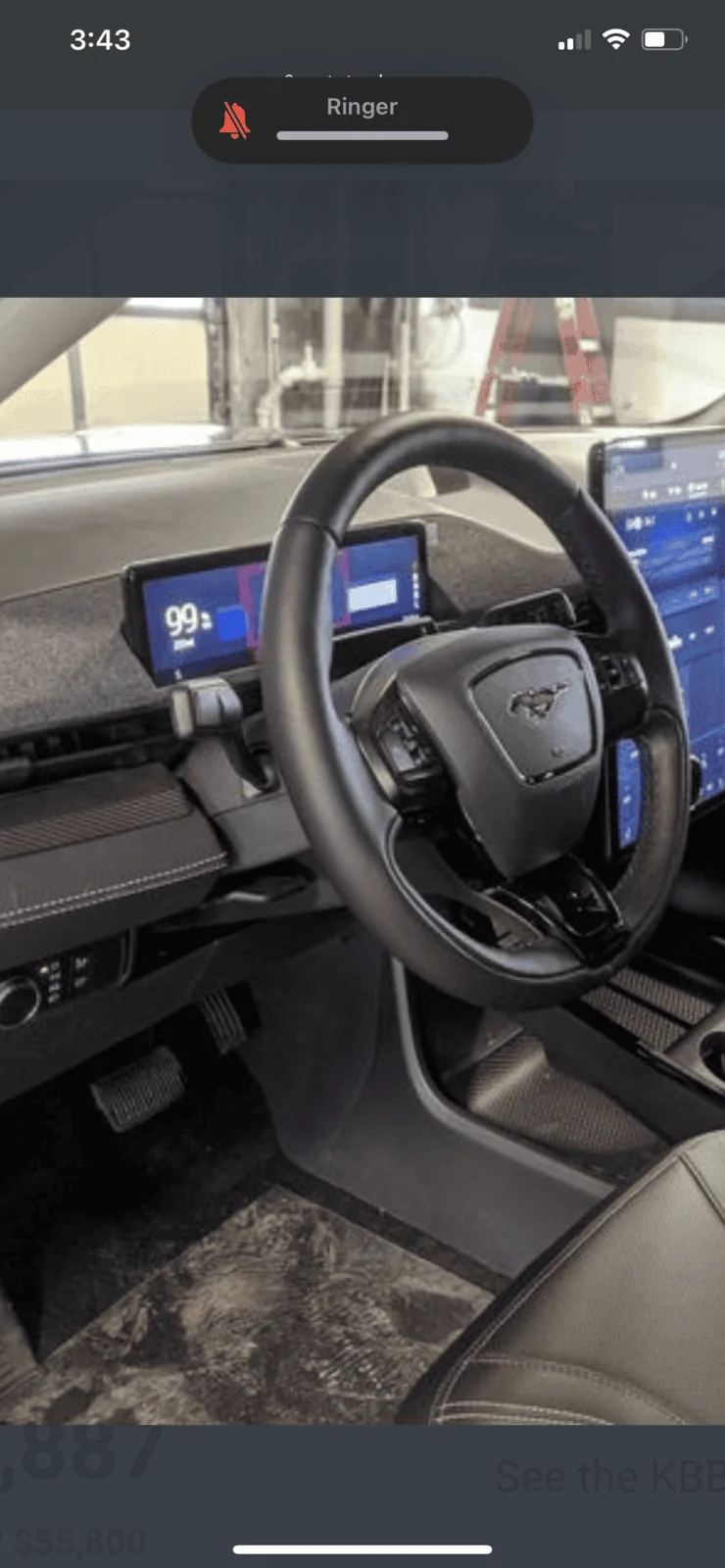

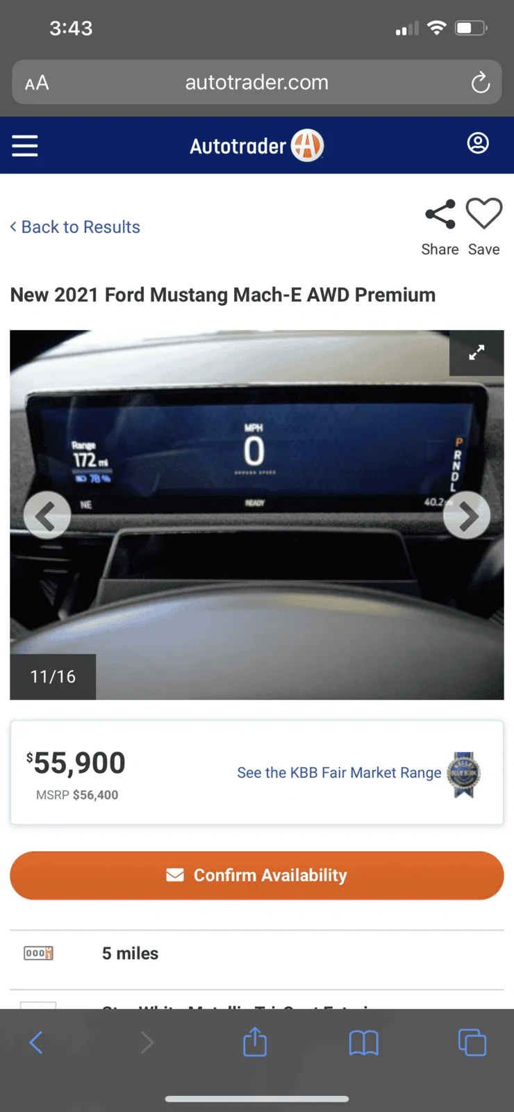

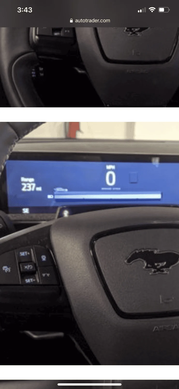

I was on Autotrader scoping out the Mach-E, and I noticed something peculiar, the quoted range figures are way off what the vehicles are displaying. Notice some of the screen grabs. Mustangs with 88-99% charge having a stated range of less than 200 miles. These are the Premium trim ones with the “large” battery packs as well. The Sellers list the manufacturer range as 270. I understand the Mustang’s computer will adjust the miles available depending on driving style, but that shouldn’t account for 40-50% fewer miles than advertised. Plus it’s multiple vehicles in multiple states. I’d hate to have ordered one of these and discover you only get 170 miles between charges! Yikes...

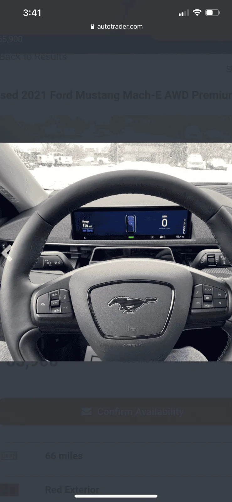

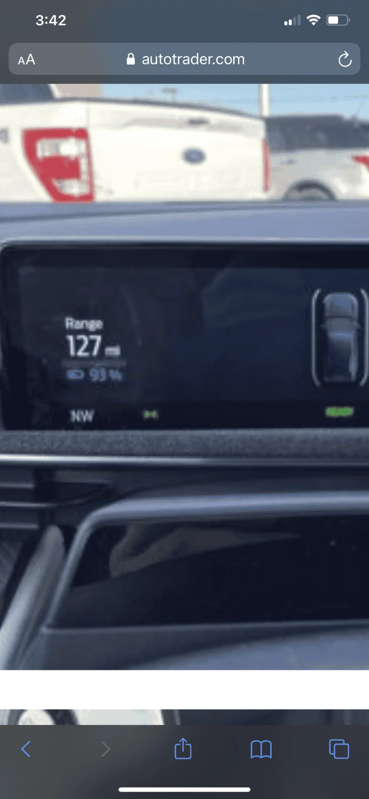

Also noticed the pic with the 114 mile range with 75% battery was in a snow filled lot. Even Tesla drivers have to adjust for cold weather. Would like to see what the temp was on the 127 mile range with 93% battery tho.
And if the sellers thought they could make money reselling a new MachE with those stats on the dashboard, an expensive lesson might be in their future.

Range is based on how the last driver drove.
This is true of ICE vehicles, too.
It has little to do with the condition of the battery, generally.
I had a great example of this with my ICE (hybrid) pickup truck today.
My range meter usually reports about 450 miles for a full tank at an average mileage of around 18MPG.
I towed a travel trailer for about 90 miles yesterday, and arrived at my destination with an almost empty gas tank. Mileage was about 10MPG with about 25 gallons usable, so MPG meter would have read about 250 miles with a full gas tank.
When I unhitched the trailer, my real-life MPG immediately returned to normal -- but the backward-looking statistics on my dashboard took about 100 miles to catch up (even though I thought I reset the meter).
That's just what happens when you use moving averages to predict the future.
The same thing happens to EVs. The fundamental math is the same, even though the units are different.
If the Mach-E's last driver took it to the track, it's going to report a shorter range than if its last driver treated it like a Prius. 🤷‍♂️
I’ve seen some quote up to 20% loss due to cold, this is more like 50%. Yikes! Glad I reserved the Tri-Motor if this is normal in winter conditions.

I’ve found on my Model 3 in subzero temps to get roughly 40% worse efficiency at the worst. Typically I’ll see 20% on anything 20°F and above. Obviously there are a lot of factors too. You mash the pedal (easy to do in a Tesla), your efficiency reduces. I often run my temp between 68 and 70, and rely more on the seat heater unless the little one is in the car. Using shore power to pre-heat the car before leaving helps, but also raises your electricity bill fiercely.
If you’re worried about getting 300 miles on a good day for a trip, Tri-Motor is where you’ll want to look. I don’t tow yet, but I have made trips 150 miles one way, and just used a 20 amp outlet to trickle charge until I need to leave. If that’s not available, I hit a supercharger. Ideal temp is 70 and above, so for us northern folks..expect reduction in range.
