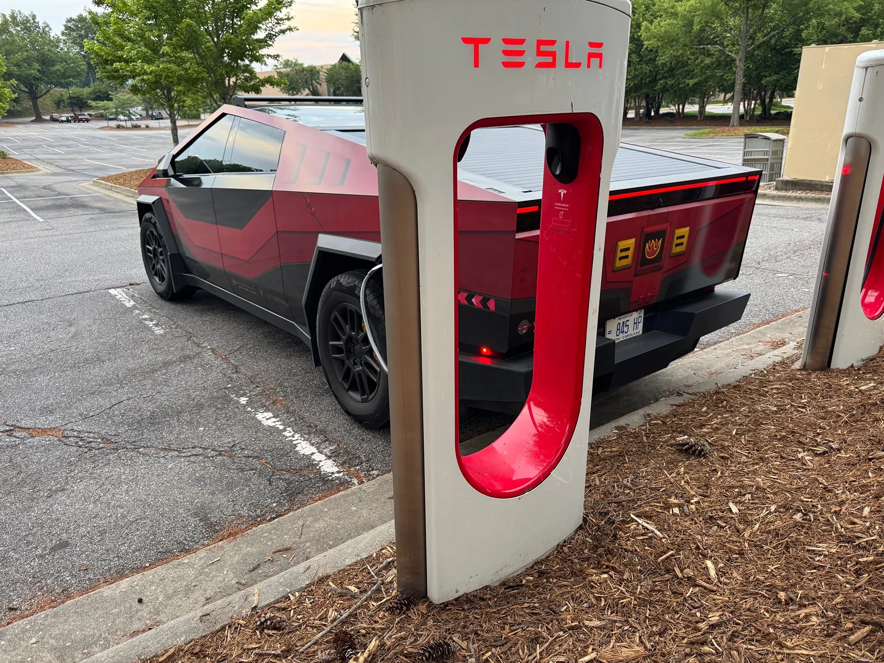

Tesla Cybertruck My turn - PCS failure. How long will this take to get fixed? IMG_6364
I’m at day 16 of waiting for parts. No ETA as of this morning.
I don’t care if it’s free, I still hate driving 30 minutes out of my way to a supercharger to sit and do nothing for over an hour and then 30 minutes back.
