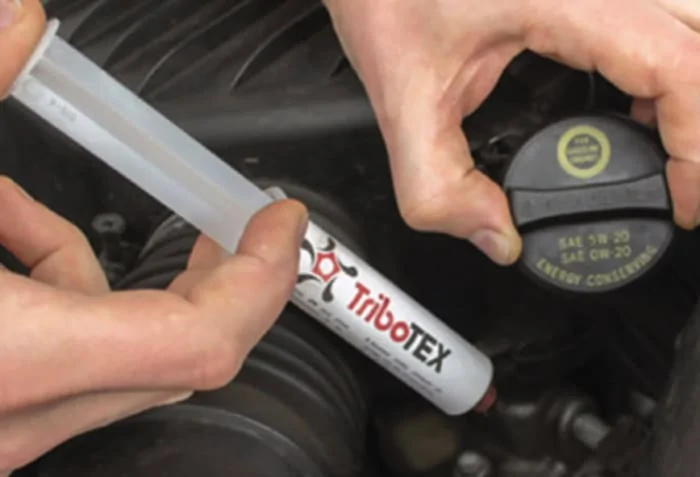

TriboTEX’s product can be added by the consumer directly to a warmed-up engine. From there, it begins to repair damage over time.
Today, more than 30,000 cars and trucks are using TriboTEX. That usage data is expanding the body of evidence that synthetic nanoparticles yield the intended results. The most common benefits drivers report are improved gas mileage, increased torque, and increased oil pressure.
In cars with 130,000 miles or more, the company claims that fuel economy can be improved up to 6 percent along with increased in-cylinder compression. The particles also decrease engine noise by filling in gaps and grooves as small as 40 microns — about the width of a human hair — although they also stop building up once the gap is filled. Cars can also increase their engine power up to 3 percent, said Rudenko, noting that this is remarkable for a treatment that circumvents the cost of dismantling any part of the engine. Adding TriboTEX to a vehicle every 40,000 miles will ensure that there are enough nanoparticles available to fix new instances of wear in parts of the engine that experience significant friction.
As consumers have used TriboTEX, they’ve suggested other potential applications and the company now offers a small-engine product for use in motorcycles, lawn mowers, generators, and compact cars. A high-performance version is formulated to work in diesel trucks and large-engine sports cars. The “big rig” formula treats semi-tractor trailer engines. A national commercial trucking company is testing TriboTEX in a number of trucks in its fleet. Rudenko is also working on using nanomaterials in aviation gearboxes.

So many questions. If I take talcum powder and spray beeswax on a thin layer of it do I have sticky sided / slippery sided ceremic nano particles and and would it fill scratches in metal?
I am not saying this is a scam... I don't know enough. If it is a real product that does what it claims why not patent the process or the formula? The MSDS has all ingredients listed as proprietary, including the fragrance, why is there fragrance in a engine oil additive? Is it because they are using fragranced talc powder a.k.a. baby powder?
What is diamond like hardness? Diamond has a mohs hardness of 10. Does this product harden to a mohs 10?
Increases oil pressure... yeah it's a feature, not a bug. There are 2 ways to increase oil pressure. Increase pump efficiency which is the implied feature, or clog the flow channels.... which do I think is happening?
From their published study in a magazine called tribology international the ingredient is magnesium silicate hydroxide... aka talc.
https://www.sciencedirect.com/science/article/abs/pii/S0301679X17300531
