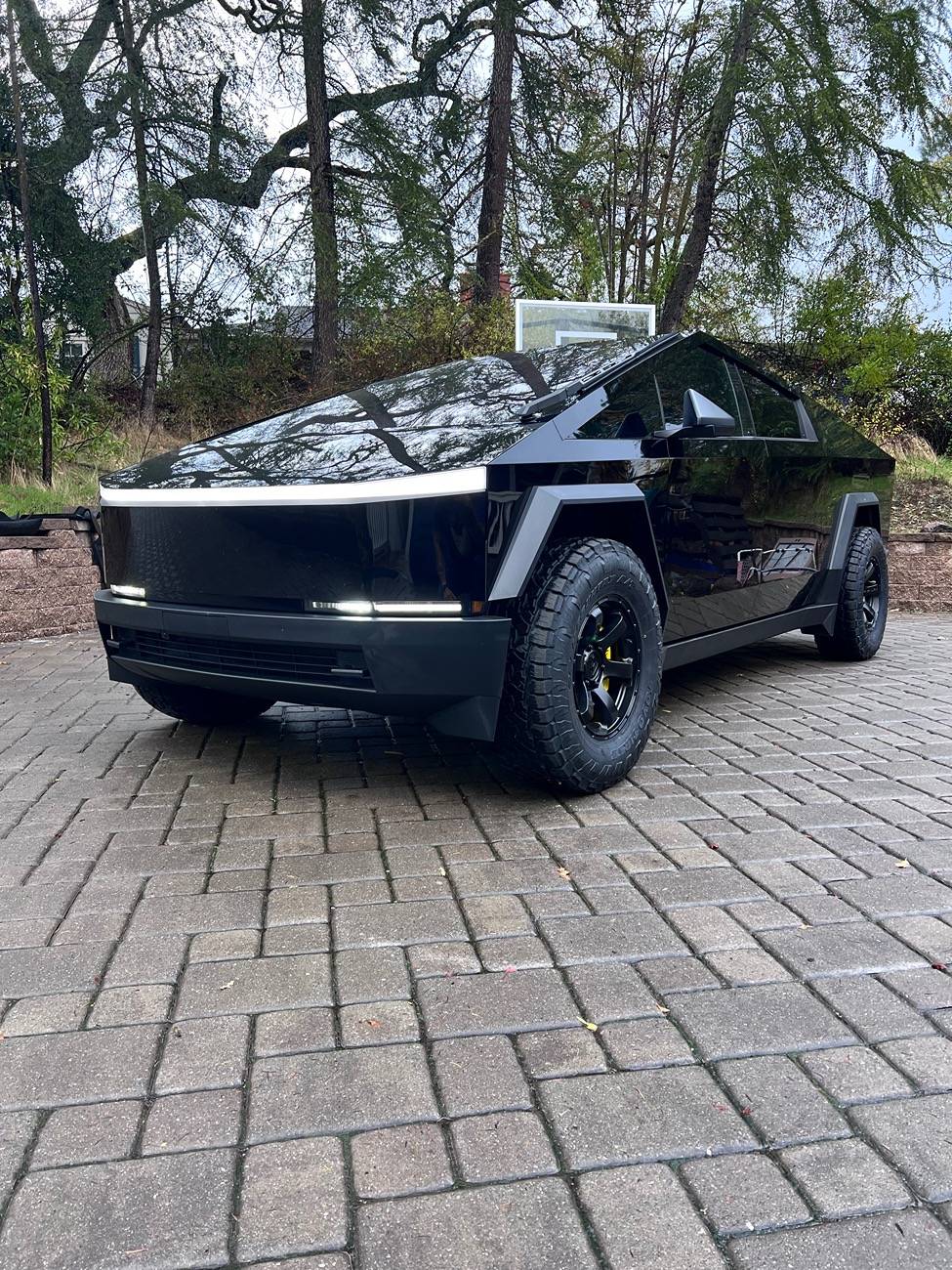

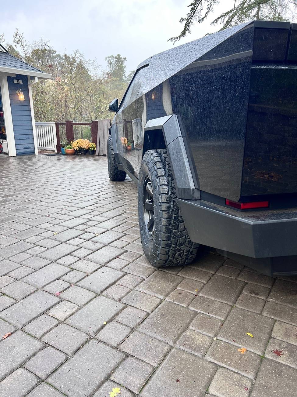

Ended up with Fuel Rush 18x9 +20mm offset, with Toyo Open Country AT3 35x12.5”. Ever so slight rub at full lock at the front and back ONLY when the truck is in ENTRY low. I got that to go away with a little heat gun.
