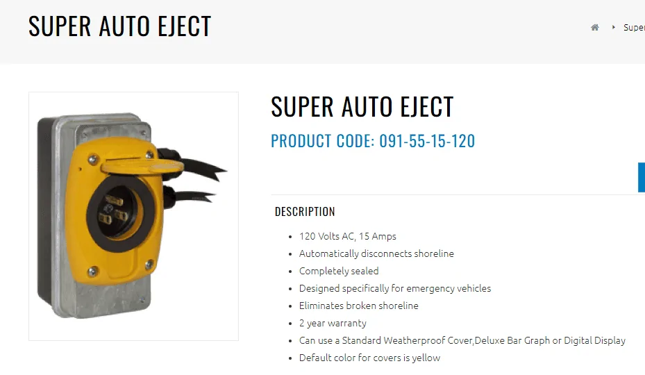

I like this suggestion, with emergency vehicles like fire trucks, ambulances etc, devices like the Kussmaul Auto Ejects are used. While the vehicles are not being used they are plugged in to maintain the batteries, but once the ignition is turned on the solenoid pops out the extension cord so the vehicle can drive away. Something like this could be incorporated into EV charging to save precious seconds during a medical emergency, house fire or other event where you don't have time to unplug before driving away.
