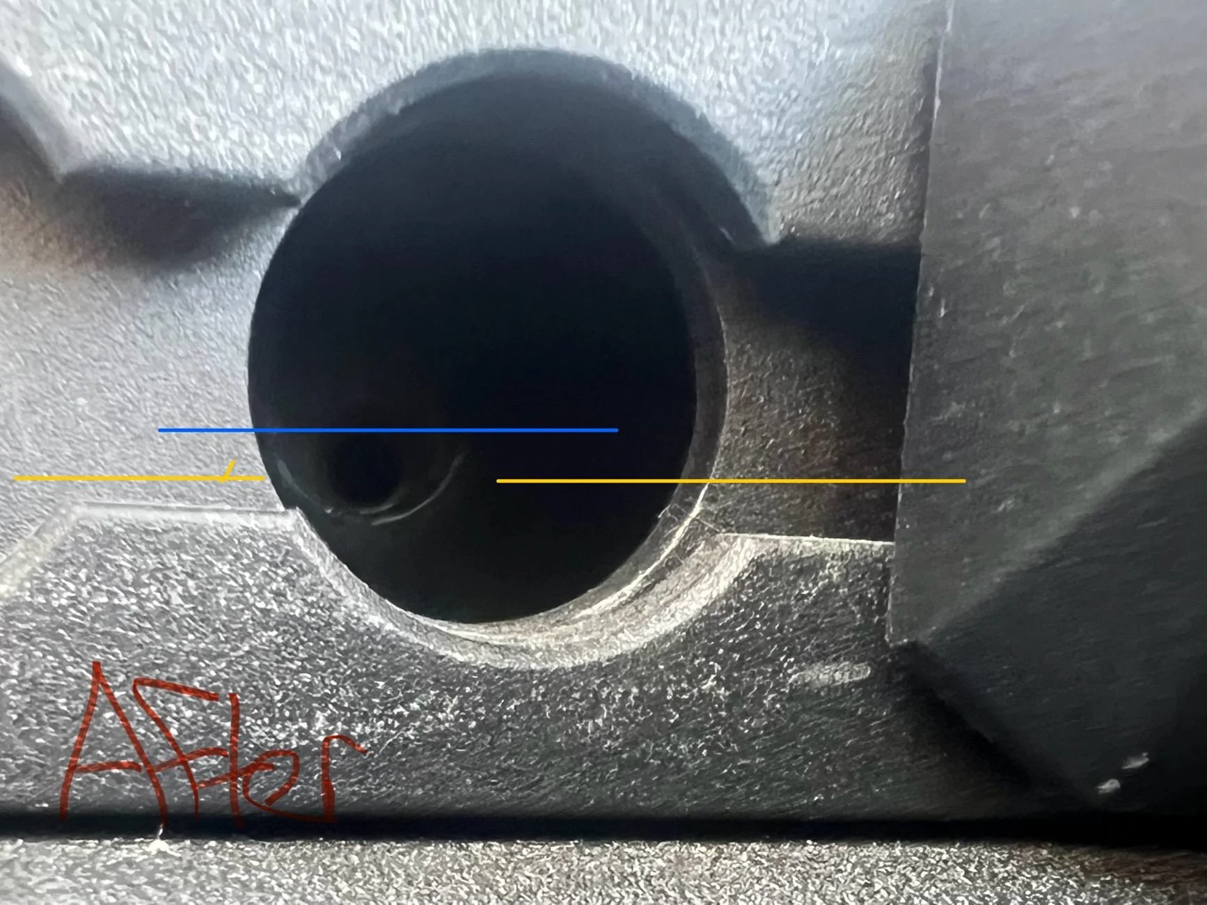

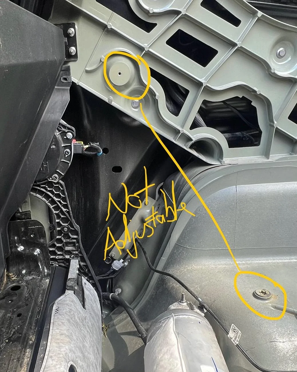

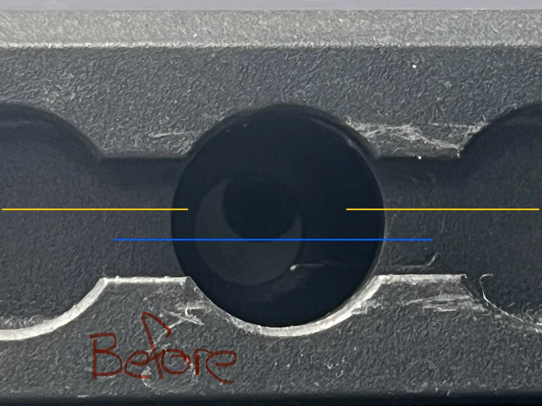

Found a workaround (or maybe the reason) the divider doesn't fit. Had two thoughts - either the bed was two high or the rails were too low. Ended up being the rails for me.
Bed too high: checked this first. All the bolts were seated properly. It did seem possible for them to be caught up on a lip, so I'd still recommend checking this, but it wasn't the issue in my case. These mostly sit and bolt directly into the casting, so there really wasn't any reasonable adjustment I could find. I assumed the casting dimensions were good (as in all the mounting locations were in-plane), and the spacers where included were appropriate, but didn't check. It was amusing finding the hand cut holes in the casting for the suspension and other components. VIN is early 6000s. By hand cut, I mean with a saw-zall type tool.
Rails too low: this ended up solving my problem. There are 6 bolts of interest on each side (4 in the rail, 2 on the side tie down points) that fix the rails in place. Losing these bolts allowed enough play to position the rails at the perfect height for the divider. Once the rails were loose, I installed the bed divider, applied some additional upward pressure on the divider, then tightened the bolts. I did the front and back most bolts first, installing the divider at each location before tightening that location so as to make sure it is level the entire length. In the pictures, the yellow is the casting hole and the blue is the center of the rail hole.
This was pretty quick and easy (<30 minutes). I'm surprised some SC's are blaming this on the dividers.
Before:
Tesla Cybertruck New Cargo Divider Fitment Issues IMG_1793
After:
Tesla Cybertruck New Cargo Divider Fitment Issues IMG_1795
Casting mounting points:
Tesla Cybertruck New Cargo Divider Fitment Issues IMG_1788
