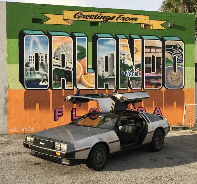

The DeLorean was made with Type 304 Stainless Steel, and the (albeit thinner) panels were stamped. Although even on the thinner thicknesses than the CT, British Steel had problems with the early "gas flap" hoods cracking around the fuel door during stamping. They wasted a number of hoods this way. They eventually removed the fuel door, and then the grooves, ending up with a flat hood in the final version.
Heres a picture of the hood with both the fuel door and the grooves on my early car:
Finally, "Type 30X " at the reveal of the CT seemed to be more exotic than a "good general all-purpose stainless grade" in the above description.
Don't get me wrong, a Stainless Steel vehicle is still cool, but the type was billed/suggested to be a rocket grade exotic alloy. The DeLorean is susceptible to dents.
