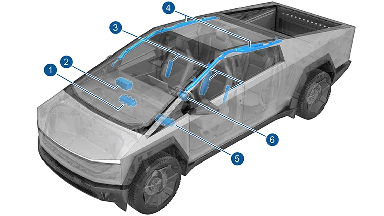

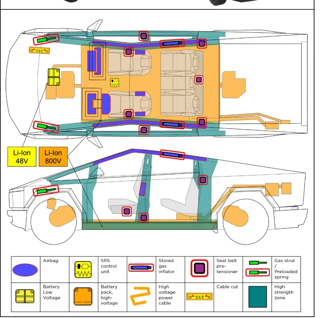

I wasn't aware that there was an airbag on BOTH sides of the driver's seat.
Guess that means that there are zero seat covers that will work for the CyberTruck?? All of the seat covers I have seen just have one notch (at best) for an airbag... never two.

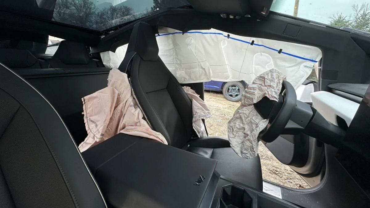

Reading on this further, it looks like even IF the seat covers had notches on both sides, the typical design used for the notch would cause a slight delay in the deployment. This video does not make me feel all warm and fuzzy:
