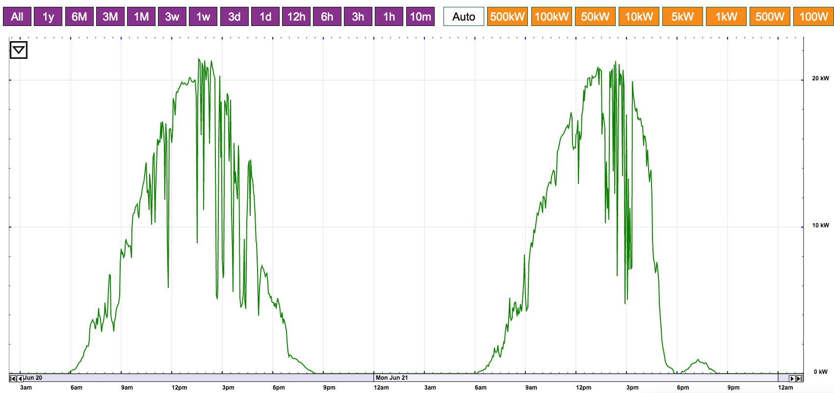

You can, as noted, charge a Tesla from nothing but solar arrays and an inverter. Here's another picture of a couple of days collection showing what clouds do.
Tesla Cybertruck Off grid solar eGauge3
It's plain from this picture that there are opportunities on either of these days to charge a Tesla, even at a high rate. You actually wouldn't have to do anything. You could start charging at 0945 on the 20th at a 10 kW rate. You'd be fine until around 11:45 when the car would shut down. But as long as the 240 is there it will try to start again. When it starts a charge it ramps up. I don't really know what happens if voltage starts to drop before it reaches the desired rate. I think it is doing this ramping to test the supply and so I think it will shut down again. But it will keep trying and after that cloud passes it will be able to draw the desired 10 kW with voltage in range and the charge will resume. On the 21st (the solstice) you'd be fine at 10 kW from 0900 to 1430. For daily use replacement charges these windows are probably sufficient. They are for me. This is actually how I charge (except that the utility would step in rather than the charge terminating if solar can't do the full 10 kW).

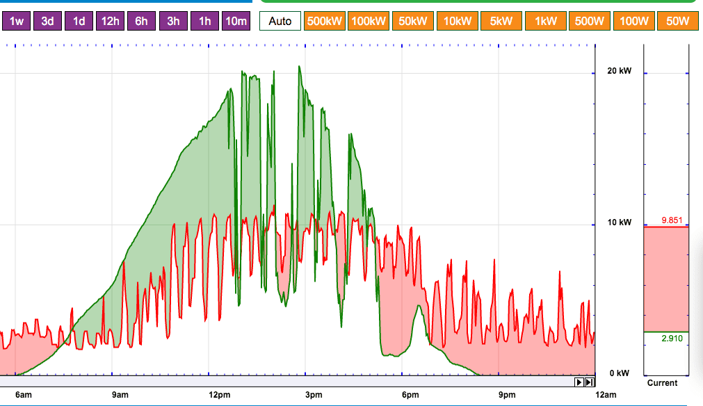

Yeah I am I know. I was saying that the CT should really have the option to plug PV in directly for off-grid use like yourself. Thats the options we've been trying to figure out here, on how best to go about it. :)
