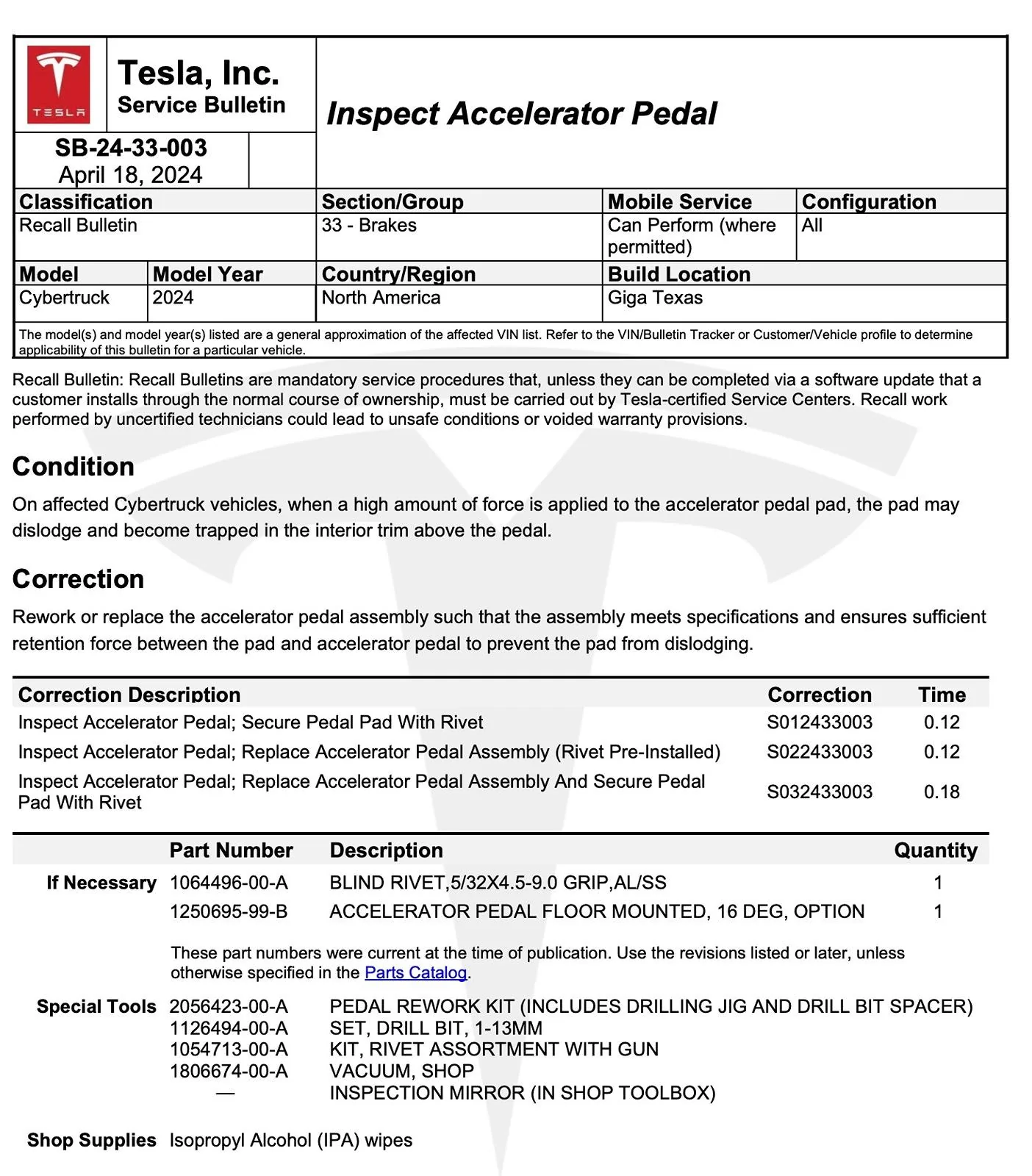

I don’t get it, is this a service bulletin issue or a recall? If this is a recall and potentially hazardous, don’t they have to redesign it and replace all the pedals with a more secure design? Or they’ll only replace it if it fails an inspection?

I don’t get it, is this a service bulletin issue or a recall? If this is a recall and potentially hazardous, don’t they have to redesign it and replace all the pedals with a more secure design? Or they’ll only replace it if it fails an inspection? This doesn’t make sense.
Didn't you read it?
It was redesigned, they are adding a rivet and/or replacing the pedal.
It's Service Bulletin.
After some more reading, there does seem to be a voluntary recall associated with this. 2 reported instances, but Tesla decided to recall 3000+ vehicles.
But this is the Service Bulletin that tells the Service Center what to do.

Supposedly, this is a temporary fix. They may redesign the pedal and do a retrofit later.
