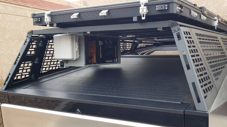

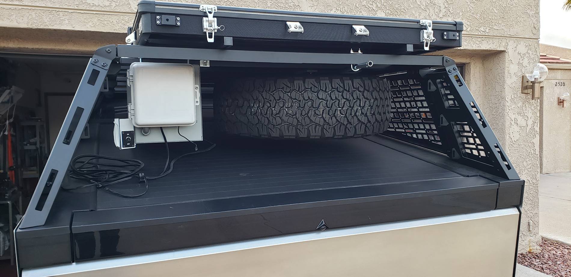

In just a week, partner and I will embark on our epic trip to Alaska starting from Havasu, AZ. It's taken a whole year of planning equipment, travel route, charging strategy, etc. The equipment includes a Urander bed rack with an Inspired Overland carbon fiber rooftop tent. I added a 420W solar panel to the tent with a 24V 2.56kWh LFP battery, Renogy Rover charger controller, and 300W pure sine inverter to power appliances, Starlink, electric blanket, and electronics devices. I'm taking along a Westinghouse iGen4500 dual-fuel generator, 50 lbs of propane, and an empty Jerry can in case I need to resort to burning gasoline. Propane is widely available, however. A 30lb bottle of propane will put a bit over 30 kWh of energy into the truck battery from the 30A TT-30 outlet on the generator (limited to 24A on the mobile charger). One can expect an efficiency of at least 500 Wh/mi driving on Alaska roads which can be challenging to drive on and are constantly being repaired.

Tesla Cybertruck Overland Trip to Alaska - Follow For Updates Spare Tire Mounted
Tesla Cybertruck Overland Trip to Alaska - Follow For Updates Solar power box
