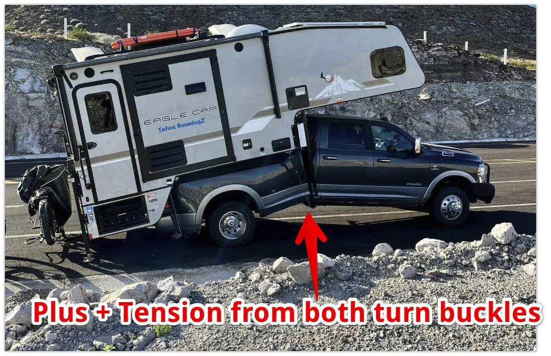

I saw this photo and just had to share it with the group. This is what happens when you put massive amounts of weight cantilevered off the back of a vehicle. My guess is that bike rack with 2 heavy Ebikes hanging off the back, is the straw that broke the camel's back.
The lesson I get from this is that payload capacity is based on within the vehicle. Not hanging way out beyond the bumpers! ;)

According to the story associated with that pic the weight on that slide in was 7800 and the payload rating on that ram is 5850
Math is hard

Wow, and on a 3500!

I'm guessing a bump or dip in the road did the damage (in conjunction with all the weight).
Ding ding ding!

Correct. Normally if you put all that weight off the back. The front end of the vehicle would start getting light. But what we have here is about 4,300lbs on the front axle alone. So you're right, the weight out on both ends forced the middle to buckle! :oops:
