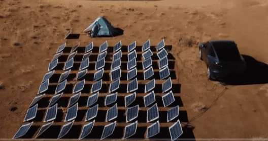

The short answer is not worth it, the panels are big and most are fragile, they generate a small amount of power.
For instance Power of Light charged his Model Y but it took a couple of days and a LOT of panels before he could move on. You are going to be better off with a small generator, or waiting until the CT v2 comes out with a larger battery.
