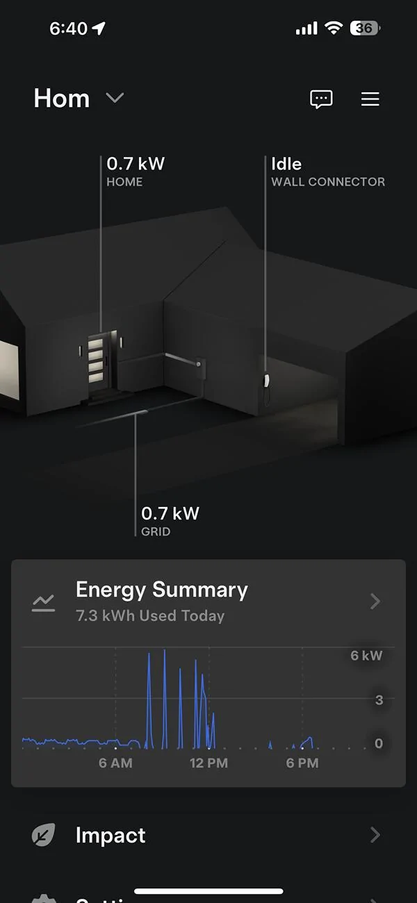

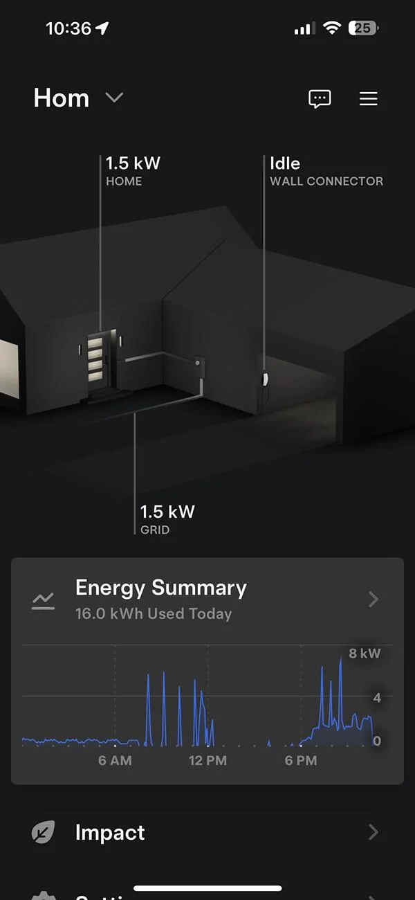

I also am in a similar situation -
PowerShare equipment Gateway3 and universal wall charger installed.
Powering the house via the truck does not work but charging the truck from UWC and Tesla app charging info and kWh from the grid are reflected in Tesla app. Posting a few pics of app and will post pics of gateway3 wiring later.
My installer ran the utility power 200 AMP service directly to the Gateway 3 with a 200 Amp breaker before the Gateway3. He installed a 60 amp breaker to the UWC and two separate 100 amp breakers in the Gateway3. I also have solar run through an Enphase monitoring system on micro inverters that is in one of the 100 amp sub panels. I am on net metering. I was told the house uses supposed to use the solar generated during the day and any extra generated is feed to the grid. Never been able to verify based on the Enphase info compared to electrical bill and meter.
So is this similar setup to those who have posted?
I can see via the Tesla app how much kWh are coming from the grid and also how much is generated from the solar system.
The installer warned me that i should not keep the truck connected to the UWC when not actively charging in case the grid goes down and the system’s solar may back feed to the grid.

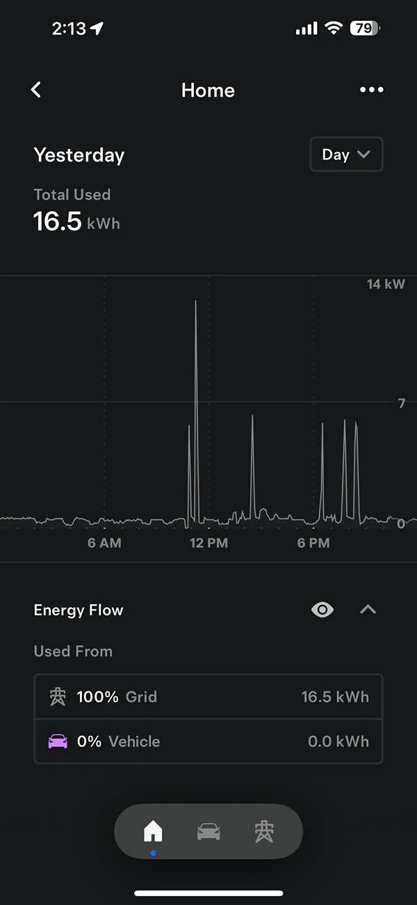

What the solar installer said about not leaving your truck plugged in the UWC and your solar panels back feeding the grid is not true. Your solar system should have it's own disconnect when it's not receiving power from the grid. Your Enphase micro inverters will not produce energy when they detect that the grid power is off and once your system receives the solar software update from Tesla, your gateway will disconnect you from the grid basically isolating your whole power system (solar panels and powerShare) from the grid. This enable your PowerShare to function as a stand-a-loan micro grid that will power your Enphase micro inverters so that your solar system can help power your house along with the battery in your cybertruck.
Thanks for your input and knowledge about my Enphase solar.
This is my electricians first PowerShare install.
I am paying about $5,300 for the install. It seems overpriced for 2 days of work for 2 men, but I am happy that they full house backup 200 amps through the PowerShare gateway and that they ran the utility lines first to the gateway and made my two breaker like sub panels.
Can anyone comment if Backing up all 200 amps is a no no for the PowerShare installation. I know not to try to run all the heavy 240 appliances, stove, two Tesla chargers, and three split AC units while backing up from the CT.
With my PowerShare installation I can now see via the Tesla app how much electricity is coming from the grid and exactly how many kWh of energy is being used by the house at anytime. My Enphase box works intermittently- on for about three or four weeks then I have to turn it off for 3 to four weeks to get it running. This is the original Enphase box installed in 2012. Per Internet search this model Enphase box craps out in about 5 years, and seems newer boxes are similarly unreliable . About 4 to 5 years ago, As suggested on the internet I tried to heat and reflow some of the solder connections on the box’s electronic board, no help.
Would appreciate if hearing about others experiences with the Enphase controller/reporting boxes.
