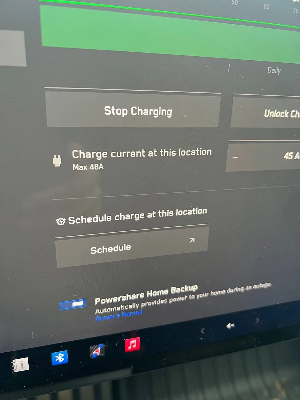

In your Tesla app, Cybertruck page, choose Controls and slide up the bottom section. Scroll down and enable the Powershare Home Backup section and set your discharge limit.
From there, it should be as simple as switching off the main breaker in the gateway.

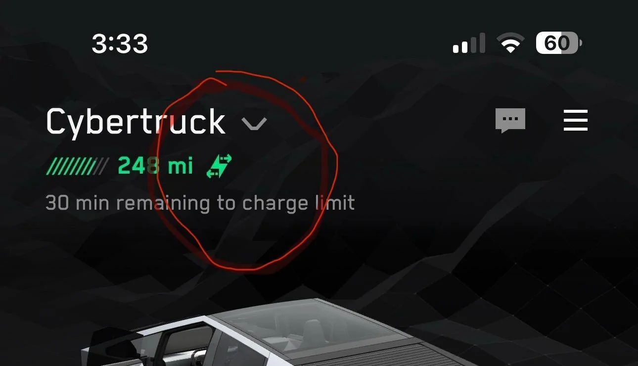

Okay. Here’s a couple things to look for. In your CT, do you see a place where you can enable powershare? See in my second image, there is a toggle at the bottom of the photo?
When you look at your CT charging, do you see a small bidirectional charging icon?
The power that comes to my home is controlled by a breaker outside the home.
When I throw that breaker, the home gets now juice.
If my CT is connected through the wall charger, juice the starts flowing to the house (green bars flowing toward the house).
When setup had not been finalized. The wall charger would show red.
