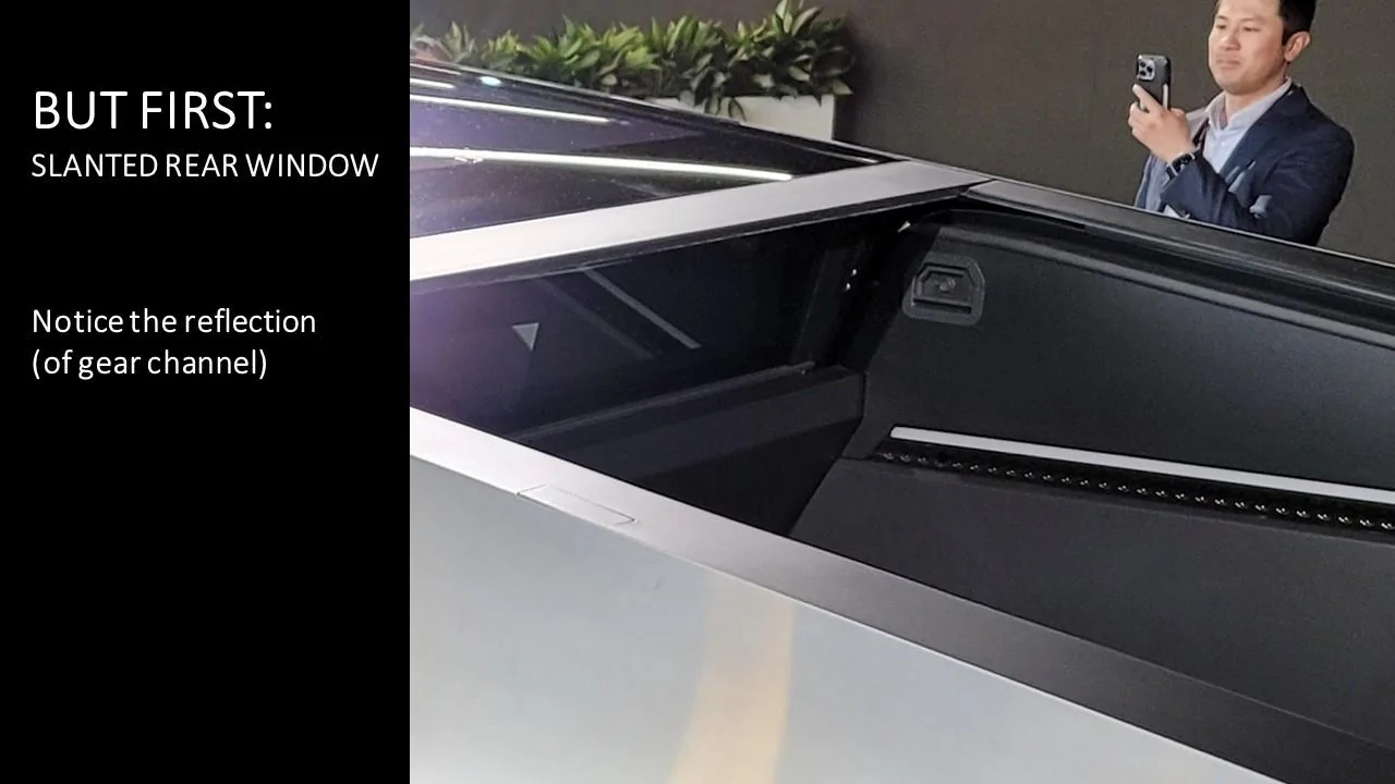

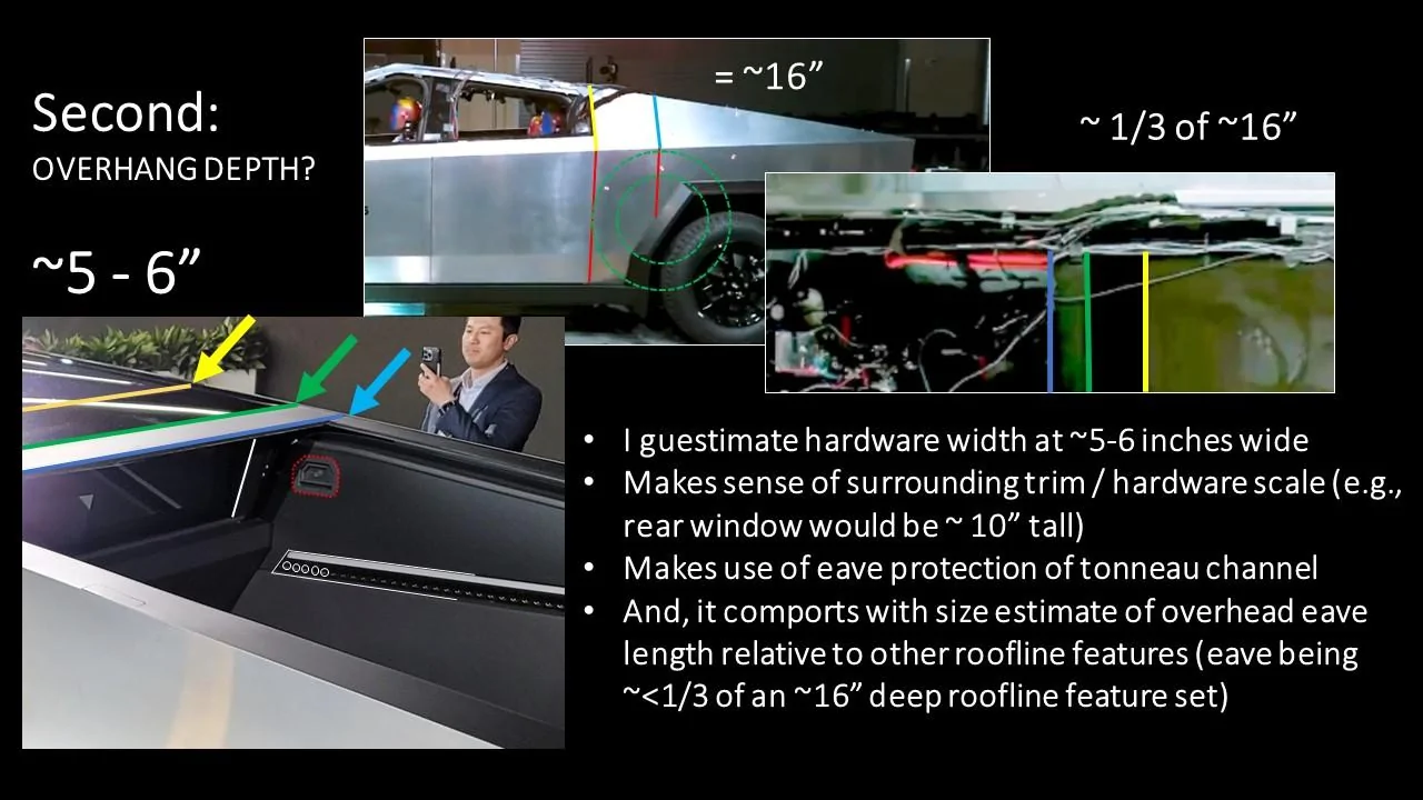

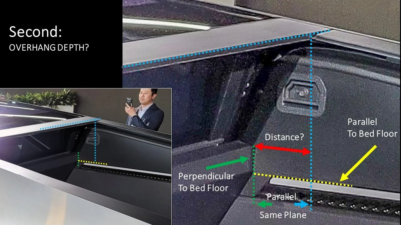

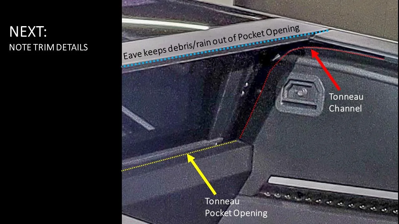

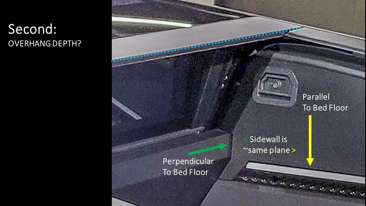

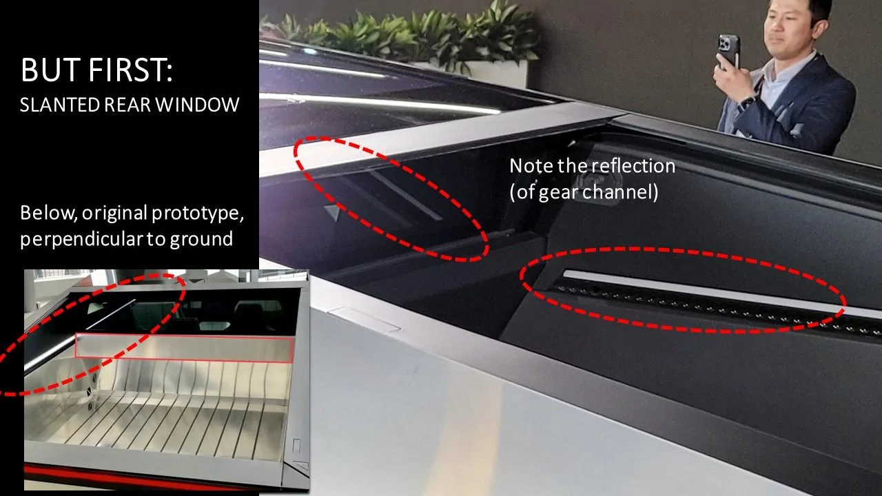

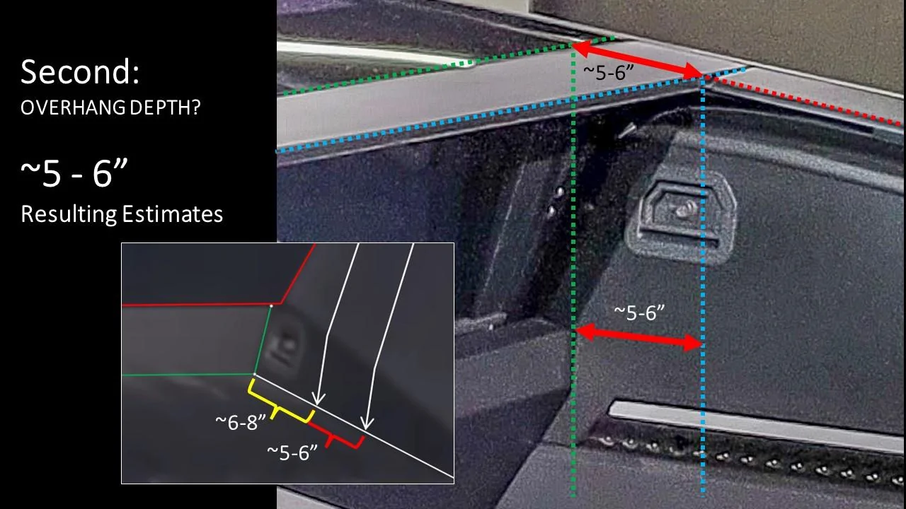

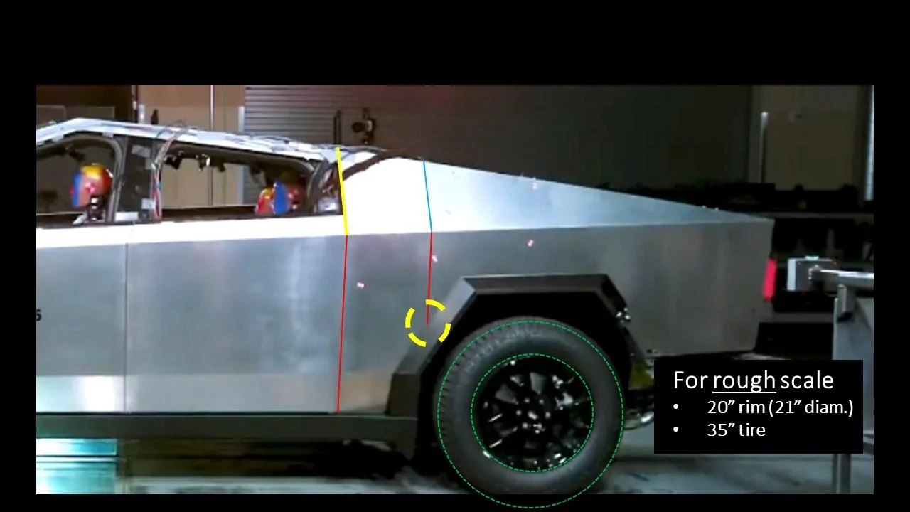

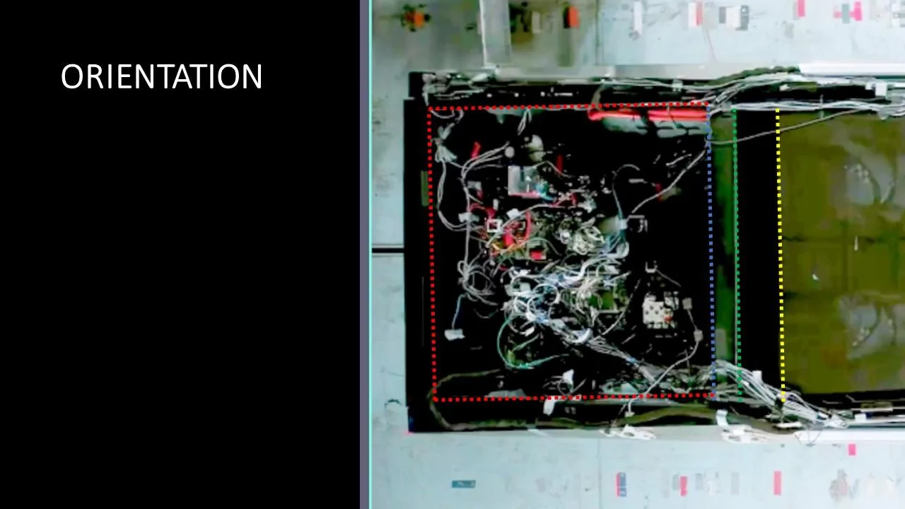

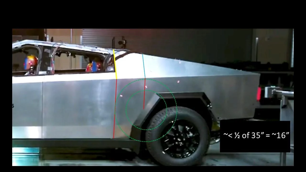

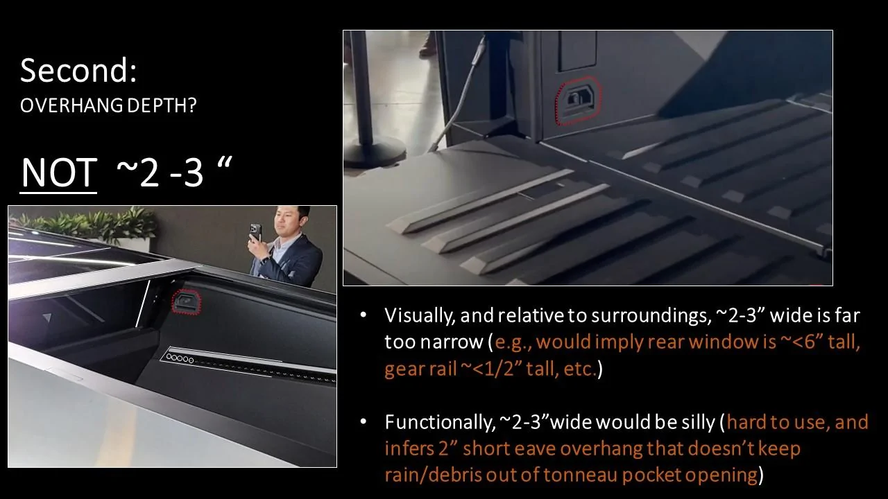

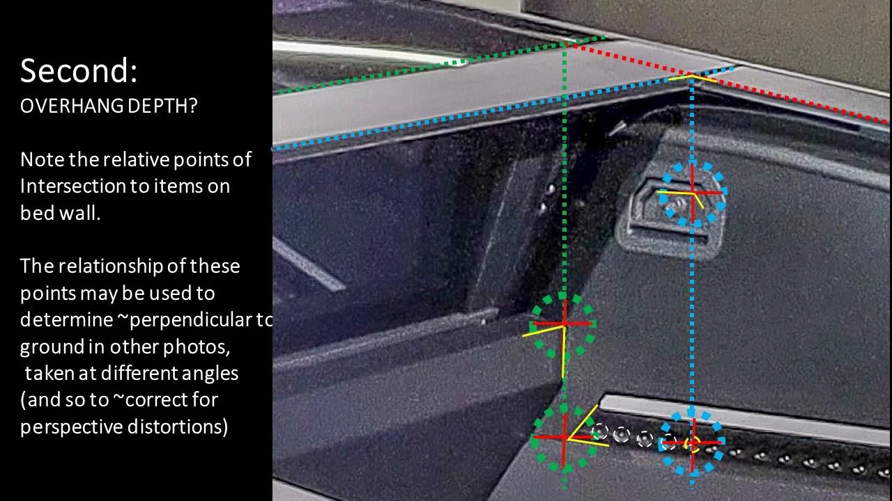

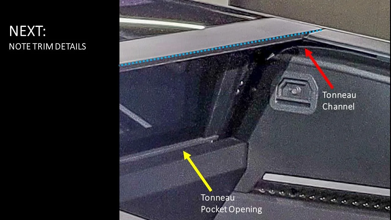

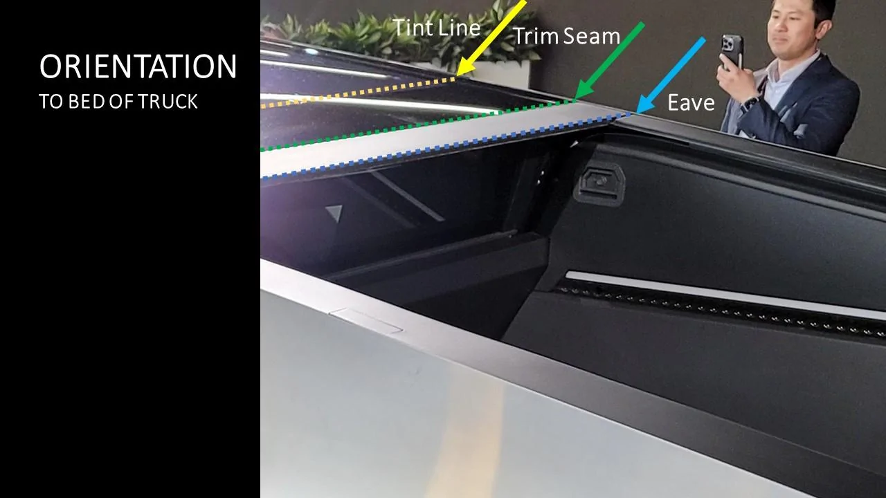

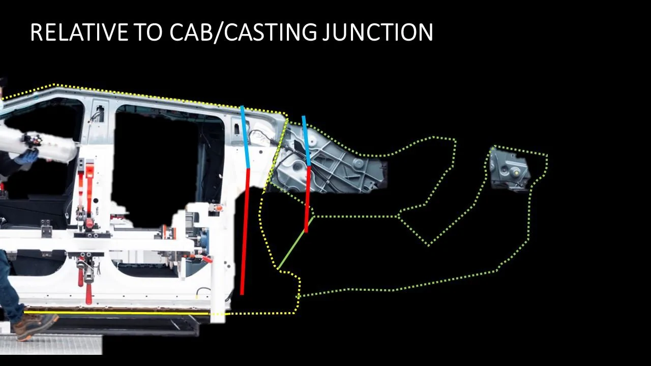

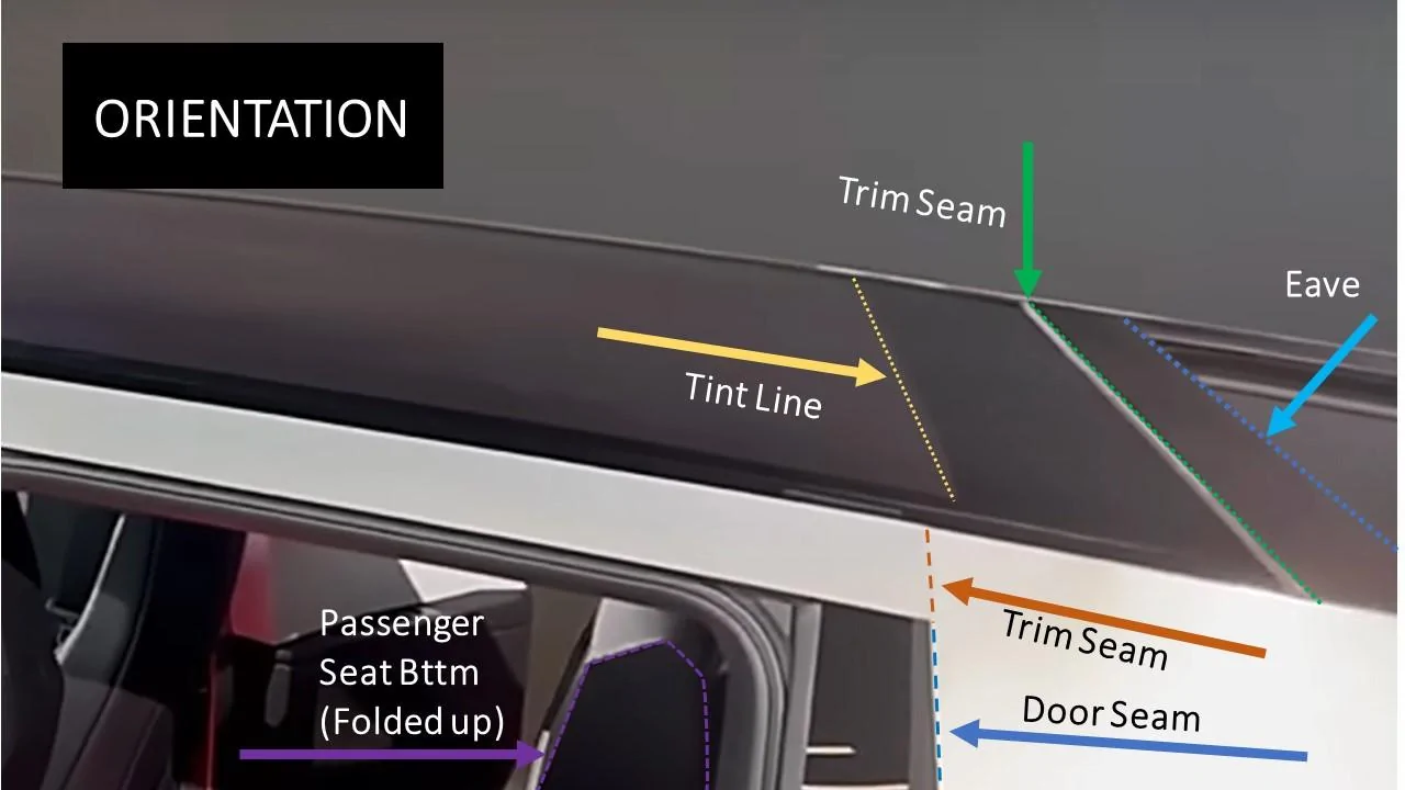

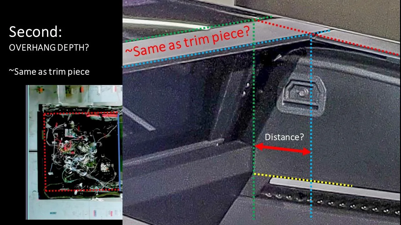

Again informed by the few new photos of CT construction, like the Q1 earnings frame photo, crash test video, and a particularly helpful pic from @greggertruck - I've put into photo format some of my mental map of some of the bed / bulkhead features.
None meant to be definitive to any fraction of inches, but instead meant to be better considered than a wet finger in the wind.
A bit overkill I know, but seems around here brevity is viewed as an exploitable weakness :ROFLMAO:

that, and, e.g., mapping out (in my head) a lot of changes made that collectively make it
• possible for the rear window to roll down
• possible the rear seats recline
two things I’ve never had but always wanted in a truck

I was seeing this too and thinking about the ~3% shrinking
If the Bed is still 6.5 feet deep, is that only the floor of the bed and not the whole bed? Kinda like the other cars have a big trunk space, but not much head/top room. So you can actually put a big box but rather many bags in the trunk.
Will this be similar, maybe just enough room to have the quad in the back with the door closed, but cannot put in a 6.5 foot box that is 5 feet tall...
an observation I didn’t include but maybe should have:
Regardless of disagreements around max bed depth (eg 6.5’ vs 6’), I don’t think the bed max width is controversial. I think there’s broad agreement the max bed width will be right around 60-65” wide, like any other full-sized truck bed.
The irony is that, *some people* who argue that there isn't much encroachment by the bulkhead/eve, don't realize that they're inadvertently arguing that the max bed depth is significantly shorter than even 6'
