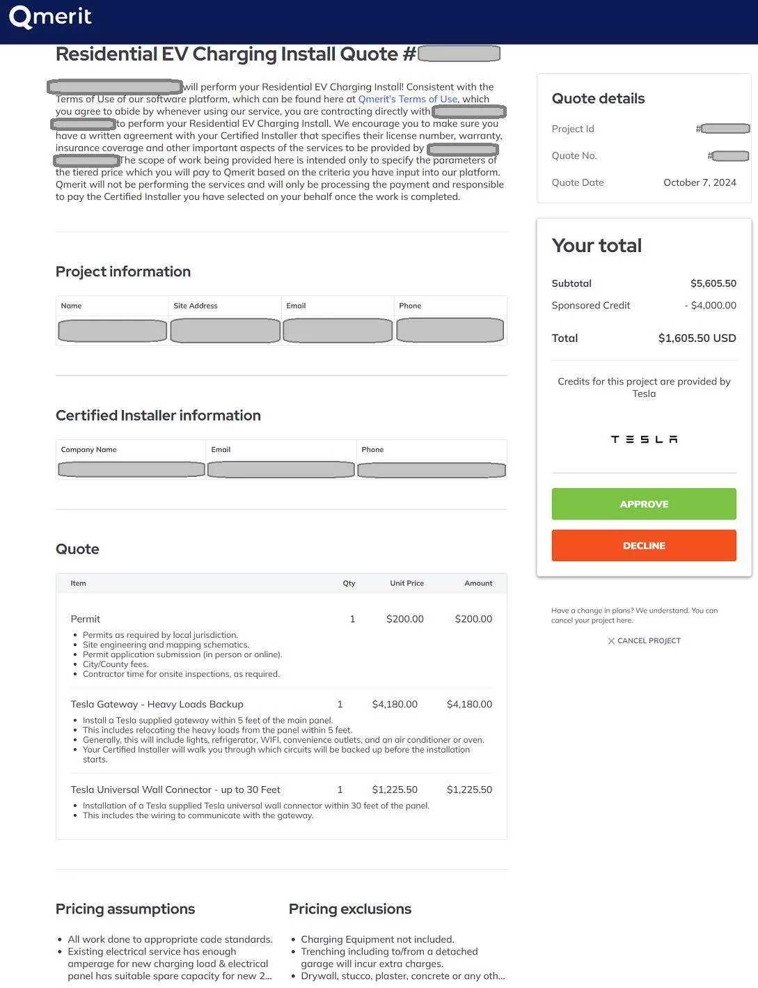

I've attached my quote and will explain the simplicity of my install. I find my price of about $5600 to be oddly similar to some others I've heard who also have had simple installs.
The 3V unit will be mounted right next to the existing breaker panel (less than 6") and has a clear path (3 holes I've drilled/will drill) to the mounting on the exterior of the house for the charge unit. It will be ~35' of cable and will be mounted in open basement cross braces. This install will not require cutting into walls/etc and will only be moving 2 20A circuits over.
It is also worth noting that Qmerit didn't even send all the information I provided them to the contractor. I was contacted by the contractor for the details I had already provided. I gave the basics of the install to the contractor over the phone, sent them about 10 pictures, and received this quote from Qmerit with no other contact.
Verbatim my quote and cost. Haha.

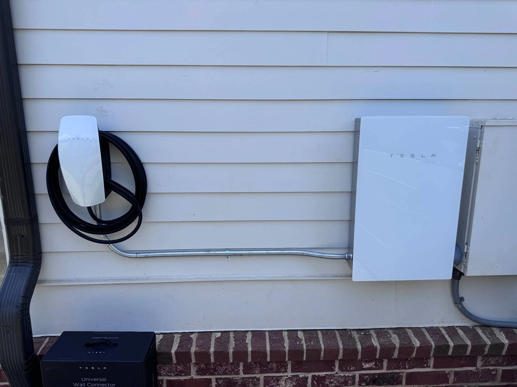

If any of you guys are in Georgia, and would prefer to bypass Qmerit for installation, please give us a call at 404-520-7349. We are a Tesla Premier Installer for Tesla Energy products and have installed over 50 Tesla Powershare systems for our customers in the Atlanta area. We offer a personalized turn key installation experience, without the hassle of dealing with the Qmerit platform.
Our average price for installation is $3250, which includes:
-all materials
-labor
-commissioning and registration of equipment
-adding the UTWC and GW to your devices in the Tesla App
-owner training
-provision of any local rebate and federal tax incentive forms.
*Photo below was $2250.
