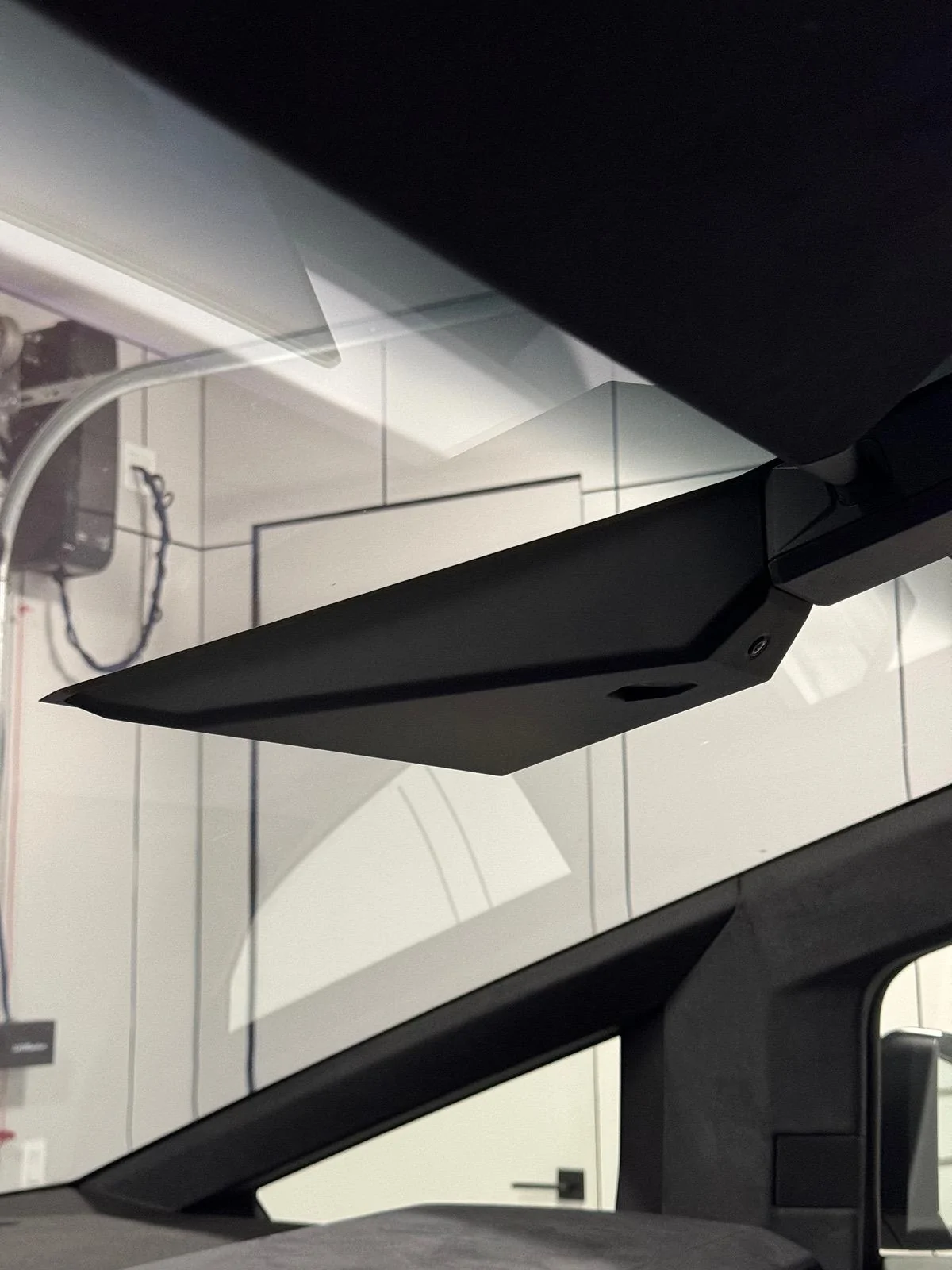

the other side of this:
Tesla Cybertruck Rattle after rear view mirror delete 1710180262651
JGTESLA
Mar 3, 2023
125
230
Foundation Cyberbeast, G Class Mercedes
Just to confirm I follow, you just attached a small piece of Velcro adhered to the other side of that small door and then closed it again?
JGTESLA
Mar 3, 2023
125
230
Yes.
My theory is that, after the rearview mirror removal, the large flat cover loses it's anchor point that the mirror provided, resulting in allowing that cover to vibrate more producing rattle.
Sounds reasonable to me. Just bought a Velcro pack on Amazon coming later today.
Didn’t think I was going to remove the rear view mirror but after taking delivery and seeing how comically small and pointless it is, I’m going to opt into better front visibility and take this little guy down later today.
