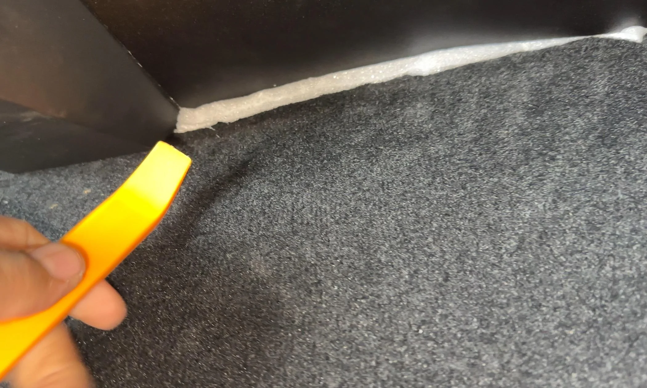

Here's the video. Finally caught it making the noise. I'm pretty sure it's the air compressor. Service schedules for later this month.

The foam suggestion worked. I will tell the service center and see what they do to permanently fix it.

This is at the bottom of the rear center console, correct? Under the touchscreen?
