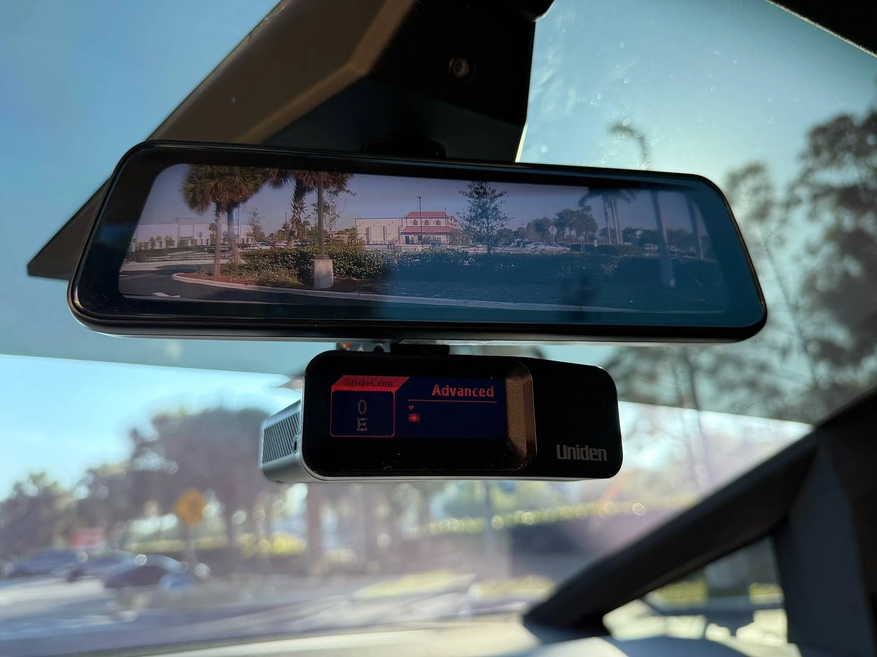

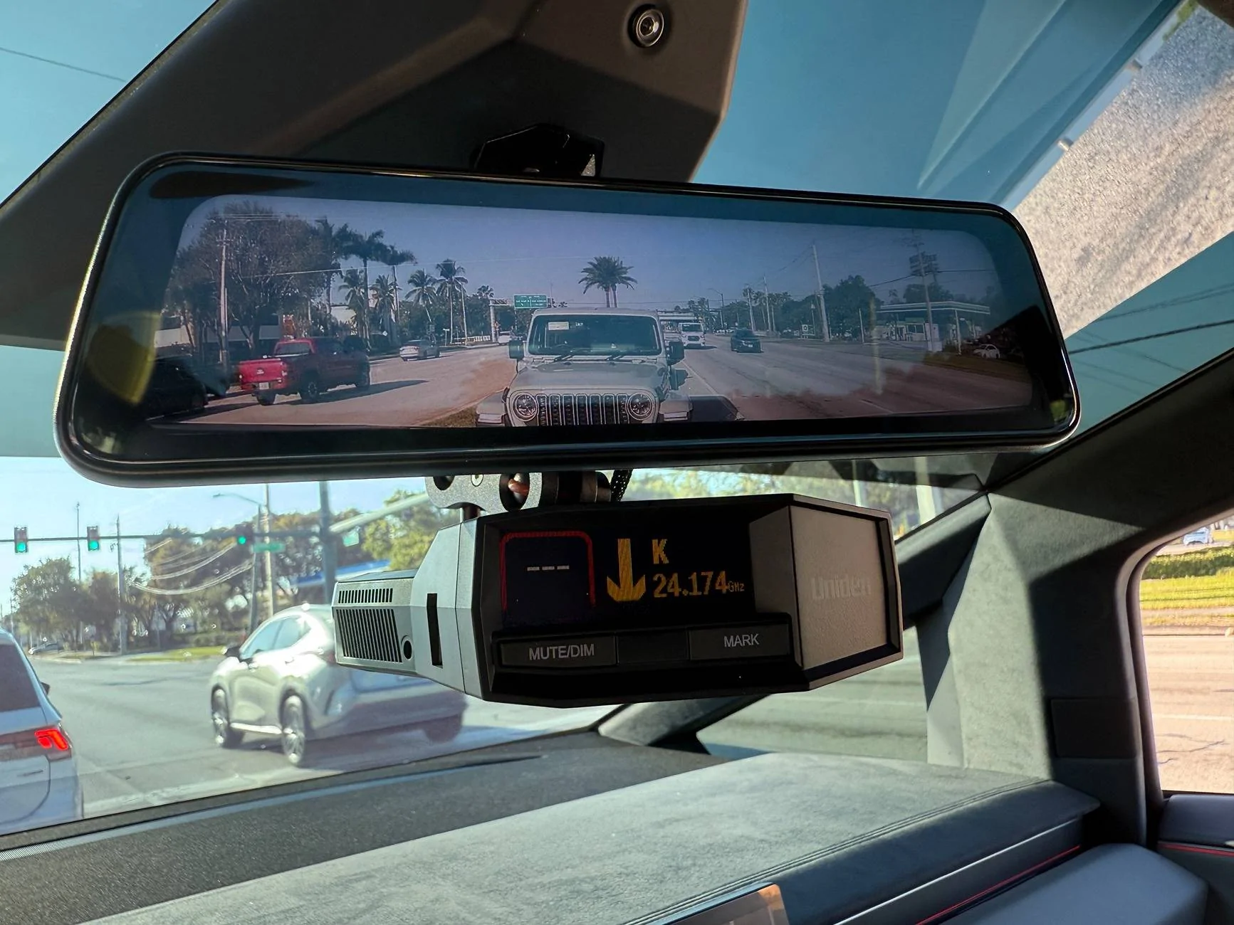

One more issue I found specifically with the Hansshow mirror in conjunction with a modern radar detector such as the Uniden R8 installed directly under the mirror/GPS unit.
When you have this Mirror installed (even without a radar detector), you have to be EXTRA careful when routing the wires on install around the GPS antennae reflector sticker which is inside the camera cover that you pop off. Not many instructions or videos tell you about this. I learned the hard way by having to install it twice and adjust it after the first install because my GPS was WAY off.
With that issue fixed by careful wire routing, you then have to be aware if your modern dash mount radar detector has Bluetooth and you have this mirror installed, it will again cause GPS malfunctions in the Cybertruck. My guess is that the Bluetooth is as much a culprit as the mirror wiring that wraps around the GPS antennae. With both combined together it causes issues probably by amplifying the affect that the Bluetooth has on the GPS antennae.
As a test and double check, i swapped out my Uniden R8 for my older unit the Uniden R7 which doesn't have Bluetooth and it had no issues affecting the trucks GPS. So I swapped back to the R8 and had to disable the Bluetooth and reboot the radar detector to get it to stop interfering.
