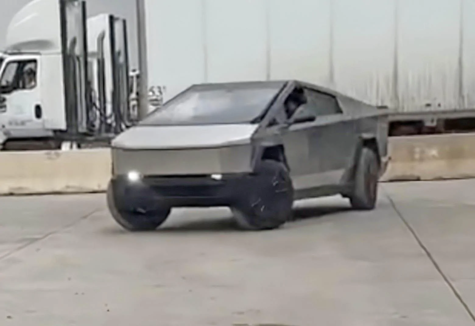

Does anyone have an idea how a driver would operate this function? As most of the Tesla vehicle interiors are button free, I imagined it could be a control in UI settings, but this could be cumbersome. Trying to operate UI and steering wheel while navigating a tight turn in a busy parking lot could be stressful.
I imagine the operation could programmed to be activated by the steering wheel in the right conditions. Low speed, steering at or near lock, then the back wheel turns to decrease turn radius. It could be initiated by increased tension on steering wheel as a haptic feedback to let you know your in 4 wheel steering.
Crab walk type 4 wheel steering would be a little more tricky to operate. Vehicles aren't designed to moved this way and it's applications may not be readily apparent. Would it be practical to use to change lanes at high speeds or would that be dangerous? Would it be used it towing hitch alignment or assist in reverse while towing? I think obstacle avoidance for rock crawling would be more low yield than these other use cases.
I know there could be as many applications as people using the car but what will yield the most practical and common applications for crab walk type 4 wheel steering? Crab walk seems more gimmicky to me than other type 4 wheel steering.

I'm thinking it would be speed dependent for the most part. Below 10 and they turn in opposition to make tight maneuvers easier. And then above a certain point they turn in the same direction to increase stability during lane changes. For crab walk and other things I guess the screen would be the key, some setting like carwash mode or maybe an off-road mode. But definitely not a button like GM's Quadrasteer .
797
1,270
Maybe not much more.
it only shows when the front are turned all the way, tho. Kinda like ai predicted; that would make it drive more like other trucks usually.
Yea, if the CT retains the originally-stated enormous wheelbase, it may need this feature just to have a competitive turning radius.
Maybe only if the wheelbase-to-length has narrowed, would this give a turning radius advantage

It could also be sensor driven. In the wiring picture, CT has these circular things at the corners. These could be the sensors that feeds into the rotation part.

4WS is not a new technology. It has been around for decades. Even my tractor has it. They typically operate in two distinct modes based on the vehicle speed.
Mode 1 is for lower speed manevouring, up to 20-30MPH, and is where the rear wheel angle is opposite to the front steering angle, for a higher rate of vehicle yaw, and smaller turning radius than without 4WS. The amount of steering angle is of course also proportional to the front steering, in that the rear wheels will intentionally try to more closely follow the front wheel track. The amount of rear angle is more at low speeds and gets less until it reaches the higher speed, at which it switches over to mode 2.
Mode 2 is for highway cruising and operates at highway speeds by steering in the same direction as the front axle. (Crab steer but angle constrained). This allows the vehicle to change lanes without yawing and stay mostly parallel with the directionof travel and the lanes.(yaw-twisting out and into the lane as seen from above). Yaw motions are what create load change moments, and also suspension changes and traction offsets. Avoiding this keeps the vehicle more stable on lane changes and greatly assists in mitigating tow vehicle (and driver) induced trailer oscillations.
All of these variables would be tuned to match vehicle dynamics, and then again for towing profiles, or even terrain and specific road conditions. They would also be linked into dynamic suspension setup, and ABS and torque vectoring profiles.
Another point worth mentioning is that the steering angle of the rear axle does not have to be much to do all these things, or improve the turning radius, so they won't have much rear steering angle. This also means that if the rear steering fails at any point, the front steering angle range will be able to compensate for a rear angle lock up, meaning you can still maintain control of the vehicle until you can come to a stop and pull over.
For the driver all these things happen seemlessly behind the scenes, and requires no user input in normal operation, except to turn the front wheel. The only thing you will notice as a user, if you are looking for it, is that the center of rotation of the vehicle will change position. On a front wheel steer vehicle this is inbetween the rear axle wheels. So depending on how much rear steering angle is being contributed in Mode 1, this point of rotation will move forward towards the middle of the CT. In Mode 2 it will actually move back, and can be behind the vehicle itself. Which is also why it has better towing stability as well, as the car "acts" as if it where a two front steered axle truck, and slews the trailer accross the lane.
