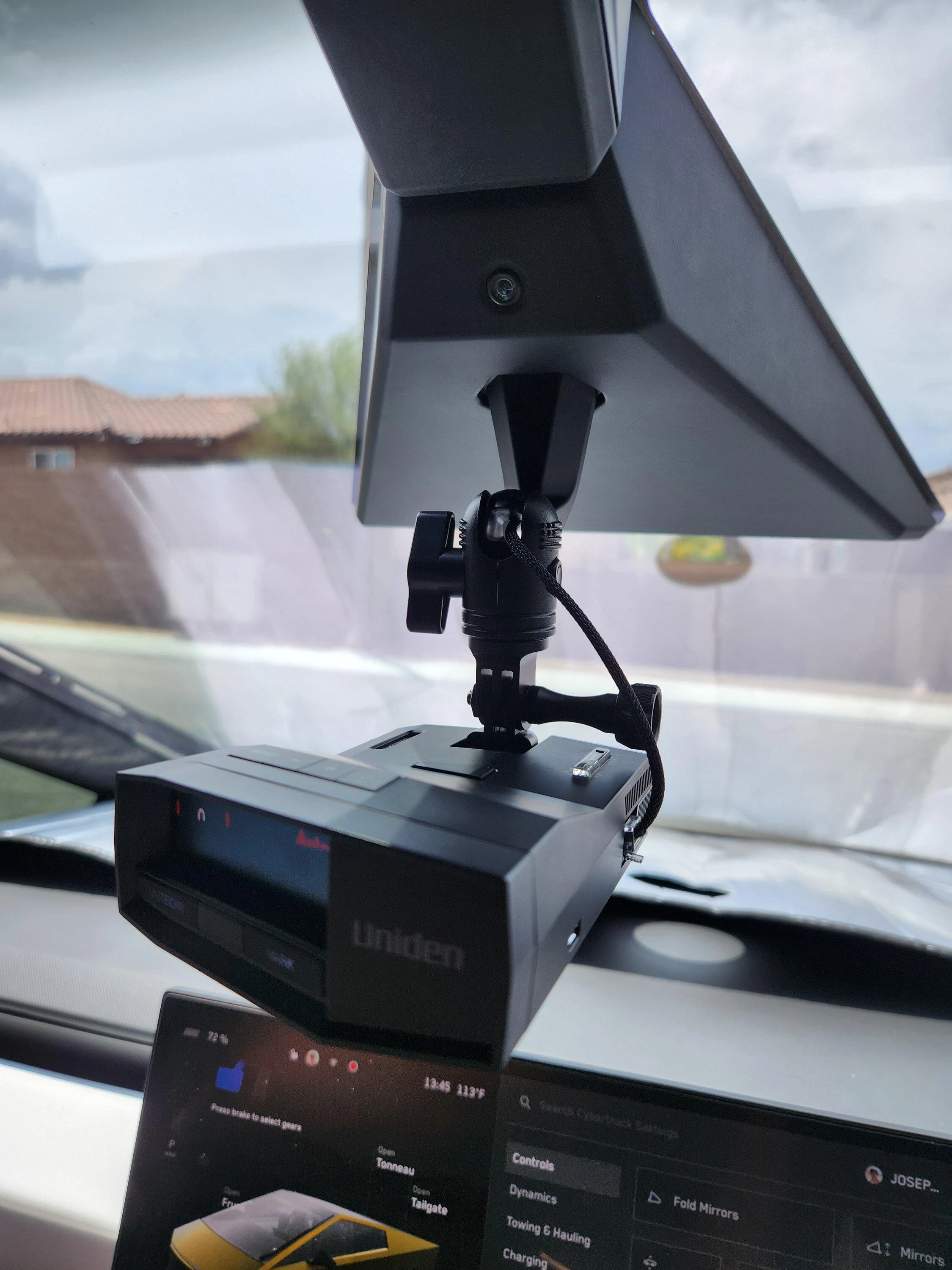

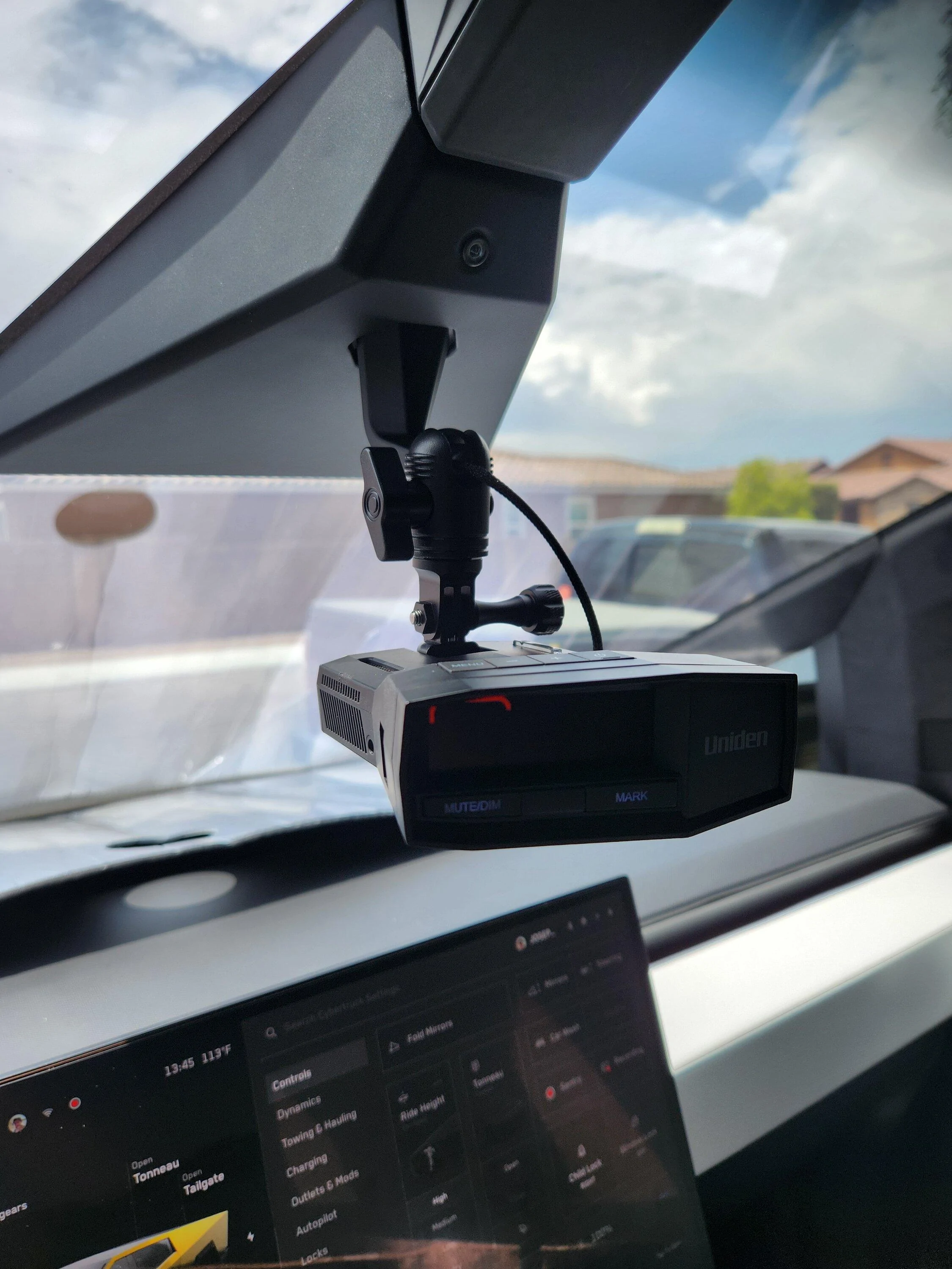

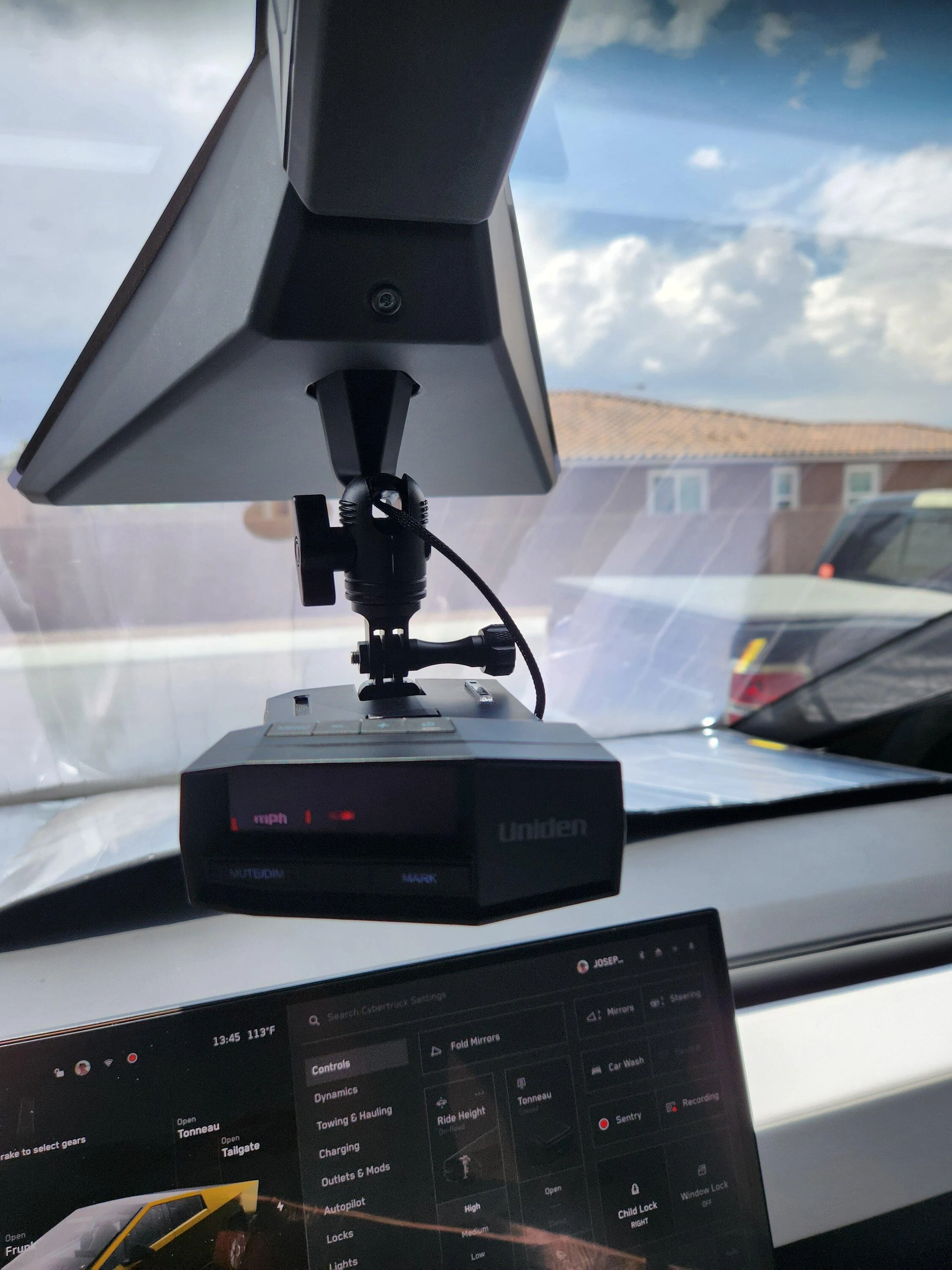

Replaced my mirror with my Uniden Radar Detector. Just pop out the mirror and and you have a 20mm ball. The ball has a channel where you can run the wires through and tap it into the red and black wires. I have a Uniden radar detector that came with a gopro mount which i used.

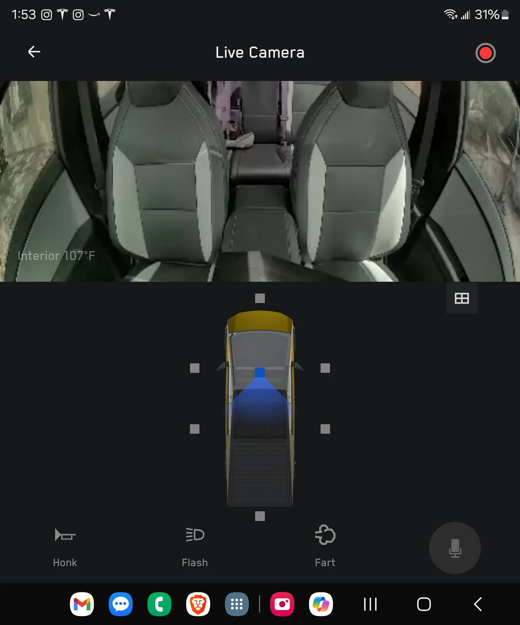

Attached are some pictures on how it looks and a screen shot of what the camera sees inside with it on.
