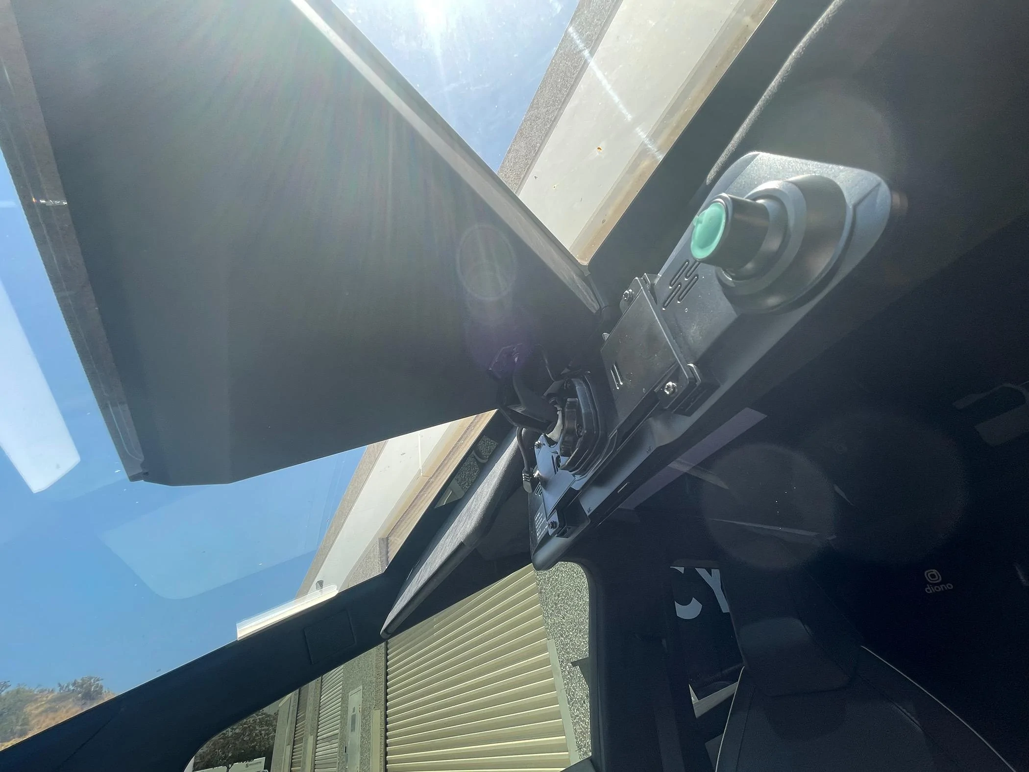

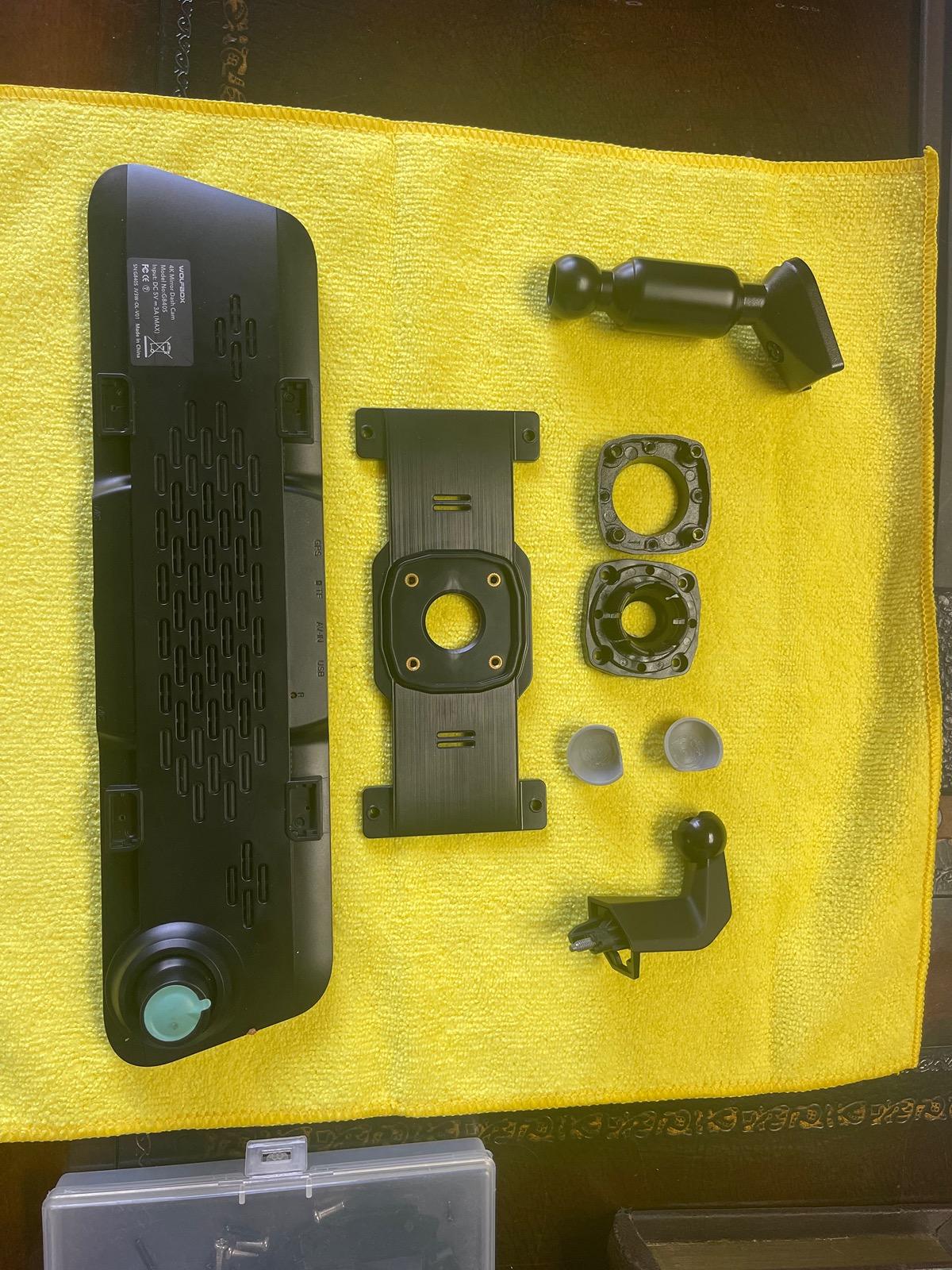

I’m almost finished installing the wolf box mirror. I ordered one of their oem mounting kits, maybe a Toyota, and took out their stalk. We then 3D printed the sleeve to size up from the cyber stalk to make them work. Now it fits more like oem.
I’m going to place the camera inside the rear door of the camper top, but have not finished it yet, tomorrow afternoon or Friday morning.
I am happy to share the 3-D print file in the Amazon links that I bought the parts on if anybody’s interested.

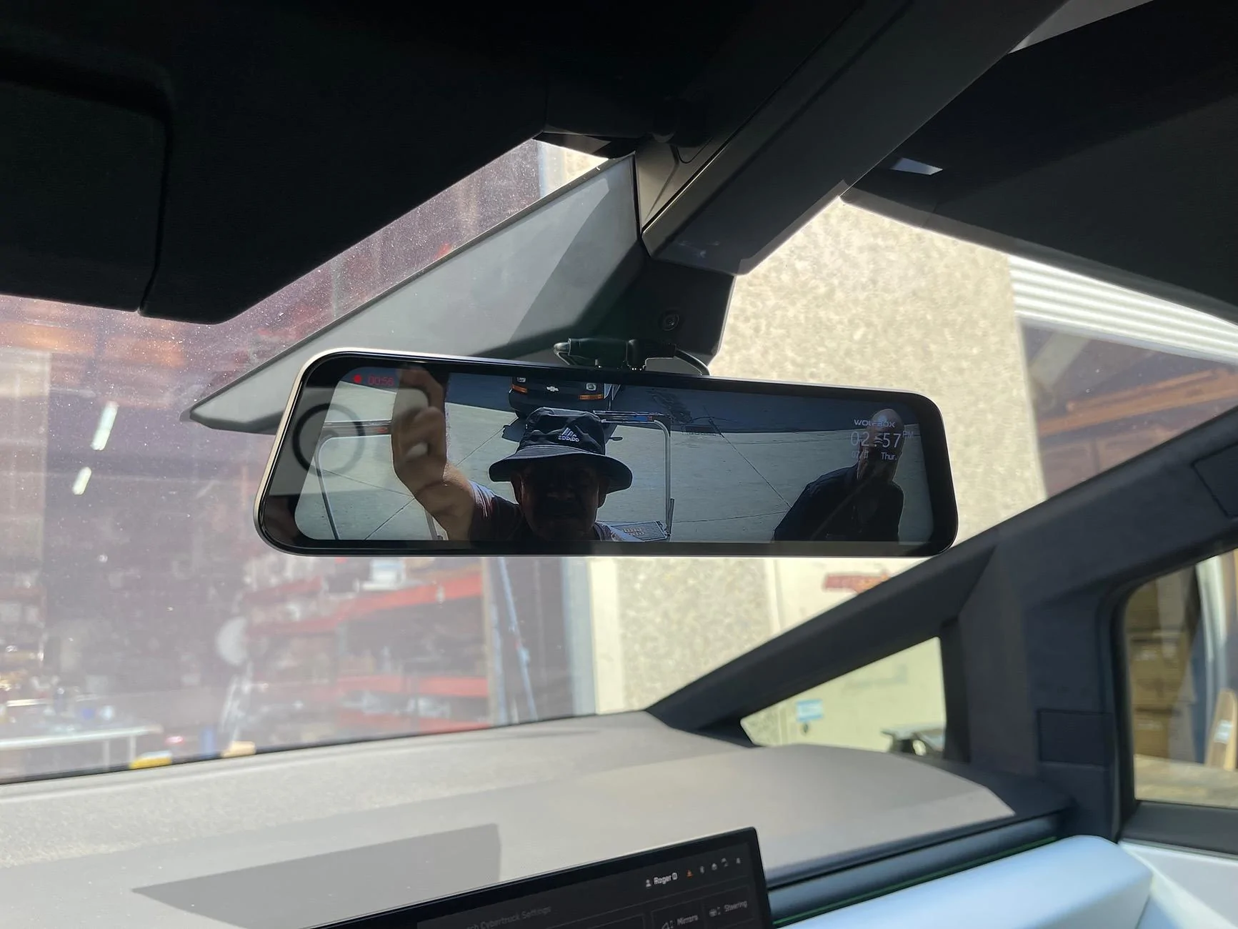

Finally got this finished for the road trip to Laguna Seca! I really like this set up, much better than the screen, should have been like this from Tesla. I have the camera mounted inside the back window on the cap.

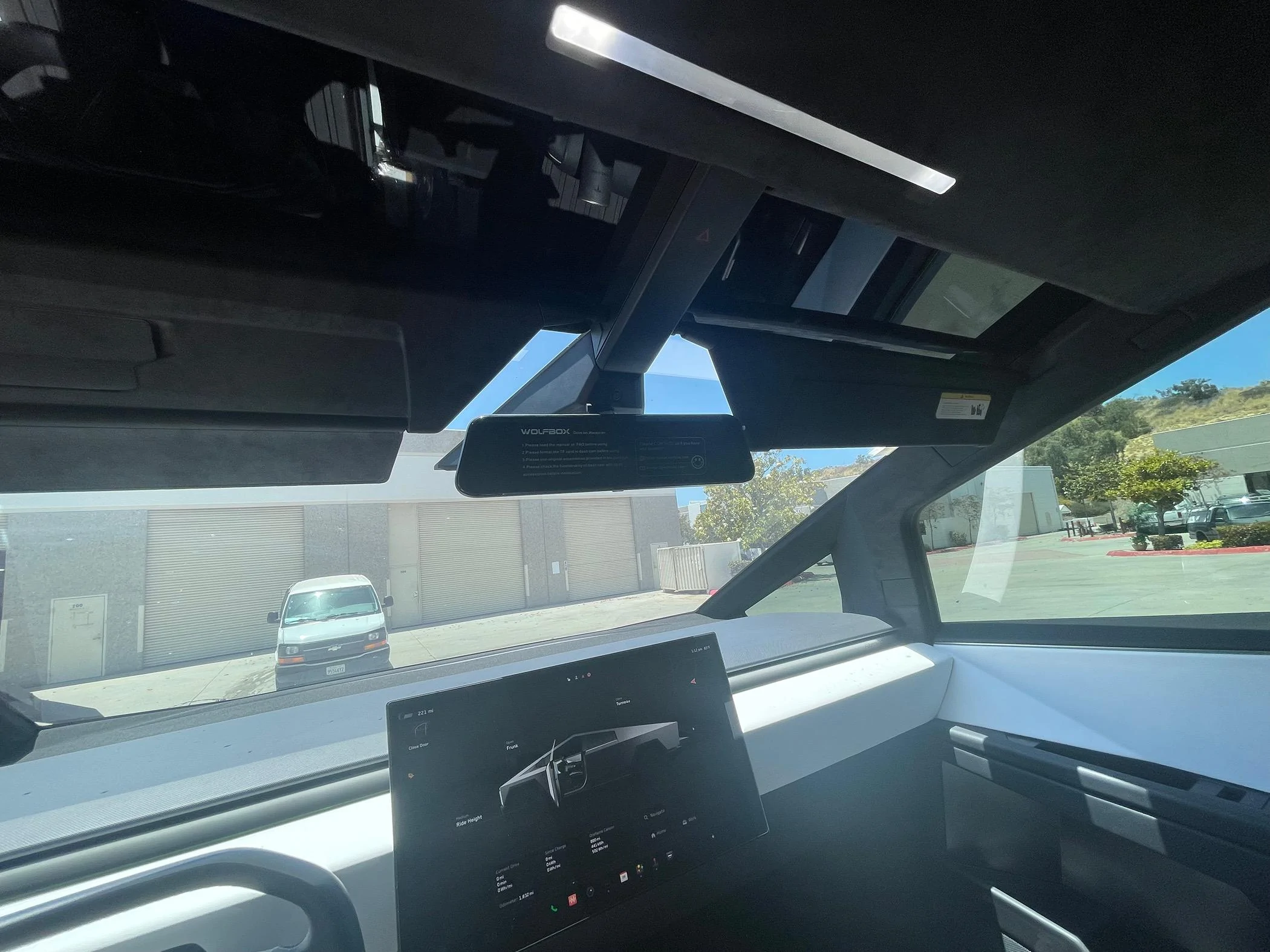

I just finished a similar install using the Wolfbox G900 mirror. I used the original Cybertruck mirror mount and the ball sleeve STL that CYBERTRUCKco generously provided. I opted for a license plate camera mount since I don't have a cap and preferred that over the hitch mounted camera some people have used. Overall, I'm happy with it, since the stock rear view bar on the center screen is just too small for me to make out detail and I don't like it vanishing when I use the turn signals.
A few downsides in my opinion:
The 12" mirror is a little too big, 10" would probably fit better, block view less and resolve some of the clearance issues with the top power and camera inputs. As is, the USB C power and rear camera 2.5mm jack rub against the forward camera housing.
The camera FOV appears almost identical to the FOV in the center screen rear view mirror bar. It's bigger so you can make our more detail, but I'd really prefer an option to narrow the FOV on the display or just a narrower FOV camera.
The display could use a day/night mode. It's too bright at night and the contrast makes it look washed out.
I'm hoping that somebody develops a digital mirror that intercepts and splits the stock rear camera signal and lets you adjust and crop the image onto a 10" or so display with a Cybertruck inspired design. I'd happily pay more for something that looks like a factory accessory with more focus on function as a mirror replacement rather than a backup camera (i.e. narrower FOV).
