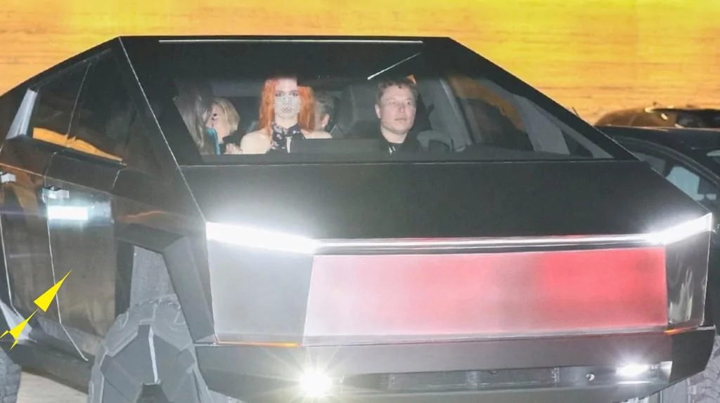

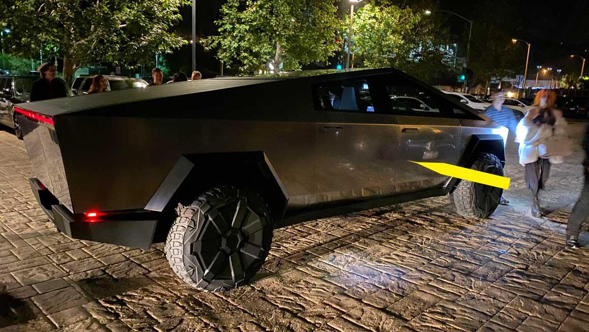

Some imagery shown of the CyberTruck, shows some shiny smooth surfaces.
Let's see what the final product surface finish will show.
