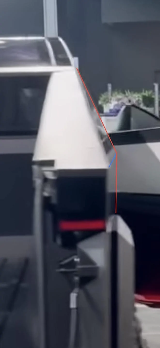

Why you are drawing the yellow lines on the side sail on a angle to the rear bed, and not parallel and next to the inside wall and lines in the bed?

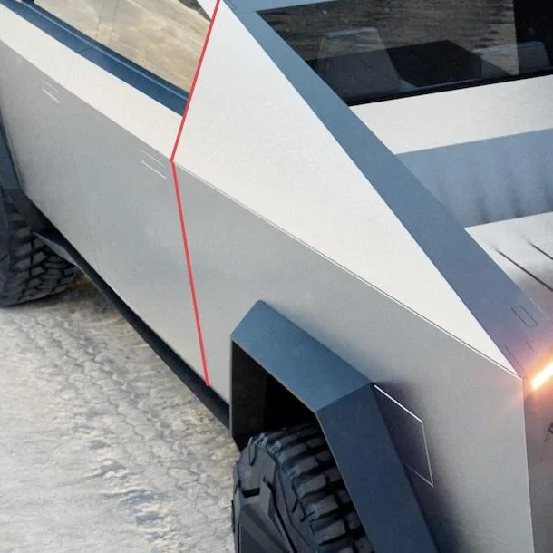

just a perspective issue - wasn’t intended angled toward the rear of the bed, but instead angle inward from the side’s main waistline (the blue line in the aconic drawing) to the crest of the sail. Here’s the same attempt, on a better angle (even if the older prototype), where the red lines are drawn over the rear door’s seam that runs perpendicular to the ground:
Tesla Cybertruck Official Cybertruck Accessory store is live!! Includes: Tailgate ramp, Basecamp, wrap, franz ball decal and more 846E8A2C-A771-4FDB-9098-B78EC45BD350
And here’s a similar shot but down the side of the investor day prototype, blue line the
waistline, red the same door line as above:

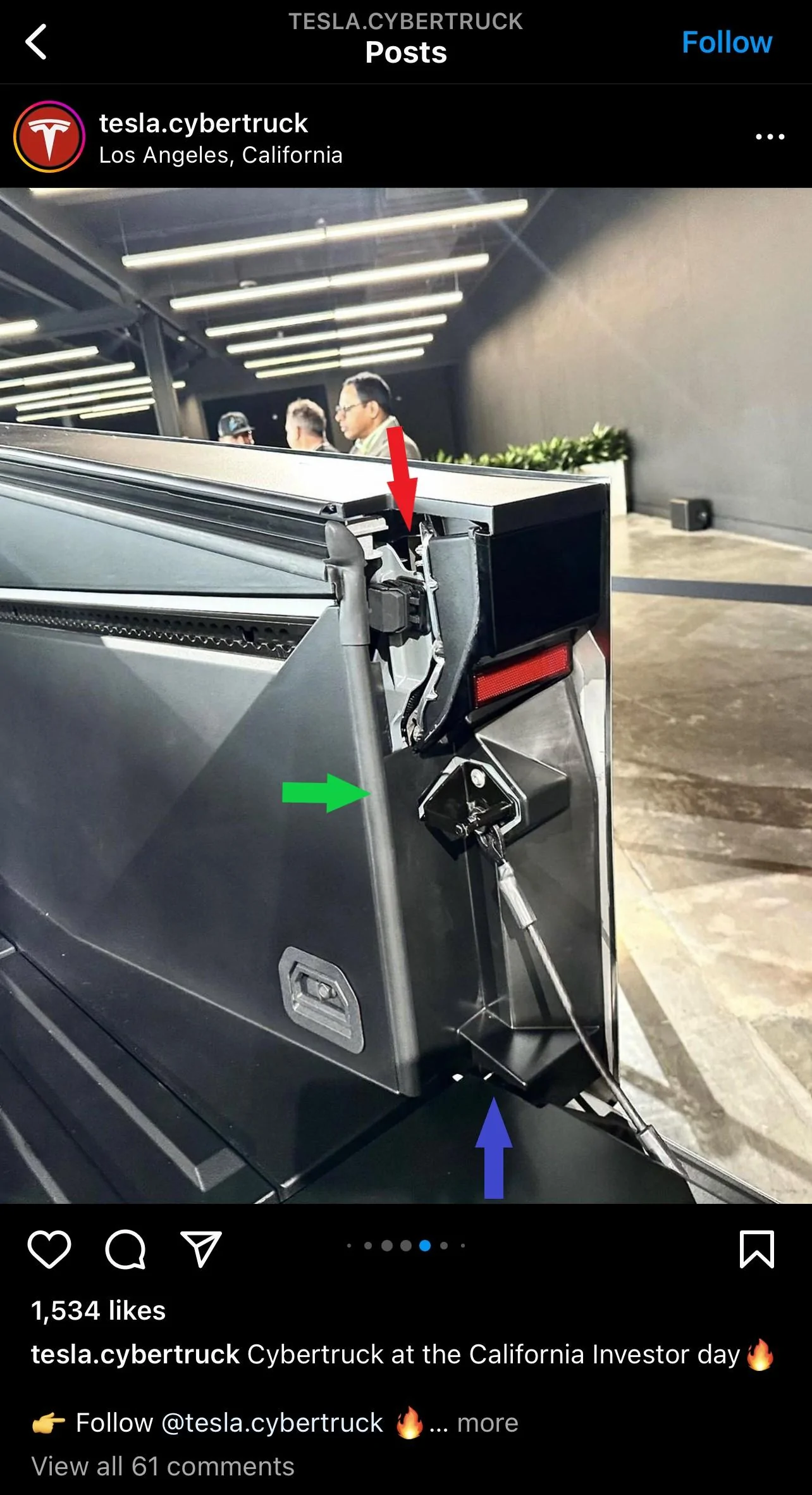

Funnily enough I found a photo that you posted that I believe actually show the rear casting exposed to the outside, that holds the right rear tailgate lock.
Do you see the grey section of steel plate that holds onto the black locking mechanism under the red arrow?
Tesla Cybertruck Official Cybertruck Accessory store is live!! Includes: Tailgate ramp, Basecamp, wrap, franz ball decal and more CT Tailgate Lock Cast body
I think that is this part of the cast here, with the lock mechanism inserted through the hole you can see here under the red arrow:
The green arrow is the mounting point for the tailgate cable support, and the blue arrow is the tailgate hinge mounting point.
If so this would prove that the casting is a) fairly slim there, and b) on the inside bed sidewall.

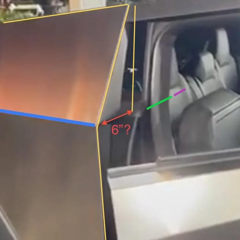

In the cast support going from the cabin rear to the wheel welI I think the casting is only maybe 1" thick with ribbing around 2-3", maybe max 4" in some areas. For such a short section with the dynamically load optimized shape, it won't need much material, nor will it want much material either to keep it easier to cast. The goal is to reduce the weight and materials and pieces used, and by doing so reduce the cost and speedup manufacturing, and improve tolerances. That cast probably has a mounting point for each additional part that goes into the rear. (for example to the left next to the red arrow is the mounting bracket for the vault cover rail)
Tesla Cybertruck Official Cybertruck Accessory store is live!! Includes: Tailgate ramp, Basecamp, wrap, franz ball decal and more CT Door Sail Thickness
As for total thickness at the door, if your measurement is correct and the door is 6" thick at that point, then the inside of the cabin door frame is another 6" (green line), and the inside setback of the midgate window roughly another 3" (pink line)? So 15"at the middle crease of the sail panel (blue line), but the wheel well inside the bed goes in another few inches, and there are hollow triangles in front of the wheel wells and under the diagonal truss coming from the cabin to the wheel, which is also where the well is it's widest. Don't get me wrong, I'm not saying there will 100's of litres of storage volume there, what I am saying is that there is 100's of litres of volume there, of which some, probably around 150l should become sail storage.
As I see it, after that initial 6”, you run into sail pillar casting - the depth of the door I see as unrelated to the depth of the sail pillar.
the sail casting near the tailgate may be thin, but near the cab the casting ‘fins’ are wide, maybe 3” thick. that is basically the entire thickness of the sail pillar near the cab/rear window. See also the photos below from the pre-production prototype with its rear window down/removed vs the casting photo (blue arrows)
