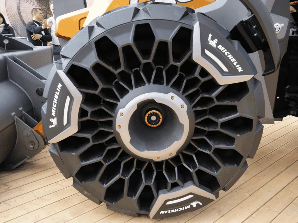

For almost all vehicles we still use a pneumatic inflated rubber tyre mounted on a wheel that then mounts onto a hub using threaded fasteners. Yet, Formula 1 and some other race cars have advanced hub/ wheel mounting systems, several of the worlds premiere tyre companies have air-less prototype tyre/ wheel systems (often protected by patents but I'm sure they would 'partner' with Tesla) and finally, we could have the opportunity to have the tyre/ wheel combo behave dynamically in response to the huge variety of load cases that they are subjected to.
For example the current prototype air-less wheels use internal structures to provide bump absorbtion whilst retaining lateral stiffness but I feel sure that Tesla engineers could develop that to include speed related fuctionality such as creating a smaller contact patch at higher (60 - 90mph) speeds to reduce friction but that would flatten back out instantaneously on braking. The moment you lift off the accelerator, the load map within the wheel/ tyre combo changes, even more so if you then apply a braking force. I recently watched a video suggesting using wider tyres on a Tesla MY to improve NVH - which had me attempting to think like Tesla!! (Youtube: The Automotive Fanatic, watch?v=szSAnY59A_Q)

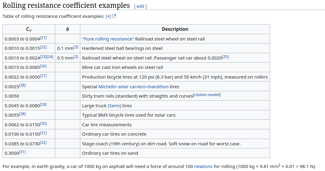

The issue is more the inflated tire against paved ( asphalt / concrete) road.
steel wheels on steel rails has some of the lowest rolling resistance possible that is why trains can be so efficient by weight on moving loads compared to trucks on paved roads.
Rolling resistance, sometimes called rolling friction or rolling drag, is the force resisting the motion when a body (such as a ball, tire, or wheel) rolls on a surface.
https://en.wikipedia.org/wiki/Rolling_resistance
Any coasting wheeled vehicle will gradually slow down due to rolling resistance including that of the bearings, but a train car with steel wheels running on steel rails will roll farther than a bus of the same mass with rubber tires running on tarmac/asphalt. Factors that contribute to rolling resistance are the (amount of) deformation of the wheels, the deformation of the roadbed surface, and movement below the surface. Additional contributing factors include wheel diameter,[3] load on wheel, surface adhesion, sliding, and relative micro-sliding between the surfaces of contact. The losses due to hysteresis also depend strongly on the material properties of the wheel or tire and the surface. For example, a rubber tire will have higher rolling resistance on a paved road than a steel railroad wheel on a steel rail. Also, sand on the ground will give more rolling resistance than concrete. Sole rolling resistance factor is not dependent on speed.

Tyre deformation, that is how much the tyre changes shape around the contact patch to the ground, is the primary cause of rolling resistance. Hence a steel train wheel on a steel rail has less such deformation and therefore less rolling resistance.
Airless tyres are predominantly a gimmick for off road use only where punctures are a problem. Anything caught in the side wall openings of those airless tyre will cause such a imbalance in the wheel at highway speeds that the vibrations would make it un-driveable.

I have only seen airless tires on bicycles and tractors, so nothing high speed.
