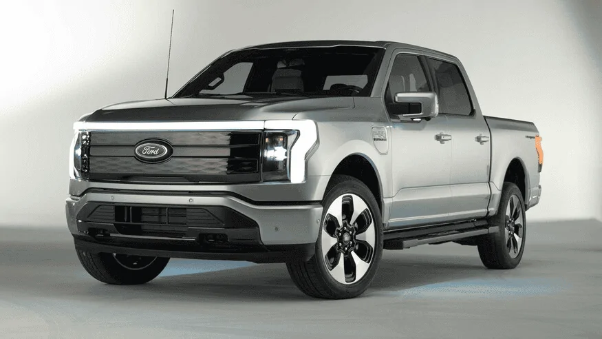

While there has been a few good ideas and points made in this discussion, I'll add a couple other things. I do think view augmentation cameras on trailers is a good idea, but you can't just ignore all the existing trailers previously manufactured or already being towed on the road. But if Tesla is thinking about that they will include such connectivity for those likely in a trailer umbilical connector design, or develop a wireless solution that could be portable to many existing trailers (notwithstanding security concerns). Tesla could easily integrate such cameras in their User Interface nicely, and likely they've been thinking along these lines while developing the Semi.
I'll note and remind here, that one of the Semi prototypes does (or at least did have) cameras instead of side mirrors, but they were on small 'Wings' (mounted to extend the cameras out a little) to assure the view coverage to the far back 'corners' of trailers. Because trailers can vary in width, something similar would likely be necessary on the Cybertruck if cameras are implemented as a side mirror replacement. The current lower side cameras in the CT are in the back of the front fender flare trim, so likely the rear fender flare trims would likely block some of the view from those cameras. Even if not, it's simply better to have the additional view angle toward the rear with a camera or mirror vantage point from an extended outward location at the proper height.
For aerodynamics concerns, I'm not sure what the range impact difference of extended wing cameras (or side mirrors) would be, but I don't see it being a major difference. The F-150 Lightening obviously has a lot more major aerodynamic drag than the CT with it's traditional truck body, but they are still getting Model 3 comparable range out of it apparently. So if the F-150 Lightening gets that kind of range against that sort of aerodynamic drag, the raw F150 electric drive train and battery pack must be doing fairly well. Ford doesn't seem to be as concerned about aerodynamic drag, as they have substantial side mirrors as well as a large vertical front face in their grill design:
So ultimately I think there needs to be some thorough range testing done on the CT both with and without side mirrors (or camera wings), and have those results published so we can all know the real percentage of drag impact from side mirrors or camera wings. We need to know what actual range impact differences we are really discussing. Meanwhile I think that a retractable, foldable, or some kind of telescoping mount for either might be a valid option, because while reduced drag is a real benefit to range, safety and convenience benefits of a better viewing angle toward the rear are also very real, when backing or towing a trailer.
I'm starting to think an interface point or connector for 'removable' camera wings or mirrors could also be an idea to implement, for those who are super concerned about the aerodynamics and appearance. One could simply snap in the camera wing or mirror whenever they tow a trailer or whenever they feel like it, or take them off if not desired or needed during a road trip for range. But that's likely a completely new category of safety options for NHTSA to consider.
