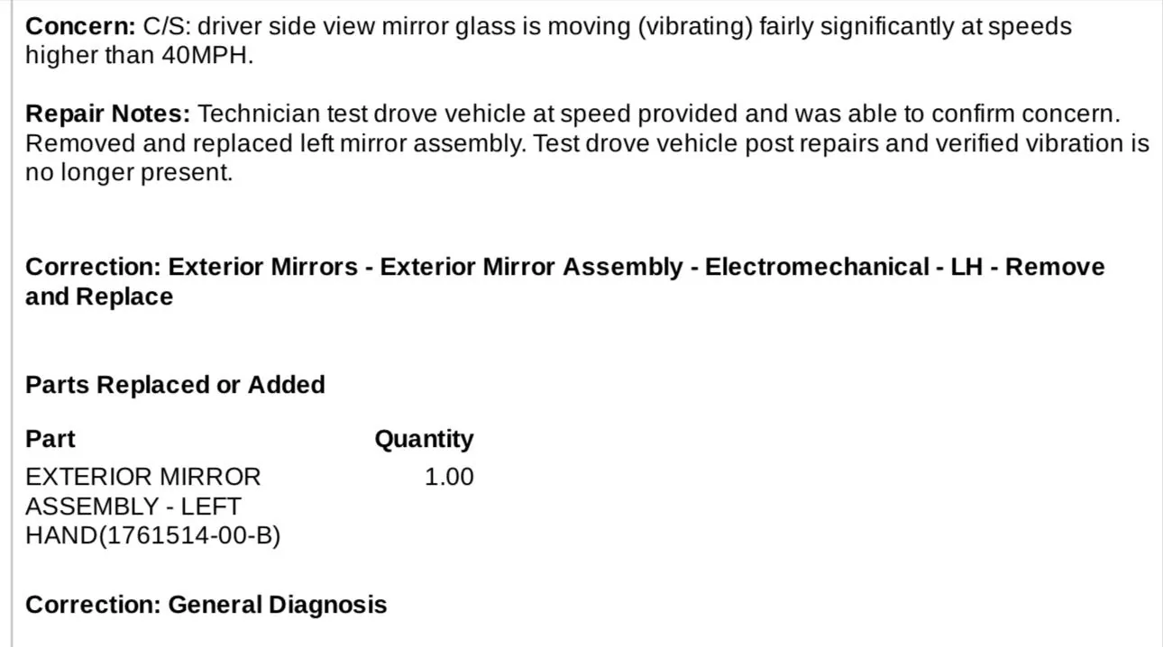

I have the same problem on my driver's side mirror while the passenger side mirror is stable. It's one of many items on the current list of service items.
I have a service ticket for same. Thankfully no other issues

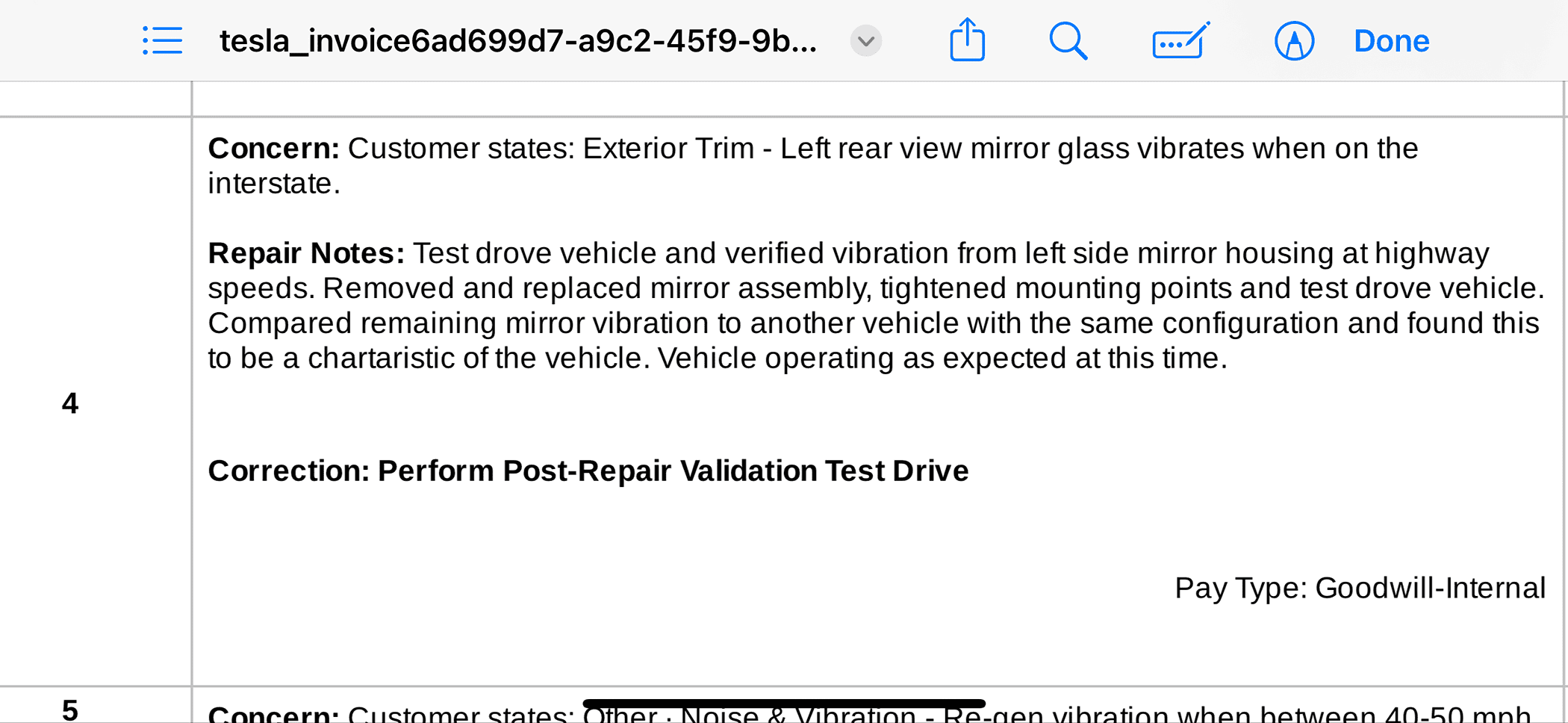

I have the same issue. Just got it back from service two days ago and they replaced the mirror assembly.
It’s slightly better but the glass still shakes/dances especially at higher speeds
Still not as stable as the passenger side.
Happens with or without music on so I don’t believe it’s vibration from the speakers.
