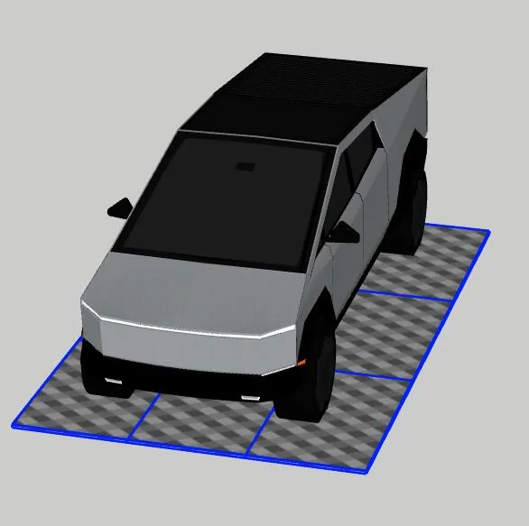

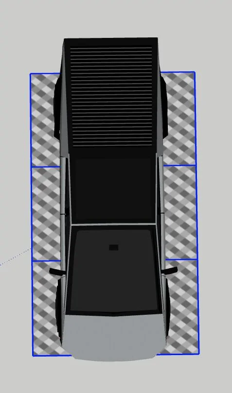

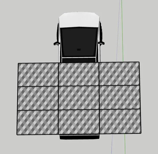

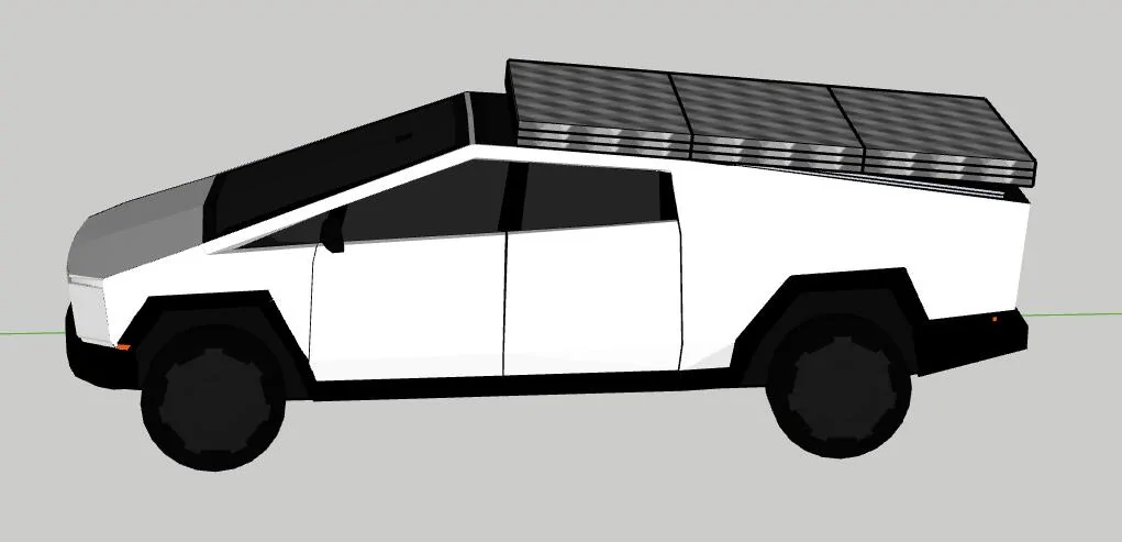

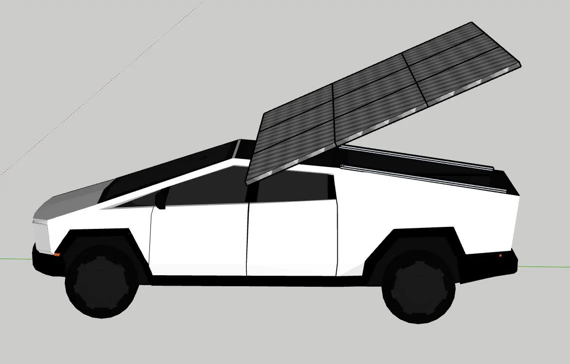

A 3kw solar array will be rather large. For example if you used 350w residential panels with decent efficiency. It would take up 9 panels, and around 10'x17.5', so just a little larger than the CT
Here is what that would look like:
Tesla Cybertruck Solar TriFold 3kwh? 1727130232138-i
Tesla Cybertruck Solar TriFold 3kwh? 1727130263620-z2

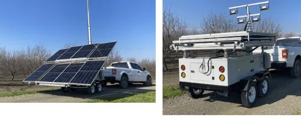

These guys have a pretty well packaged design that can fold away an 8 panel array. I bet you could DIY it with welding or bolting together parts from home depot if you were so inclined.
Tesla Cybertruck Solar TriFold 3kwh? 1727130687904-gt

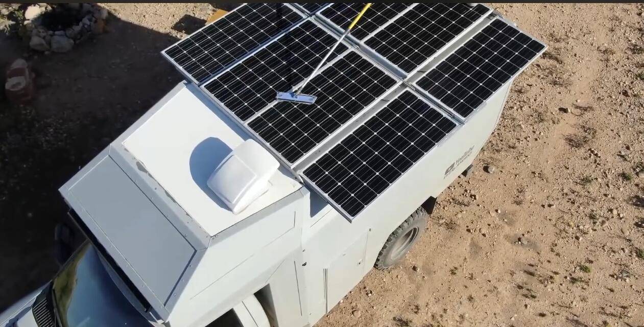

The most "simple" would be an awning style deployment that is popular. You stack them and just use heavy duty cabinet drawer sliders to extend them. Like this:
Tesla Cybertruck Solar TriFold 3kwh? 1727131062607-5w

If you were to rotate this design 90 degrees with a drawer design and mount just behind the apex of the truck then it would be accomplished. You would lose access to the tonnou and not able to see out of the top from the rear, but it would be aerodynamically sound with a wind break and would not protrude out of the sides or rear. 1Kwh in mobile form, 3kWh in stationary form.
Thanks for posting these visuals!

Here is roughly what that would look like. It would be heavy, but you could have it pivot in the front and make the bed into a clam style camper. That would also allow you to optimize the angle to the sun.

I have panels that are 8'x4' (825wh) & 8'x5' (1kwh) maybe can just go with 3 total if they were more custom sized panels?

Thanks for that, but this is a bit different. Assuming you're not coming back to a campsite more of a one way solution. This would be something that mounts directly on the truck and utilizes the roof mounts (8) and power jack top right (passenger side). The panels would be below the Apex on the back side so you could drive with them mounted and only have the other two come out when stationary (doubling as an awning).
