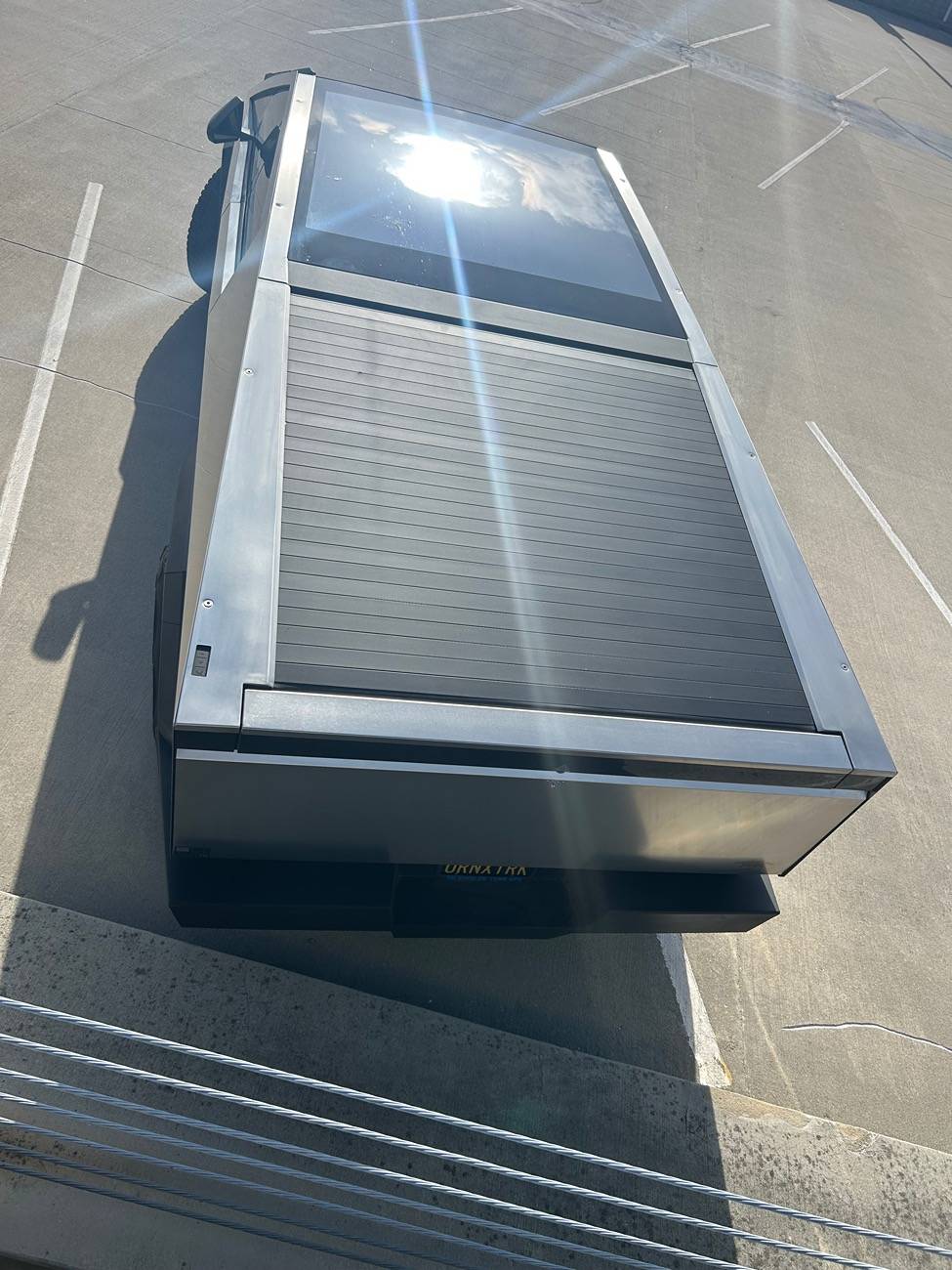

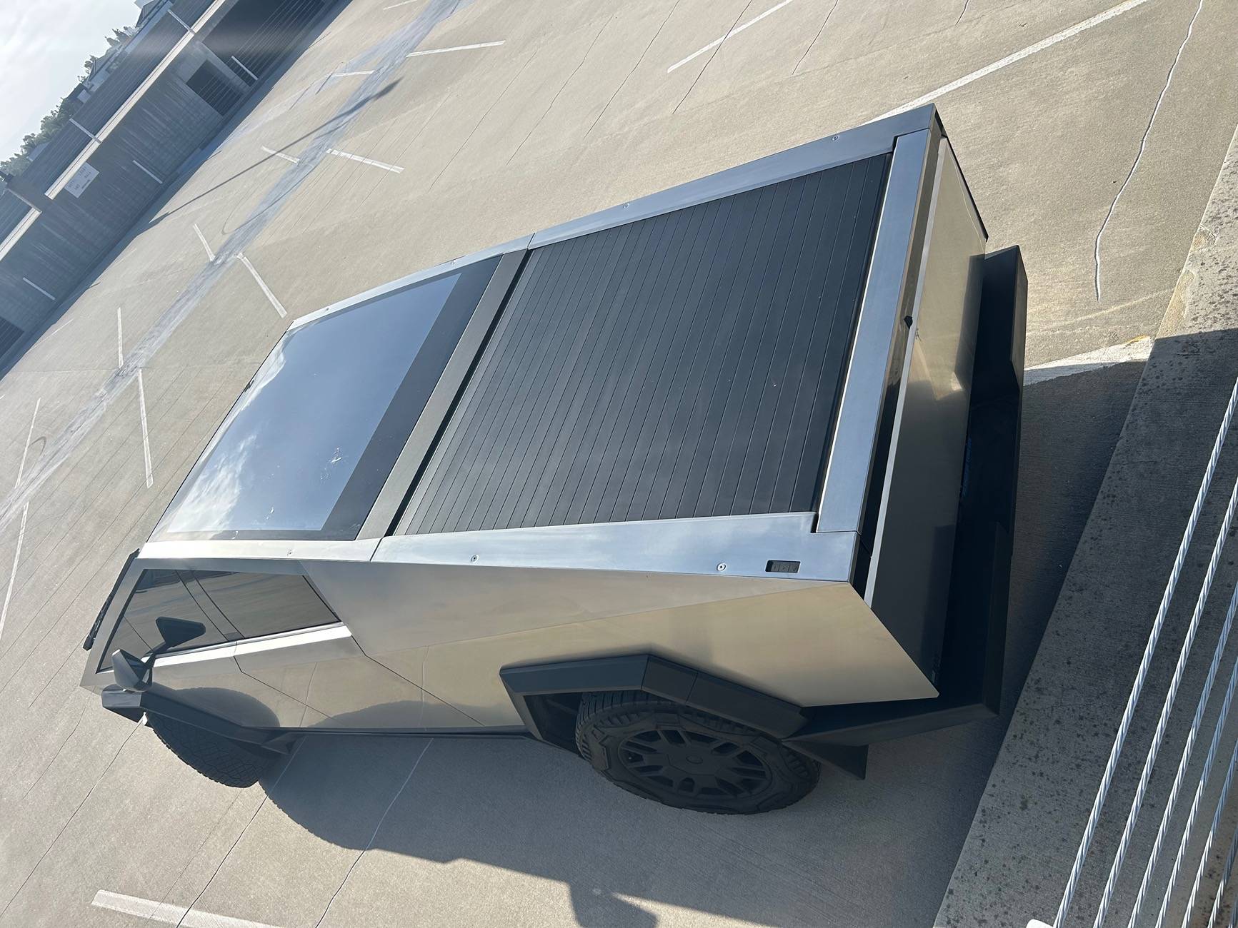

Looking good in the So Cal sunshine!

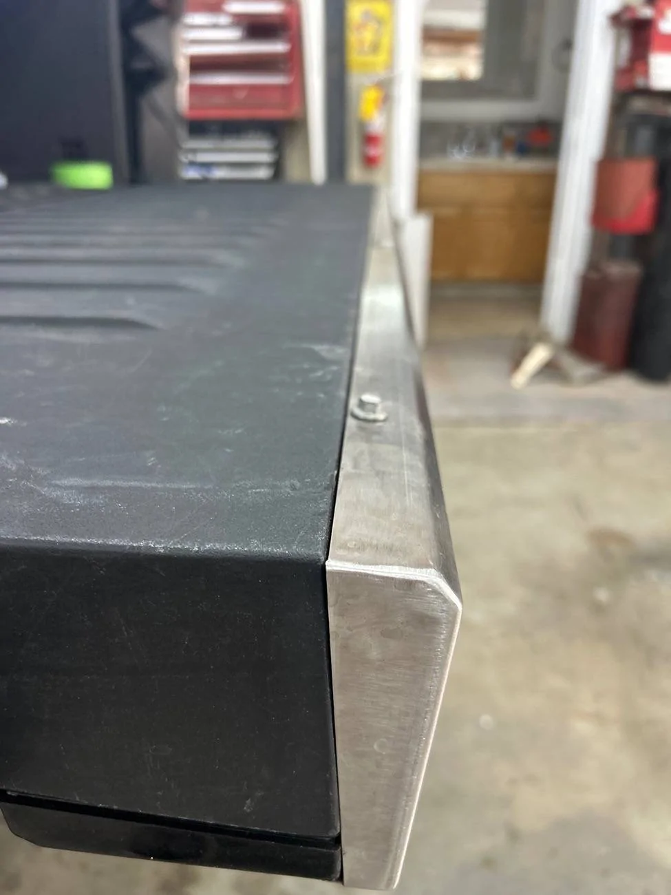

I like the tailgate cover….how does it attach?
Once you pry off the plastic one with a flat screwdriver you will find 4 Torx screws on the inner lip. Remove these and then bolt the cap on using the same holes. Ultimately we’re shooting for flush screws like the sail panels. For now I have my late prototype attached with bolts I had laying around from a Model S battery pack teardown, so original Tesla hardware Ha ha.

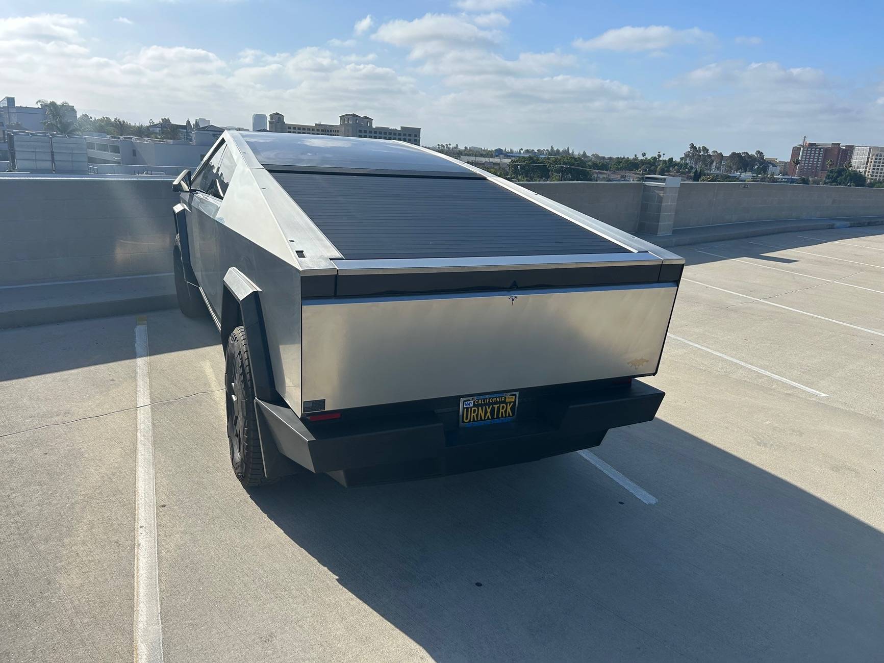

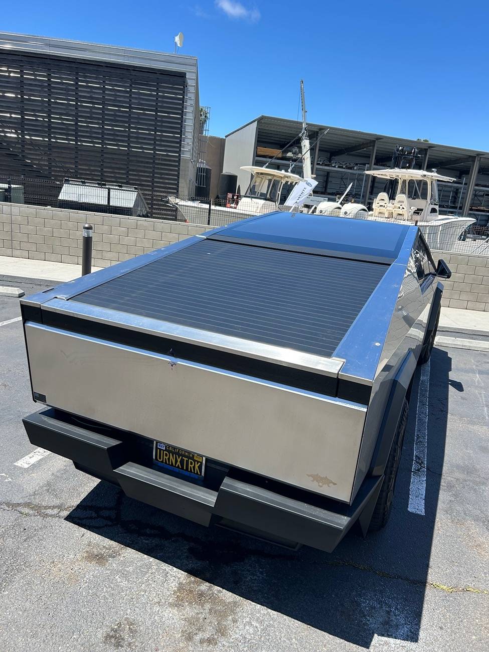

Man I’m loving the look… after driving around for months with everything torn up it’s so nice to see all the stainless around the bed… it’s beautiful!!!

Awesome video, side panels are pretty much up to full satisfaction for me, the tailgate cover absolutely needs recessed hardware, as is would not work for me at all.

Agree on tailgate hardware, shoulda waited til it was done to post the video. Couldn’t wait to share tho… Plus maybe a bit thicker backing spacer where the screw recesses are to prevent the bending I got from over tightening the bolts. Shipping will be just at cost, hard to know yet.

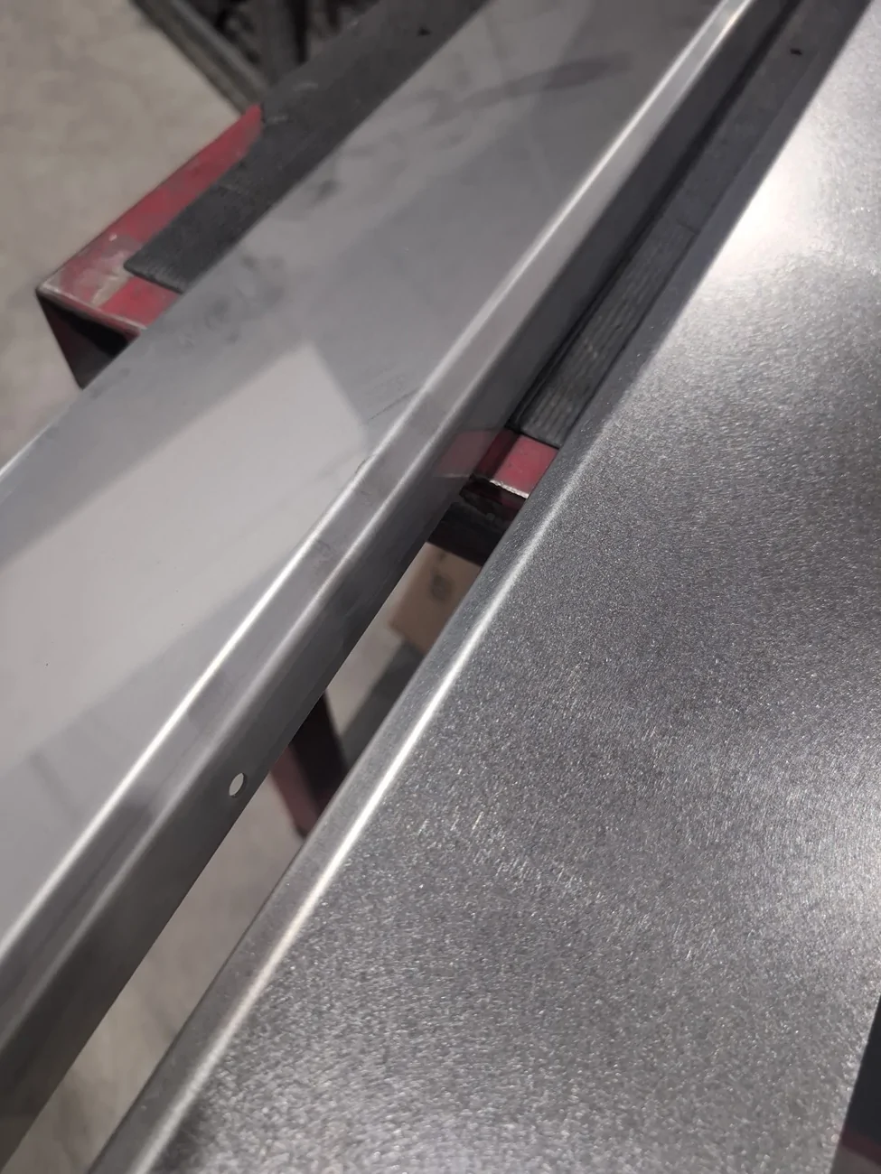

Jasper continues to upgrade his process. The latest run he used a protective rubber edge on the brake press to eliminate tool marks that he had to sand out.
