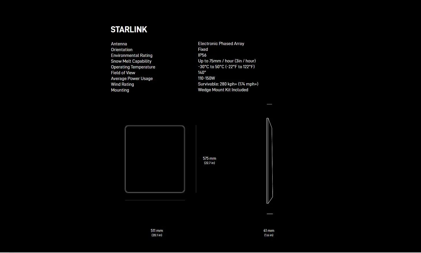

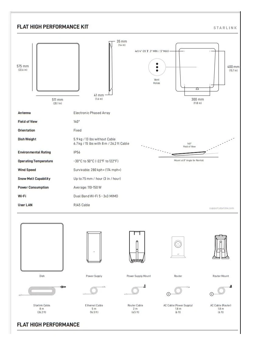

Flat phased array flat StarLink Antenna
called
Flat High-Performance Maritime Antenna
New
Just like 787 or 777 or F-35 have. Molded into the plastic hood or plastic trunk lid.
Simple invisible flat antenna.
Very very low cost phased array StarLink antenna molded into plastic trunk hood or fwd trunk lid.
CT StarLink Model 3ysxct
Phased array StarLink antenna molded inside a Black plastic fwd trunk lid would look good on a CT.
Now
If high enough production rate may replace all StarLink antenna
StarLink Home
Drive your StarLink Tesla home and just plug your StarLink Tesla into your home cable system and you now have home StarLink Tesla system for free.
Lets hope very soon:
Every Tesla with built in StarLink.
Tesla Cybertruck StarLink for CT Tesla Flat Phased Array Antenna5

If high enough production may replace all parabolic Starlink antenna
Starlink Home
Star link antennae are phased array but they only steer electronically in one direction.
Drive your Starlink Tesla home and just plug it in to your Tesla into your home cable system and you now have home Starlink system for free.
Works great if you park on your roof. Otherwise, not so great.
Every Tesla will soon have built in Starlink.
Gues that depends on how you define "soon".
