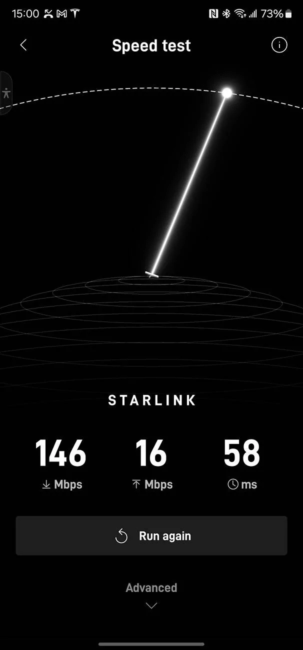

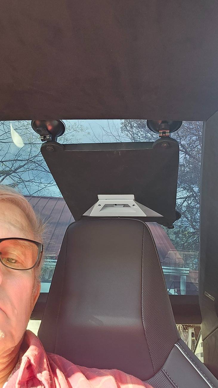

I was able to put it in the back seat stuck to the glass roof just behind the driver. Bought a 10' Starlink to usb-c cable and power it off of one of the back seat usb-c jacks in the center console. Easy, secure, turns on/off with the truck.
The wire just drapes down and coils up in the seat back pocket of the driver's seat. Then the other end comes out of the pocket and plugs into the rear center console jack.
I still have to figure out how to have it ON when I'm outside the truck. Just haven't had the time...
The pic on upload/download readings is from just sitting in a parking lot.
The new pricing plan @ $10/mo for 10gb make it reasonable to not have to pause/unpause all the time.

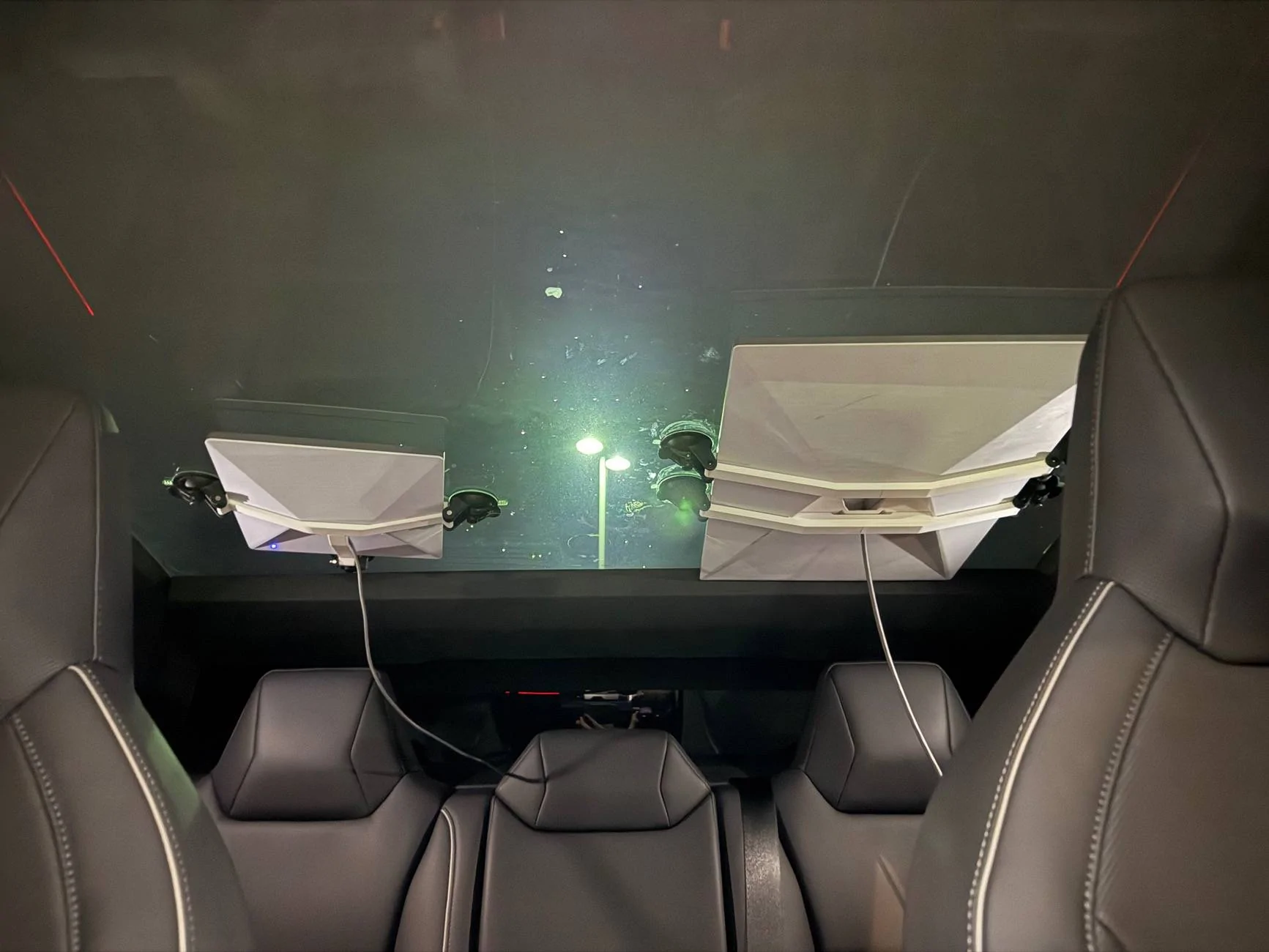

Here’s a suction cup mount I designed for the Starlink Mini. We use really strong suction cups with a bit of adhesive on the back for extra hold, but the best part is how easy it is to use.
A lot of other mounts make you take the whole thing off just to remove your Starlink, but ours stays put—you can just pop the Mini in and out whenever you need. It’s been super handy on trips where I use it in the Cybertruck for the drive, then take it with me when I stop to hike or camp.
If you’ve been looking for a no-hassle way to mount your Mini, you can check it out here: https://contronx.com
Happy to answer any questions!
