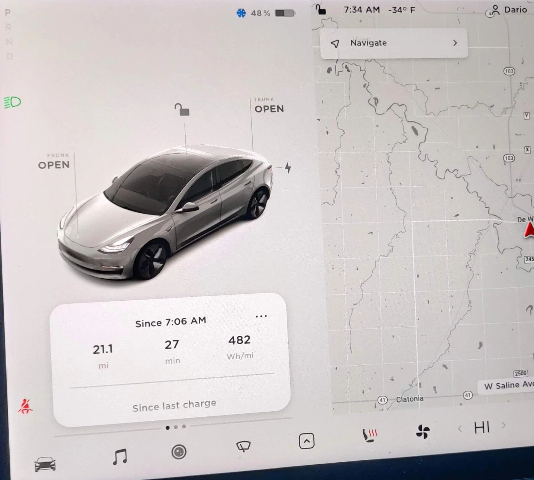

Actually just found a picture I took after that drive, when I arrived home and parked in the garage. You can see that the temperature reading inside the garage was -34°F and that my energy consumption for the drive was actually much higher than I remembered. It was actually 482 Wh/mi. That's pretty high, but not surprising for the extreme temps (at least for me). My average energy consumption for winter is between 296-304 Wh/mi (I keep track of average energy consumption when I switch between my winter and all-season tires).
