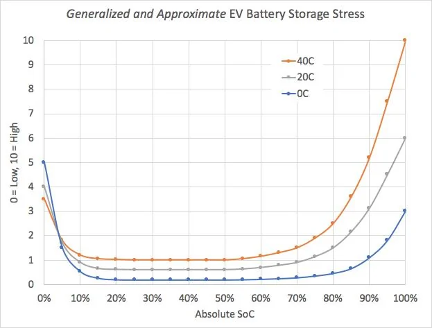

Colder is better. But you still want to stay around 30-40% SOC.
