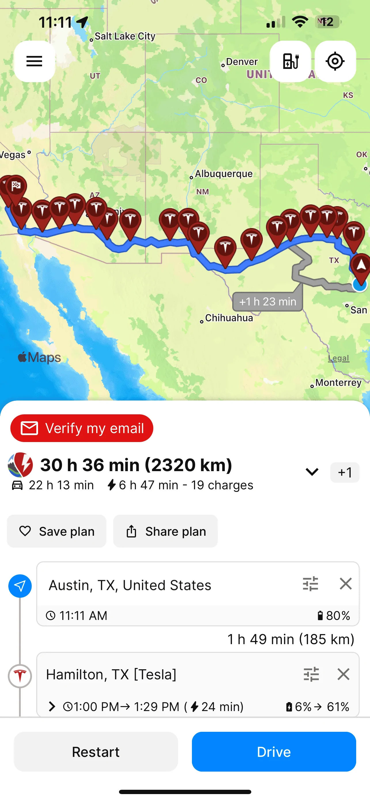

Thatā€™s exactly what the route planner comparison is saying.
itā€™s an interesting exercise for sure
Iā€™m curious what you used for these sorts of settings?
Tesla Cybertruck Taking the CYBERTRUCK on a MASSIVE ROADTRIP | Charging was TOUGH 3FBFC715-6EEC-440F-B607-DD7788D63B8C

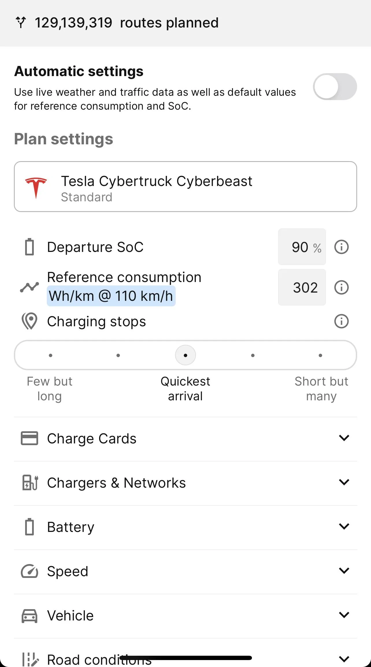

because the default in ABRP appeared to have been ~3.1mi/kWh @ 68mph, which seems materially over expectations/reason

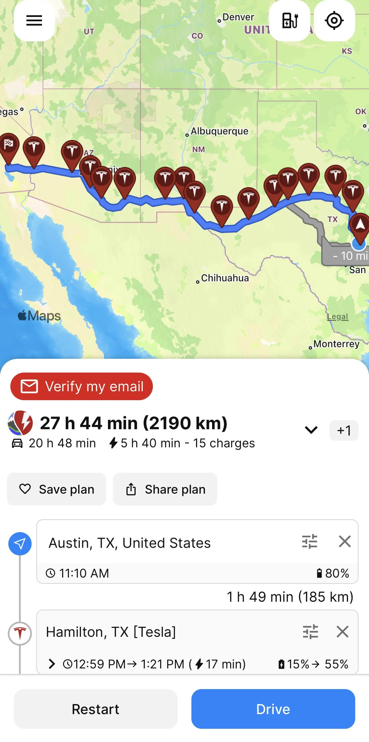

I adjusted to first 2.4mi/kWh (in a beast) with 68mph thmax
Tesla Cybertruck Taking the CYBERTRUCK on a MASSIVE ROADTRIP | Charging was TOUGH 182E9BC1-3858-454A-8208-359DA5E250D9
then 2.1mi/kWh still @68mph
Tesla Cybertruck Taking the CYBERTRUCK on a MASSIVE ROADTRIP | Charging was TOUGH A6F51923-AE61-4655-88A5-1B993601C791
Others are likely more agile with ABRP to start to dial in ABRPā€™s current ā€˜alphaā€™ assumptions instead to a range reflecting the ā€˜real worldā€™ data coming in - from optimistic to pessimistic

ABRP was not used to generate the Cybertruck route plan above. The Cybertruck route plan is a ā€œreal worldā€ example, generated at the beginning of a road trip using the in-vehicle route planner. The results were shown in the video in post #2 in this thread.
So the assumptions for the CT route plan are those made by Teslaā€™s own software. I have no idea what those are, but I assume that Tesla has a good understanding of the CTā€™s capabilities and limitations.
I only used ABRP to generate a Model Y LR route plan for comparison, using the default settings. I assume ABRP is reasonably well calibrated for MYs at this point.
I wouldnā€™t trust ABRP for the Cybertruck, at least not yet.
