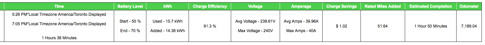

I have a similar but slightly off topic question for Tesla Owners.
When I drive to visit friends and family I may need to plug in at their house. Specifically I plan on doing this when visiting my parents house 290 miles from my house. My question is, does a Tesla give a reading of TOTAL energy consumed during a charge? Total being the energy that was put into the battery, plus any energy used for battery heating/cooling, plus any energy used for preconditioning the passenger area, plus whatever losses the car can detect? I want to be able to say, "Hey dad, I just took 238kWh from you. You're electricity rate is 14.5¢ /kWh so your electric bill will be about $35 dollars higher than normal. Here's $40."
Yes, the car does measure input energy as well as the energy that actually gets delivered to the battery. But it does not, AFAIK, display total input on any of the vehicle's displays. The information is available through an API, however. TeslaFi is one app that gets it and sends you an e-mail with the info you want after each charge:
Tesla Cybertruck Telling vehicle when / how much to charge ChgRpt
Not only do you get the e-mail but the charge gets logged on their server so that you can go back and find out how much you charged at your parents house after you get home thus, perhaps, avoiding the sort of discussions you mentioned in another post. If you can get their account number you can probably send a check to their account directly to the power company.
TeslaFi does not only record charges but all the details of your driving too. You will probably want if for those reasons as well as this particular problem.
iYou will find over the course of 24 hrs that the car may charge 2% a couple of times during the day to to make up for "phantom drain" which, amon other things, includes the power used to send the charge reports and other data to TeslaFi.
If you precondition the car I believe it takes the energy directly from shore power rather than from the battery and this doesn't get recorded. I, for one, will give you full credit for just reimbursing for what TeslaFi will catch but there are solutions that catch every Wh going to the car. Several of the wall chargers do this and there are separate power consumption meters that do this too. I haven;t found one that plugs into a 14-50R but there are several that install current transformers in the panel and report out through WiFi or direct internet connection. I use eGauge for this but it would definitely be overkill to install an eGauge to monitor one circuit. If, OTOH, your parents wanted to monitor in detail how they use electricity this is an excellent system.
