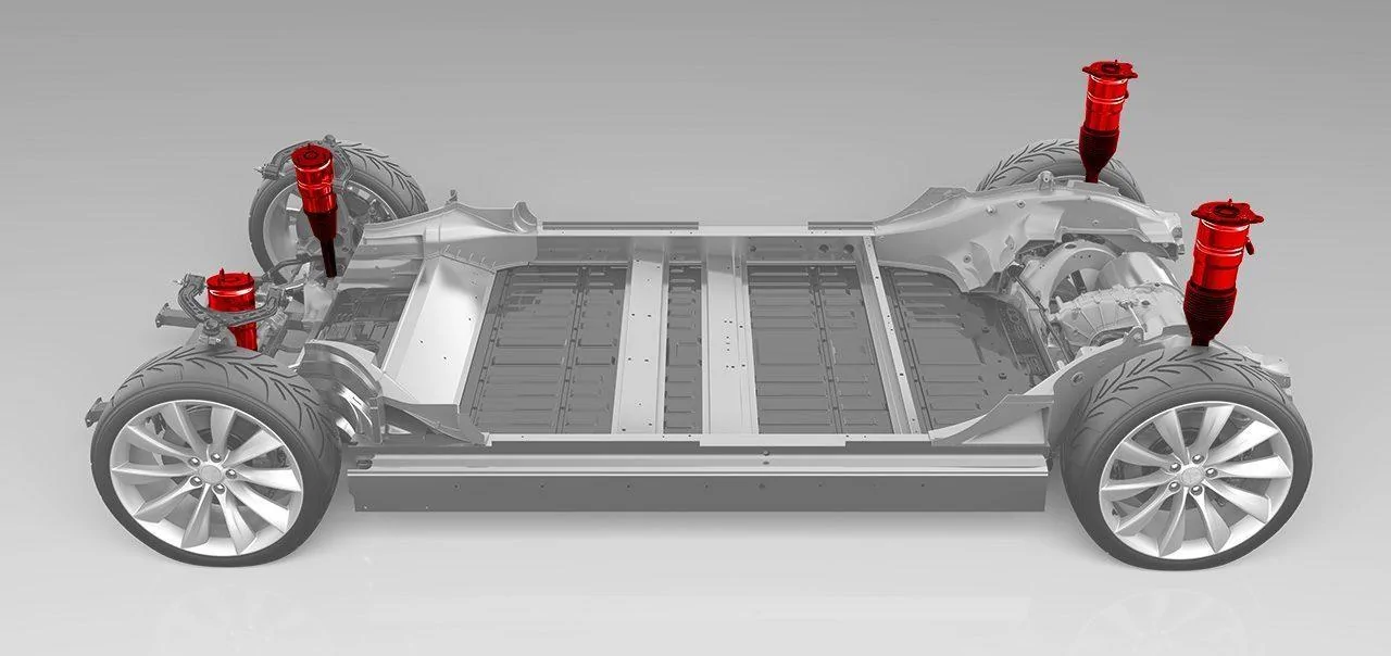

Tesla is recalling almost all Model S/Model X sent to China over suspension issue
Tesla is issuing a recall on close to 30,000 Model S and Model X vehicles made for the China market, with the bulk of those models already exported to the country, over an issue with its suspension.

The problem is being described as a weakness in the Model S and Model X suspension that can lead to a cracked linkage after an impact.Part of the imported Model S and Model X vehicles with a production date between September 17, 2013 and August 16, 2017 will be recalled, a total of 29,193 vehicles.
Here Tesla describes the problem with the front suspension (translated from Chinese):
But according to the report, there’s also a similar problem with the rear suspension, and some vehicles in the recall are affected by both.When some vehicles within the scope of this recall are subjected to a large external impact, the ball studs of the rear connecting rod of the front suspension will have an initial crack. When the vehicle continues to be used, the crack may extend and cause the ball stud to break. In extreme cases, the ball-end cone seat may come out of the steering knuckle, affecting the control of the vehicle, increasing the risk of accidents, and posing safety hazards.
The problem with the rear suspension is described (translated from Chinese):
According to the recall, Tesla is going to have to replace the “front suspension rear link and the rear suspension upper link” for free for the affected owners.When some vehicles within the scope of this recall are subjected to a large external impact, the upper connecting rod of the rear suspension may be deformed. When the vehicle is continued to be used, the component will be further weakened. In extreme cases, it may break and affect the control of the vehicle. Increase the risk of accidents, and there are potential safety hazards.
Tesla Beijing is going to notify all affected owners that they can still drive their vehicles, although carefully, until they have changed the parts.
