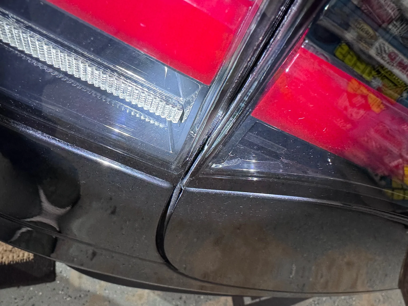

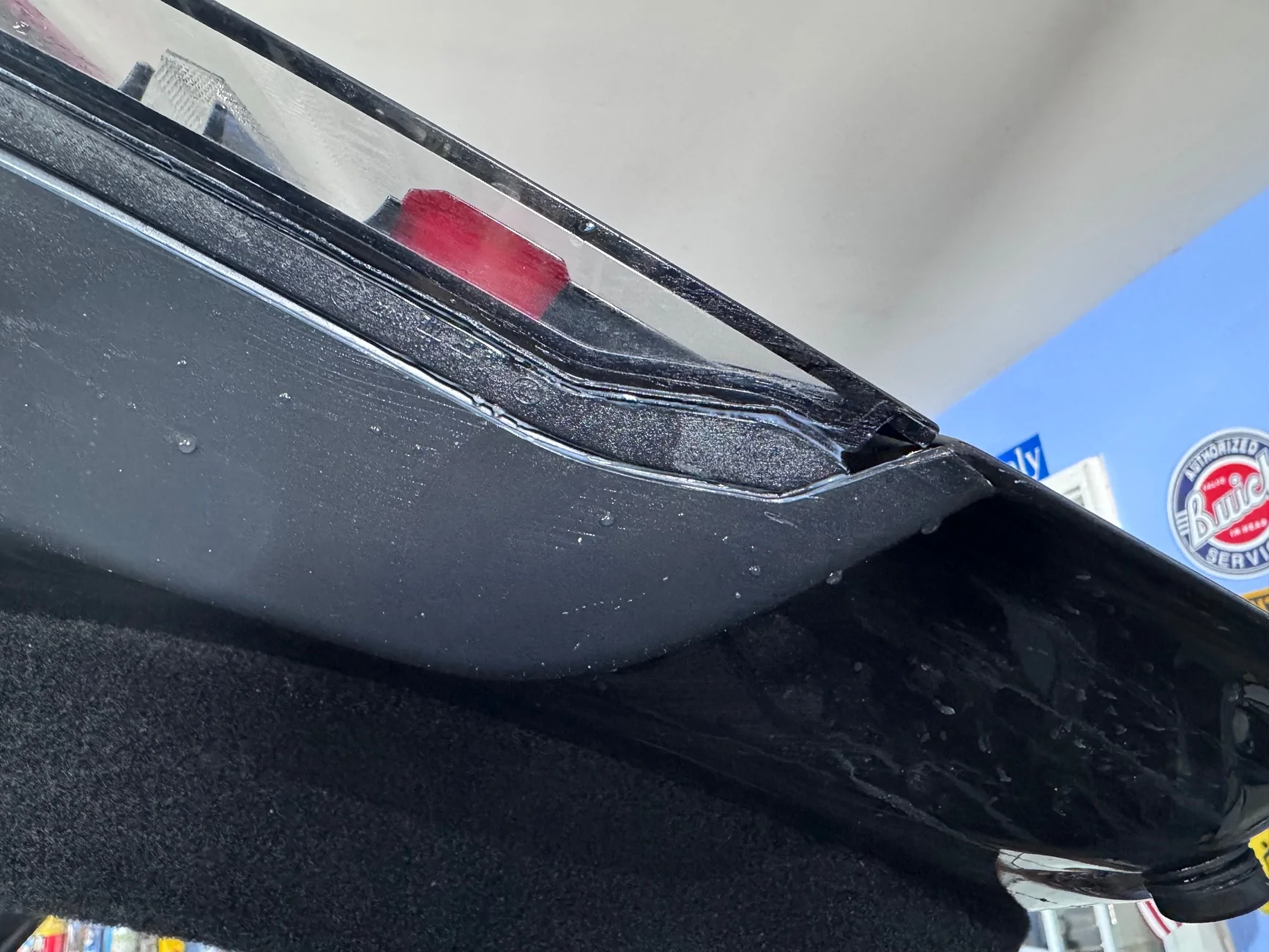

Annoyingly, it only gets worse, I got service on the wife’s model X yesterday for a tailgate making noise from contact between the lights and shortly after I got home I realized that their tech slathered grease on the entire side of the light…investigating further, the lights are still touching. I contacted whom I think may be the GM and she appears to be content with that repair.

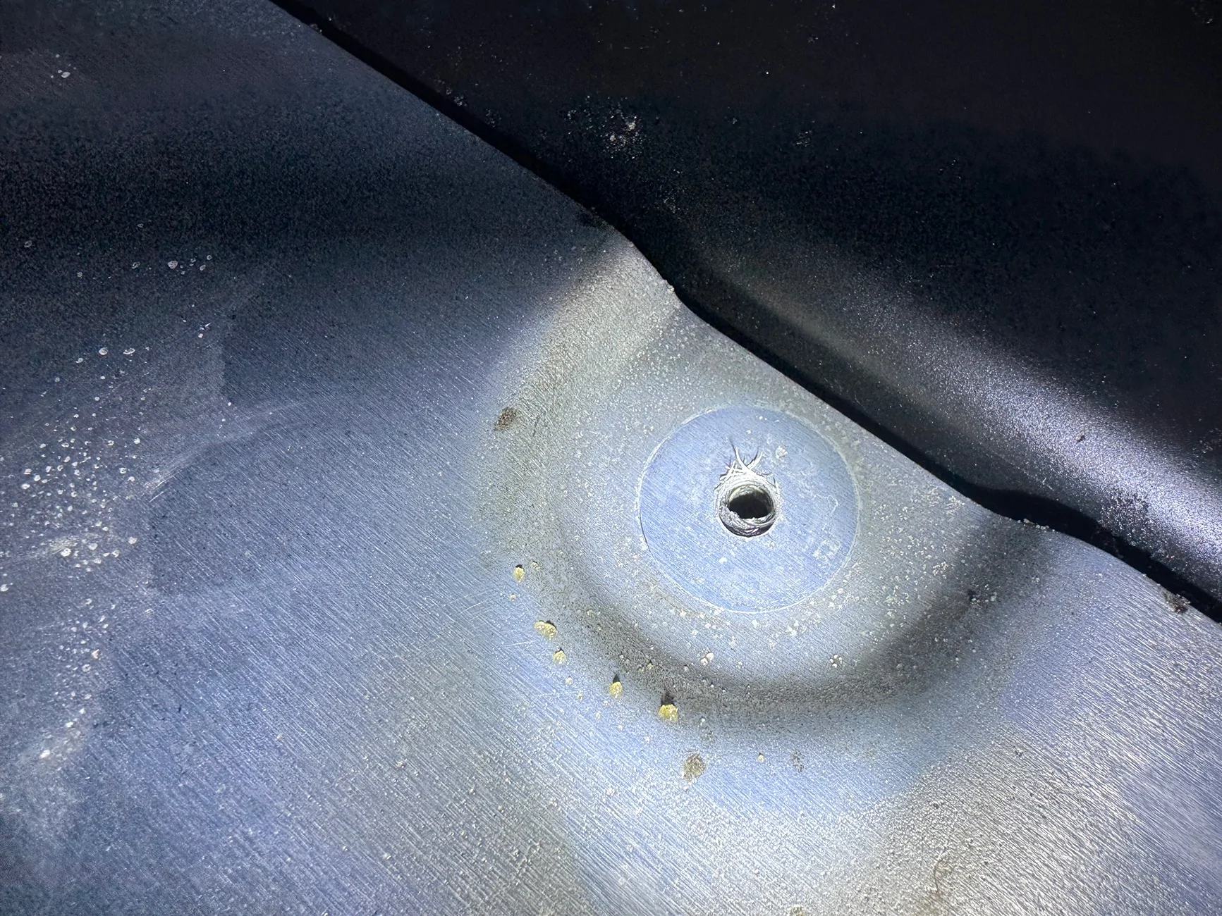

Then I got under my truck to try and figure out if I have an active leak or just residue oil from a sloppy job (it made a small puddle the first day, I am not getting low fluid or service alerts but I do have a new whirling sound above 40 sustained speed) and also found a missing/stripped bolt on the skid plate.
I am not asking for anything extra, I just want this fixed.
