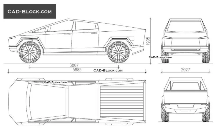

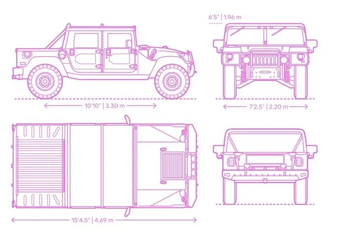

Oh, one other issue. I decided to look up the H1 dimensions and they really aren’t that close to the CT. Even if Elon shrinks everything by 3%, the CT will be a whole meter longer with 0.4m longer wheelbase , meaning on average 0.3m or 1’ longer overhangs at each end. That is going to give much worse approach (37° vs 72°), break-over (CT not published) and departure (28° vs 37°) angles so CT won’t be able to do all that fancy stuff in your Hummer montage.
For reference, Raptor has 30.2° and 23.1° approach and departure, Rubicon has 42.2° and 32.5°, so the CT is about half way in between with 37° and 28°. I’m totally fine with the CT being the same size as a Raptor with better geometry, even if the geometry isn’t as good as a Rubicon or H1.
You acknowledged that the CT is never going to be as good at technical rock-crawling so we’re on the same page there. I just think it’s wrong to equate the CT to the H1 just because the clearance is the same.

I’m good with something halfway between a raptor and a hummer. Thanks for the correction.

Keep the body length but shorten the wheelbase, it's TOO far apart, leads to tracking issues / poor turning radius, High Centering on rocks and ridges not fun.
