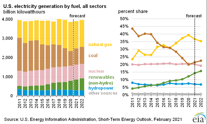

The grid in the US is still dominated by coal / fossil fuels but that appears to be changing. Renewables are definitely altering the landscape. The government is also aggressively subsidizing renewables and will most likely ramp up more heavily in the future with the Biden administration calling the shots. Most projections show semi-linear growth of renewables into the near future (2040ish). I don't think it will be a true S curve, but linear seems a little slow to my mind. Time will tell.

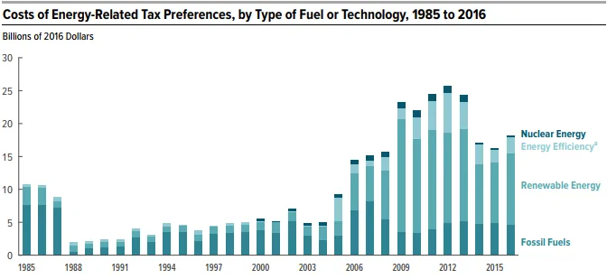

Below is an interesting chart that shows the U.S. subsidy resource allocation matrix. I definitely understand why the 5 billion is still spent on subsidizing fossil fuels, would just be nice to see those funds spent on a more forward looking basis. It's cliche to say "just follow the money", but in this case I think it's clear that renewables are going to be a growing part of the energy infrastructure.
" A 2017 study by the consulting firm Management Information Services, Inc. (MISI)[54] estimated the total historical federal subsidies for various energy sources over the years 1950–2016. The study found that oil, natural gas, and coal received $414 billion, $140 billion, and $112 billion (2015 dollars) "

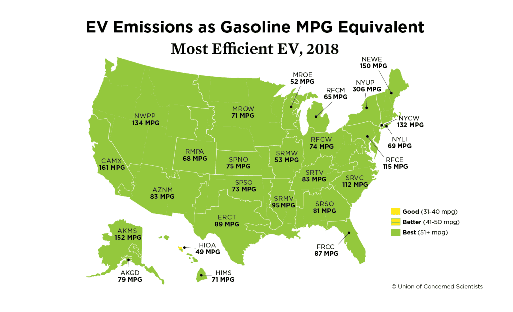

A note about the picture from @SSonnentag from https://blog.ucsusa.org/dave-reichm...s-really-better-for-the-climate-yes-heres-why :
MPGe is a standard made by a bureaucrat. Don't get me wrong, some (very little) amount of bureaucracy is necessary but this was the EPA trying to compare ICE to EV with physics. The way the epa does it (MPGe, the thing on the sticker of the car) is not the way that the authors do it (mpg equivalent) or necessarily how the next person does it. I personally think the blog does a great job explaining all the different factors that go into the calculation so I'll end here.
