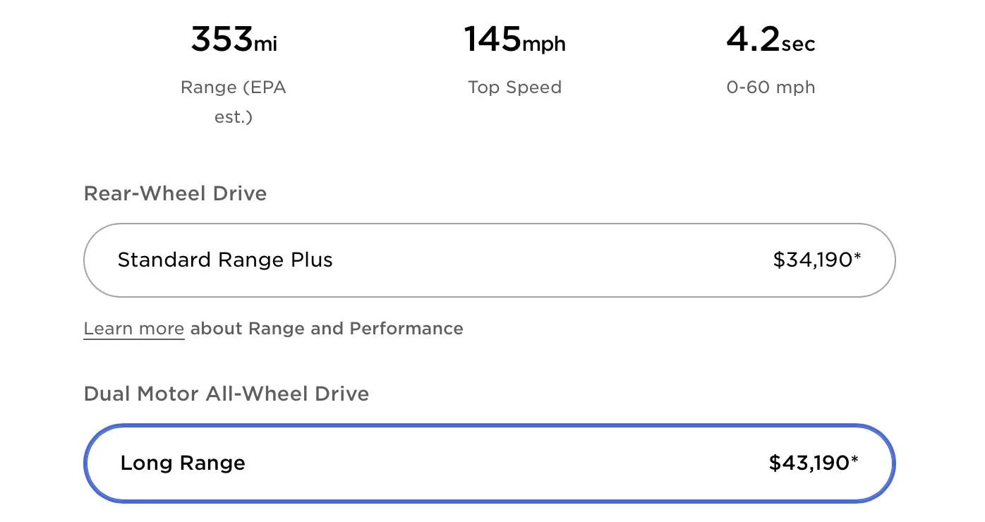

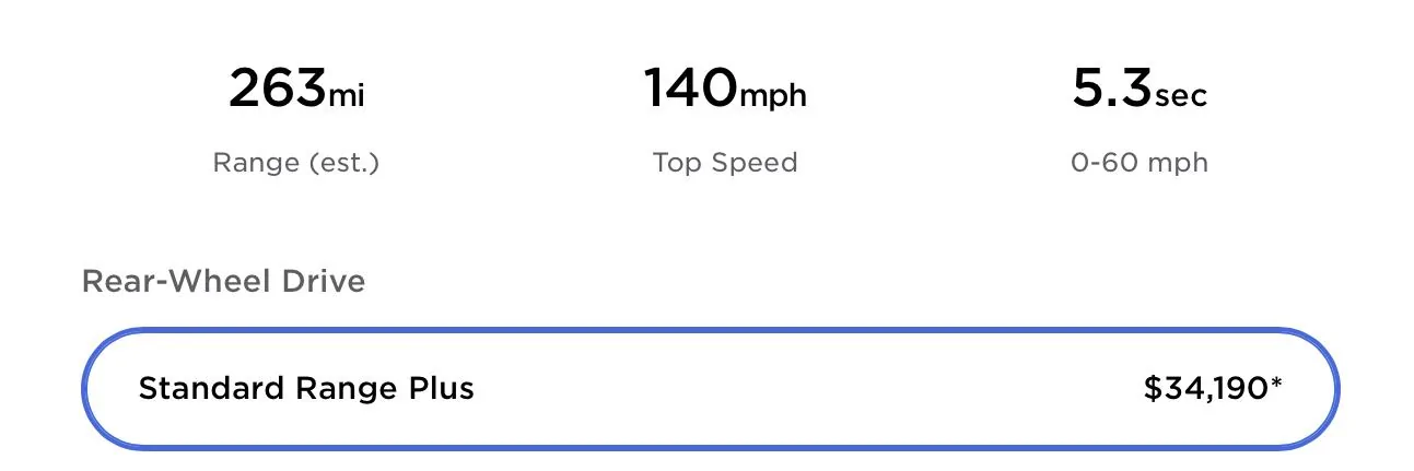

I don't know what the rated consumption for the 3 is so I'll have to WAG it at 240 Wh/mi. I don't know what the CT's consumption is either but it is thought that it will be around 450 Wh/mi. Thus for a 100 mile trip on level road I'd guess the 3 would use 24 kWh and the CT 45 kWh.
Ouch, I didn't think I would take that much of a hit driving slow in the back roads. I am sure I will see real world numbers by the time it is my turn.
It's a substantially bigger vehicle. It only stands to reason that it is going to take more energy to move it, that it is going to take longer to charge it and that energy is going to cost more. On a range basis though we have twice the consumption but twice the battery. 100 miles will be 20% of the CT's range. OTOH on a 3 LR+ it is 28% of the battery. So from that perspective you are better off with the CT.
