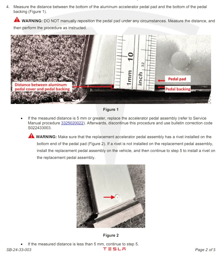

Oh and I got the rivet installed in my pedal at Cybertruck Takeover an it does not look like it’s installed in the proper place. The guy said they are all like this but later at home I saw that mine was the only one on right on the edge. I’ve added this to my service ticket as well.

I'm not in front of my truck right now to double check, but that rivet looks like it's doing the opposite of what it's supposed to be doing. The pedal cover is lifted above where it should be, and the rivet is preventing it from going down into the proper place.

It does look too low in comparison

Whoever installed that rivet should not be working as a mechanic. The rivet is in the correct place but your cover has already begun to slide up the pedal. According to the service bulletin, your pedal should have been replaced, but if they had just pushed the cover back down before riveting, it would be OK. Here's the pertinent part of the bulletin, your cover is way over 5mm from the bottom of the pedal. If I were you, I'd try to slide the cover off then stick some grip tape on the plastic pedal until it can be replaced.
