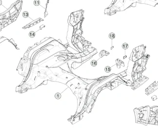

Casting did not "snap in half", the back two rails broke where the hitch/bumper assembly attach.
the whole casting assembly:
Tesla Cybertruck The TRUTH About Cybertruck Frame / Hitch Snapping In Half! (Bearded Tesla rebuts WhistlinDiesel) 1722895761482-vl
It's by design that they break off cleaning at those sections.
They have talked about the casting designed to break off in sections from the main for energy dissipation and to protect the larger casting:

Tesla diagram posted by @Kahpernicus is very informative.
