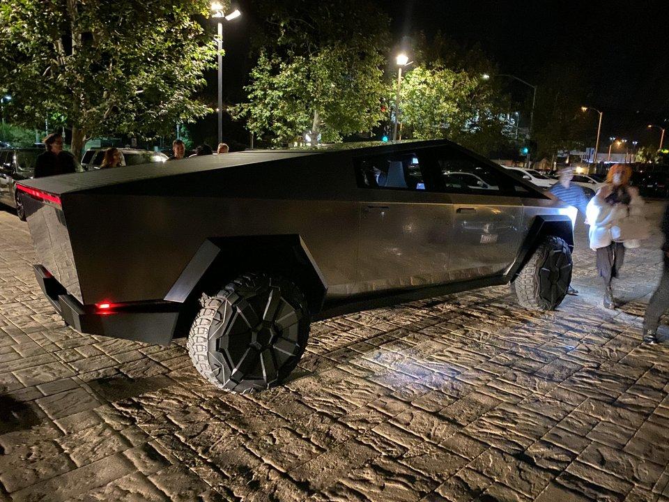

Here’s a look at, in my opinion, the stainless steel finish on the CT that we’ve seen.
This piece is 2B finished stainless steel and is what I think the current CT is made of. This very smooth and therefore reflective, but its not ‘shiny’. The surface does show scuffs and scratches. These cannot be removed. You cannot "correct" this finish.

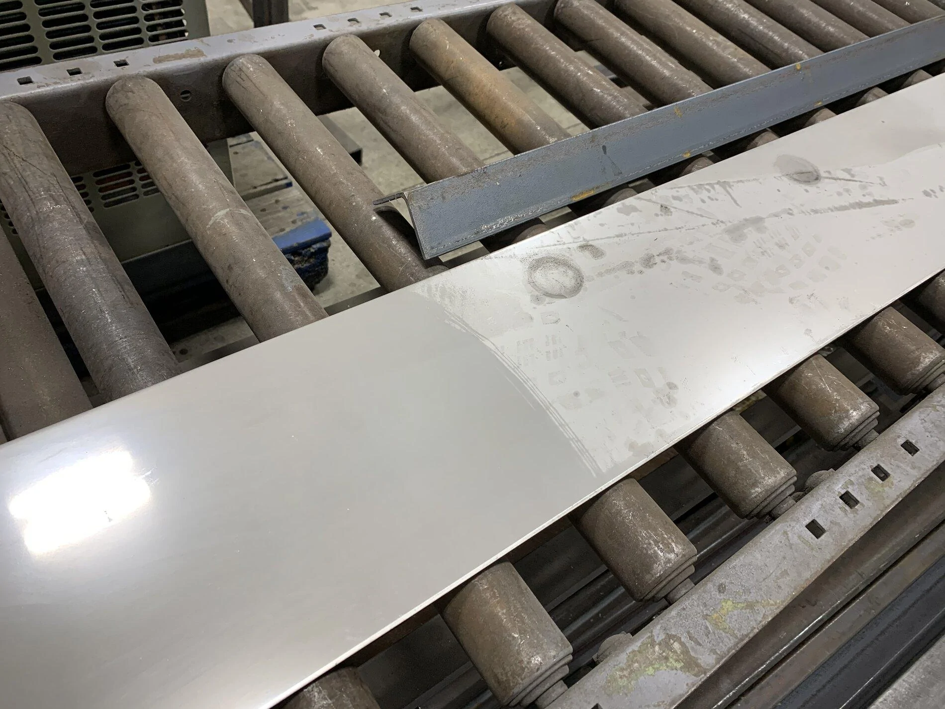

Here’s the same piece, one end cleaned with parts wash and the other right off the truck.

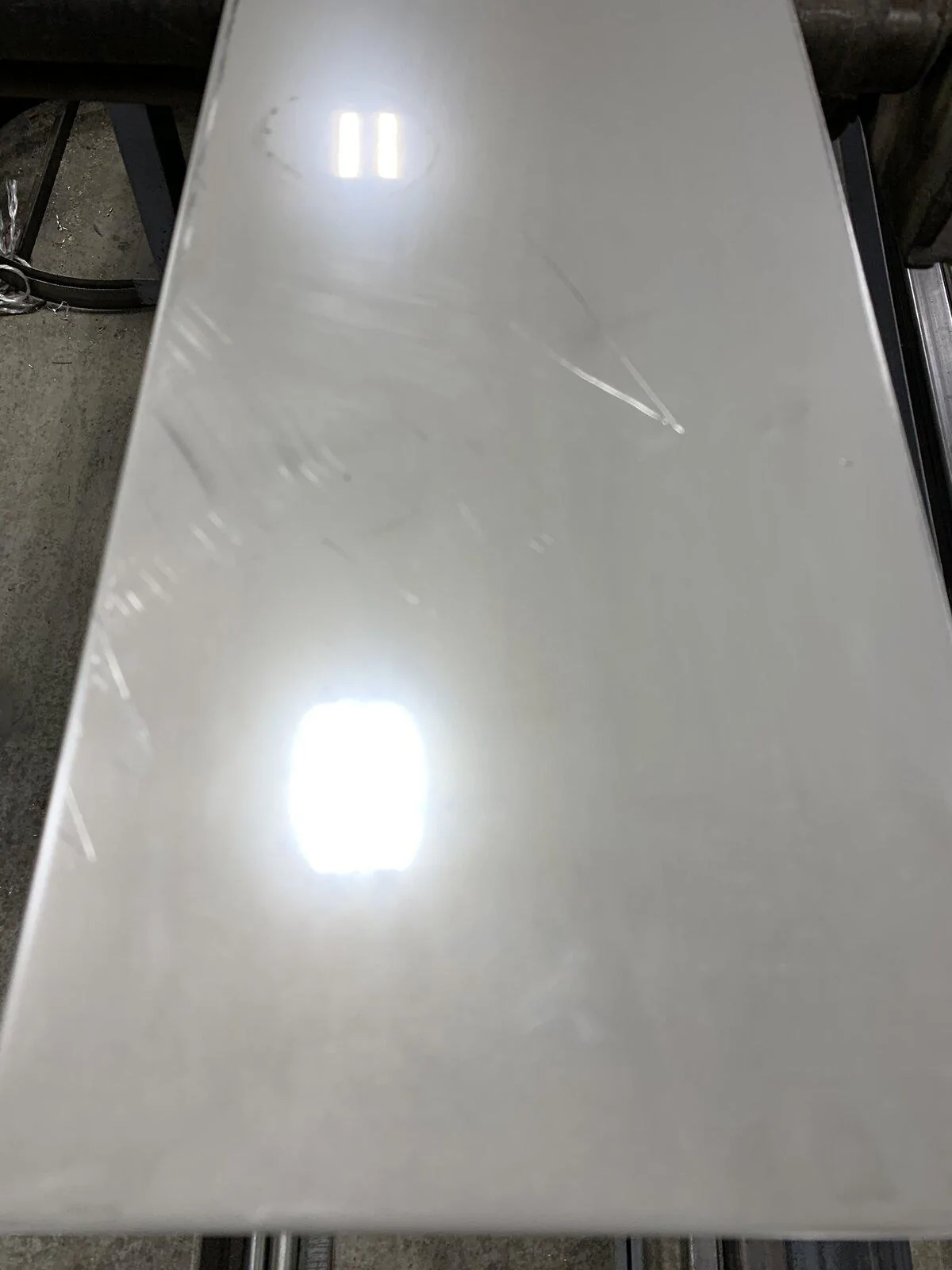

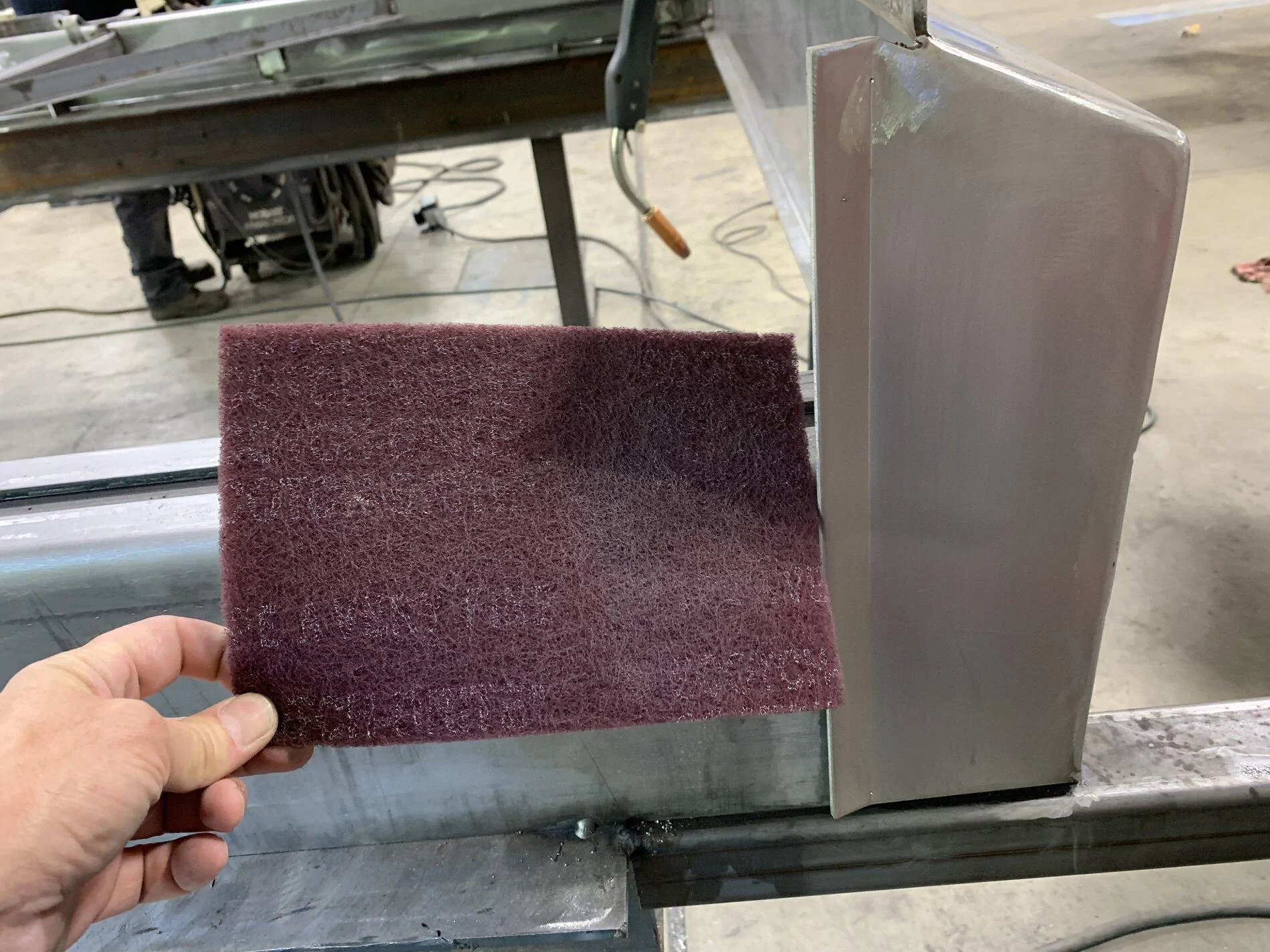

The picture below is the 2B finished SS that I used a 3M brown pad to scuff up, like a Delorean would need. This will "remove" scuffs and scratches by, well, putting other scuffs over ones you don't want. If you rub back and forth in a straight line, it will look uniform.

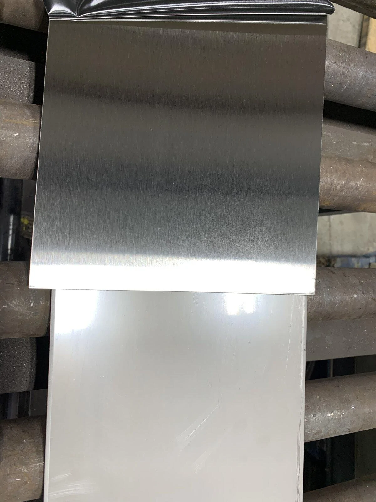

Here’s a piece of 4B brushed stainless steel. It comes from the factory "brushed". It also has a protective film that protect the finish. The film is removed after you make your parts with it.

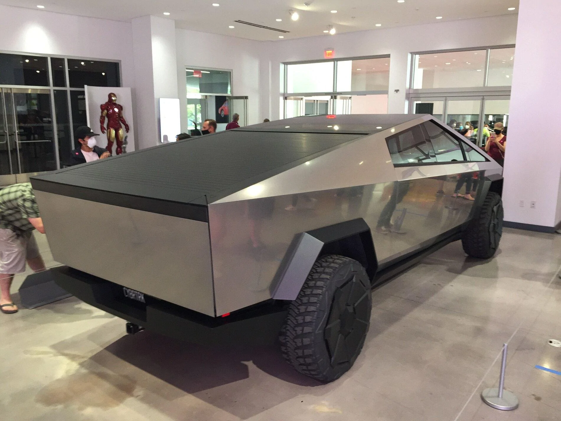

Well, we don't really know what flavor of stainless steel the CT will end up being. I'm sure it'll be Space X "seconds", material that for some reason failed xray QC for a space ship but is more that adequate for a truck. Because of the that, it'll be the same material used in the Space X ships. More economy of scale.
I don't know if 304 will resist scuffing and scratches any differently as, say, 316 or the Space X flavor of SS, but I'm sure it'll have very similar characteristics.
And I agree, the CT pictured is most certainly 2B stainless.

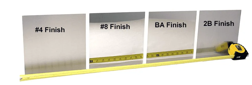

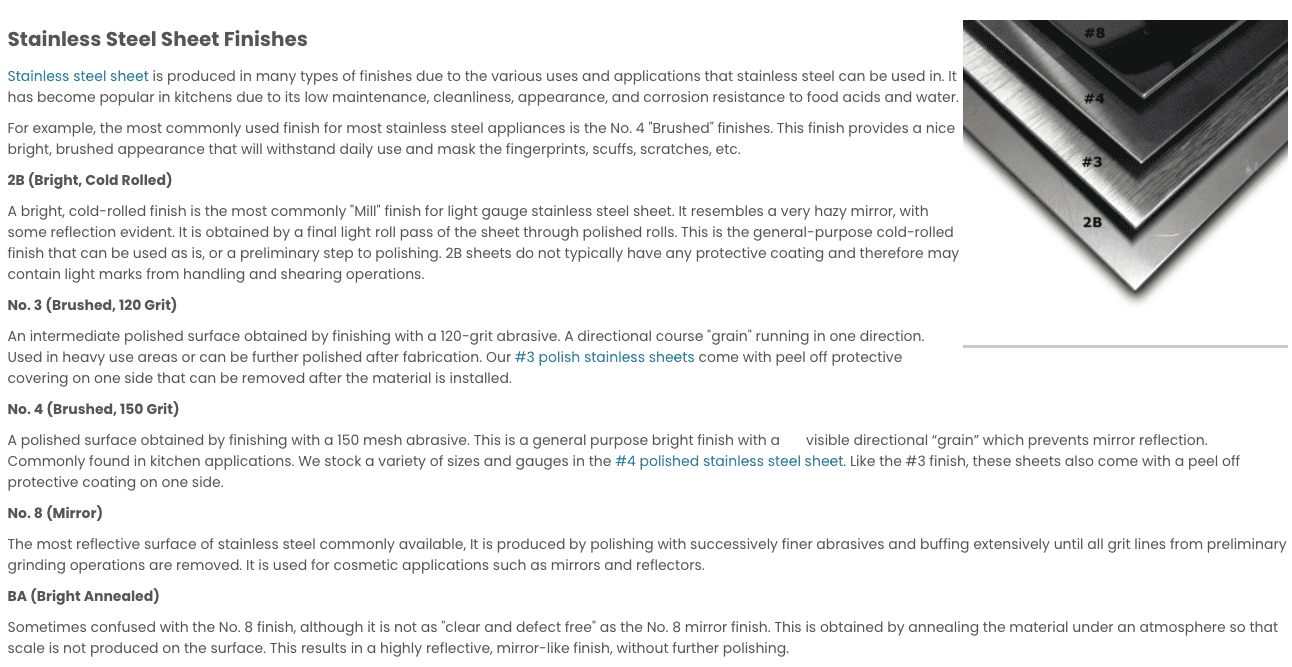

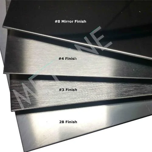

I wish Tesla would manufacture the Cybertruck in the #4 finish instead of the 2B. It would give the SS a much better appearance. If you placed two Cybertruck side my side, one in #4 and the other in 2B, I feel the vast majority of buyers would choose the #4 stainless finish.
