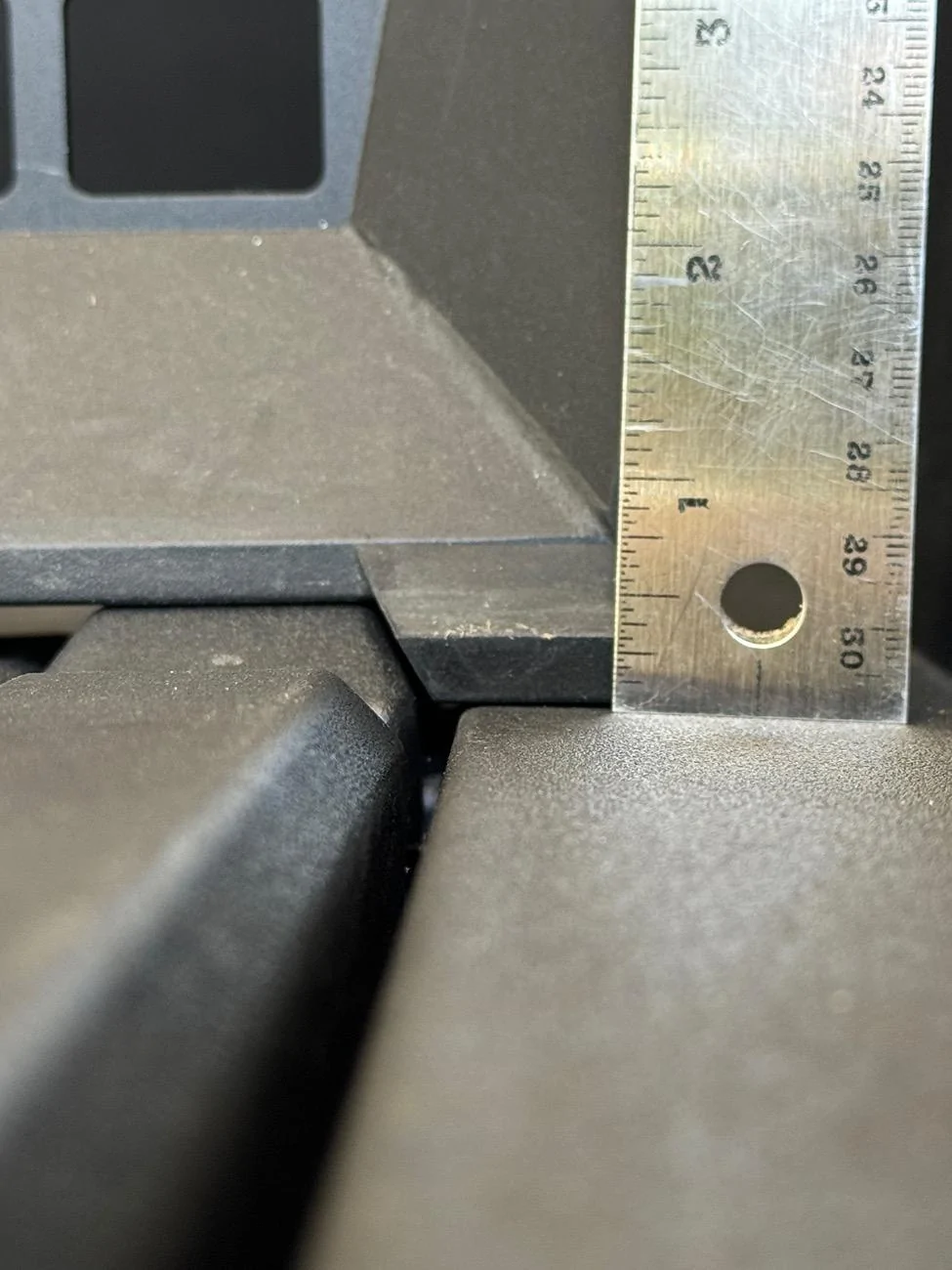

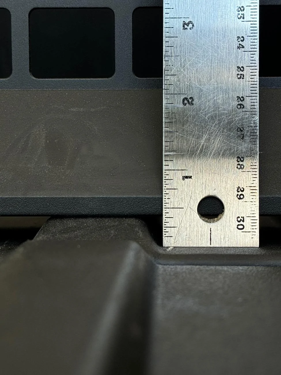

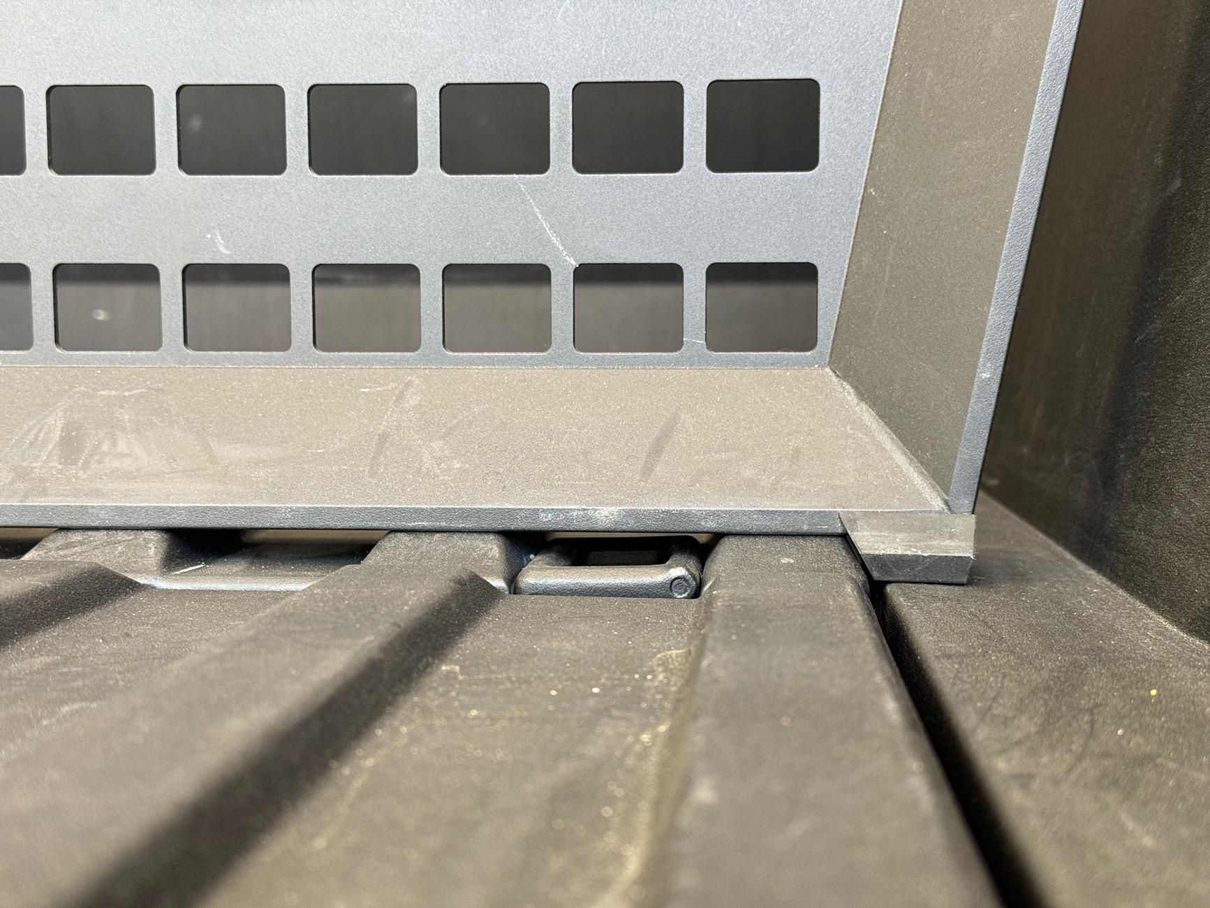

Mine isn't bowed up but the bed (front and rear) is about 5mm too high for the divider to work as-is. Had to remove both feet and do Mark Z's modification to get it to fit. Even then it takes some effort. The divider now rests firmly across the tops of all the ribs when I manage to get it in place. So before cutting your bedliner make sure the tops of the ribs aren't the limiting dimension.
