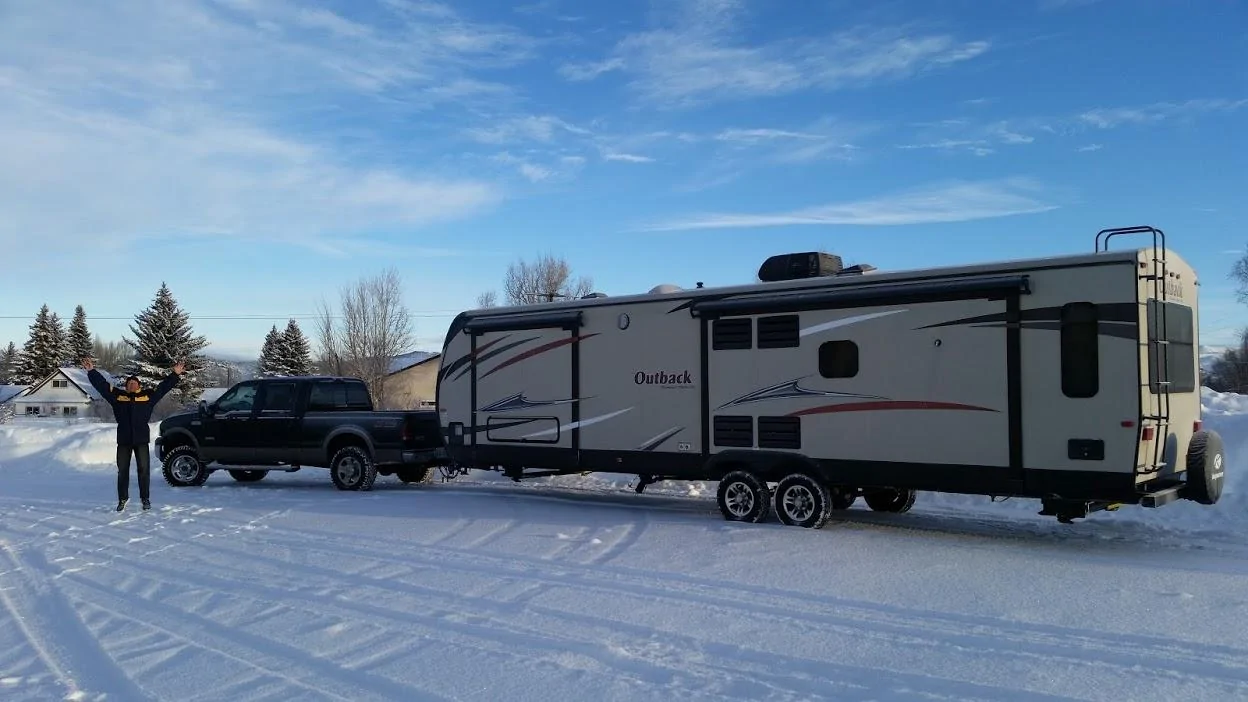

I am wondering, when pulling my 37 ft travel trailer and need to pull in to a charging station, do I have to unhook my CT? I can hardly imagine, having the CT and trailer sitting at a charging station for an extended amount of time.
Unless, Tesla is designing some "trailer friendly" stations, meaning, I can leave my trailer hooked to the CT while charging. That, of course, would be ideal. Your thoughts, please...
