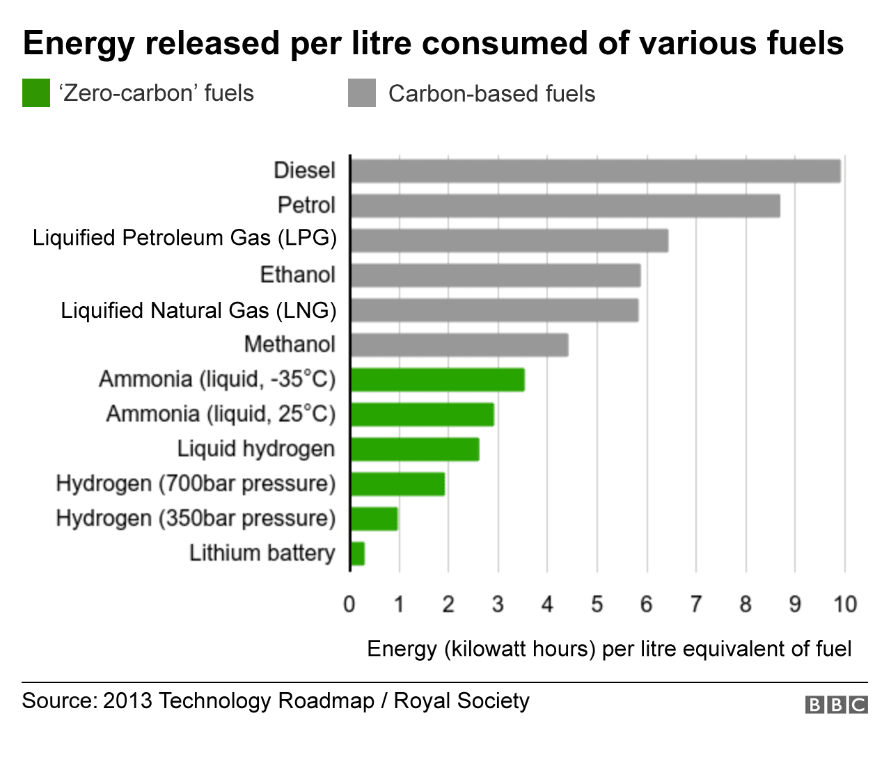

I really hope that the Tesla development team realizes that 150mi range is not enough when you're planning to pull a travel trailer over long distances, and that they develop a solution that allows adding a secondary battery.
This secondary battery could be a CT custom battery pack that, I guess, would fit in the CT bed (due to size), and that you can rent when you need it. It does not really need to be developed by Tesla, but they would need to provide an interface for it, from the truck bed.

That chart is... Weird at best, since it seems to be saying kWh and that's... Not how that works at all. How you extract the energy matters, so really you end up with a range, and the theoretical maximum for gasoline is ~33.5 kWh, not 8.75.
