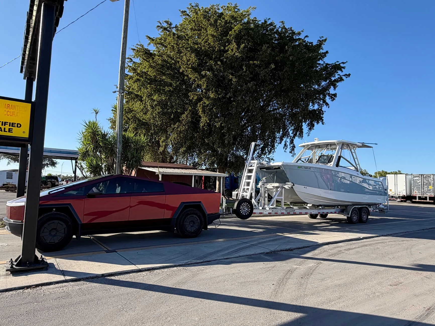

Tesla Cybertruck Towing my boat 400 miles. zimage13023

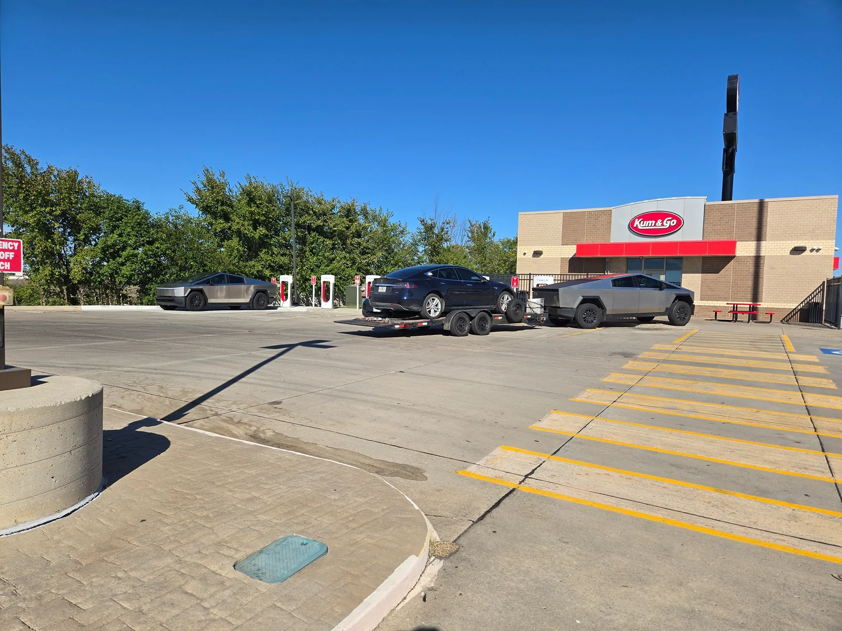

Tesla Cybertruck Towing my boat 400 miles. 20240920_161609

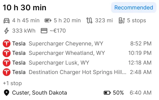

Tesla Cybertruck Towing my boat 400 miles. IMG_0237
