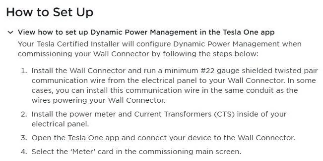

The free UWC is slightly different than the one you ordered. It allows for charging TESLA NACS as well as J1773 that other cars have. Might be useful if friends or family are visiting. It also is wired with a communications wire that allows the gateway to tell the truck to turn on when the gateway senses a power outage....then the truck can power your house.
Has anyone found any reference in a manual / webpage / etc for this communication wire? I can't find any references / desc / spec on it. Confusing based on the below.
UPDATE:
Past/old -- I found this text on this *cached* page where it *mentions* the 'communication wire':
https://webcache.googleusercontent....port/charging/wall-connector/power-management
Tesla Cybertruck Universal Wall Connector vs Tesla Wall Connector? CHVRR0E

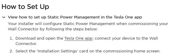

Current/Now from where it does NOT *mention* the 'communication wire':
https://www.tesla.com/support/charging/wall-connector/power-management
it shows:
Tesla Cybertruck Universal Wall Connector vs Tesla Wall Connector? hd7jDK7
