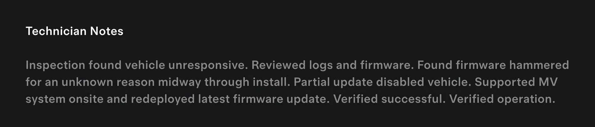

As the title says. Installed 2024.45.25.5 and the truck went unresponsive.
So just be aware of this when you press to update.

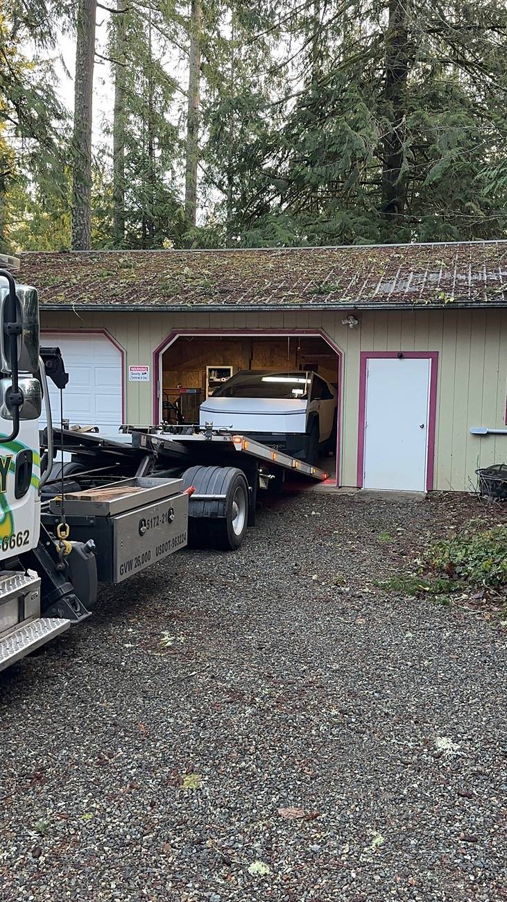

I am also in the same boat as you. I updated and it bricked Sunday morning. Waiting for the mobile tech tomorrow to get it powered so that I can unplug it from my wall charger. They couldn’t tow because the tow truck driver couldn’t get the 48v powered to unplug.

I guess the official term is hammered. The service center fixed it in about an hour.

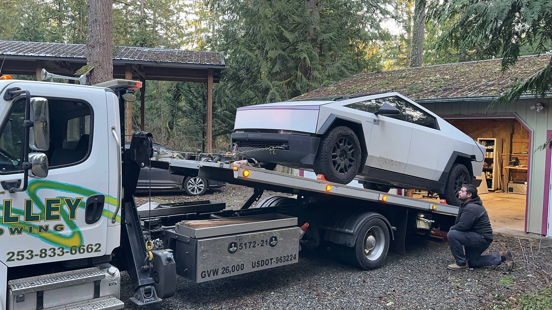

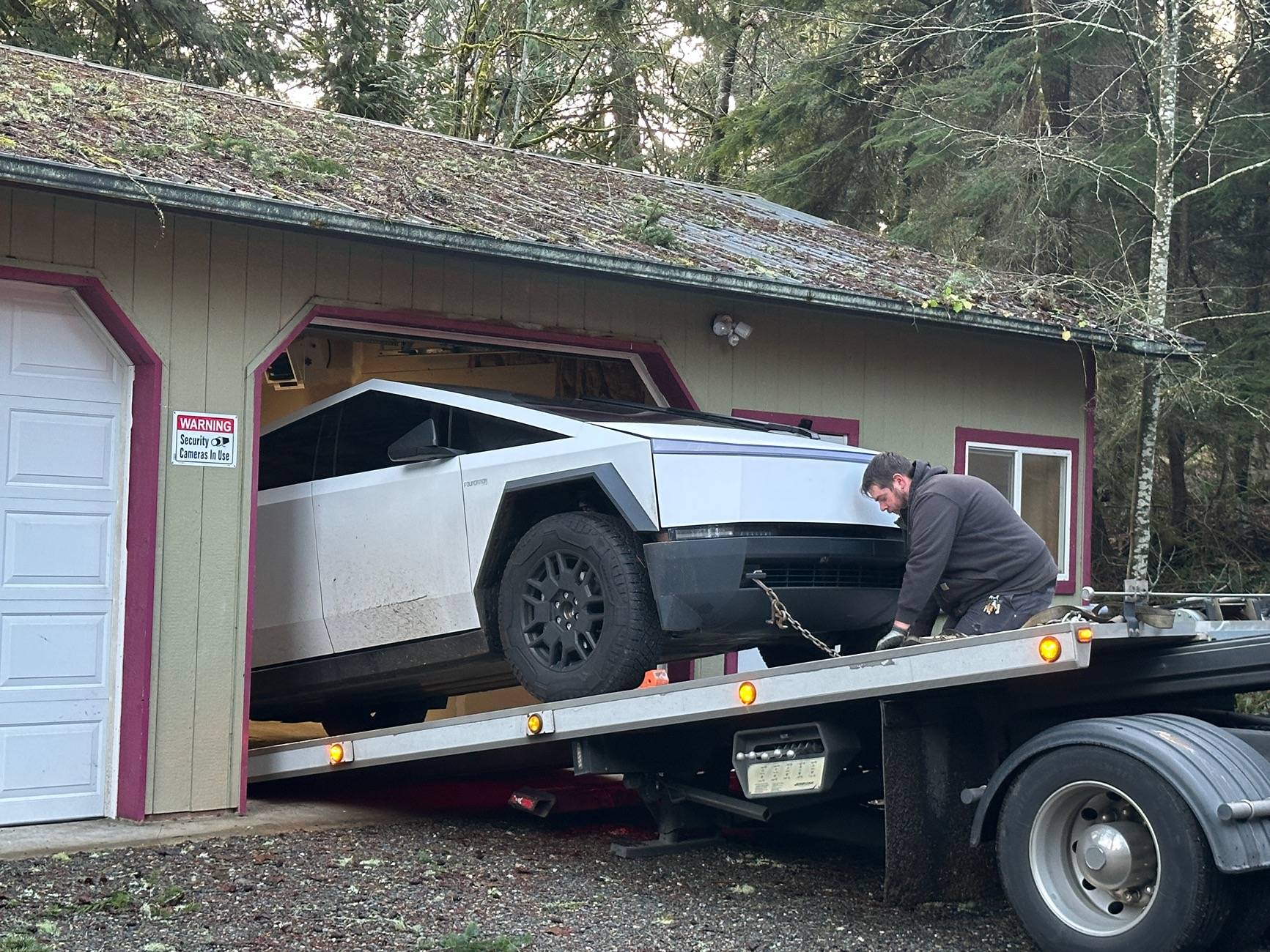

Update: no beuno. It’s dead dead. Although they tried to jump it, they can hear electricity circulating but not enough to power anything else. So it’ll get towed today and looked into Thursday.

On my other post, I ended up disconnecting my wall charger from the wall. So my wall charger is taped on the tonneau while attached to the truck. It got delivered to the SC and won’t hear back until Thursday. Merry Christmas
